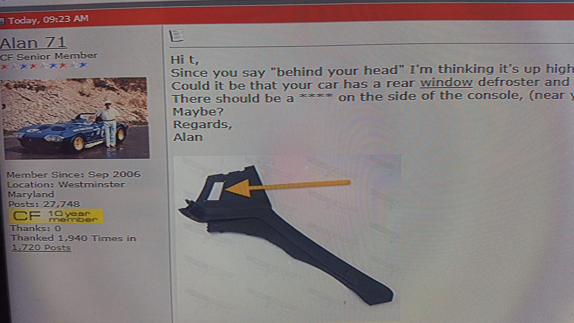

Hi t,
Since you say "behind your head" I'm thinking it's up high on the side trim panel.
Could it be that your car has a rear window defroster and it's running all the time?
There should be a **** on the side of the console, (near your right calf), that turns it off.
Maybe?
Regards,
Alan

Only ***** are the sliders for temp/vent. This vent is on door pillar just behind drivers and passengers heads. It could be a side window defroster.

the vent location is where your pic shows it. There has been a lot of wiring work done and stuff 'hidden' by removal and re-installation of console and dash. That switch probably should be there, not sure exactly where it should be originally. I'd bet its jammed under the dash or console.
