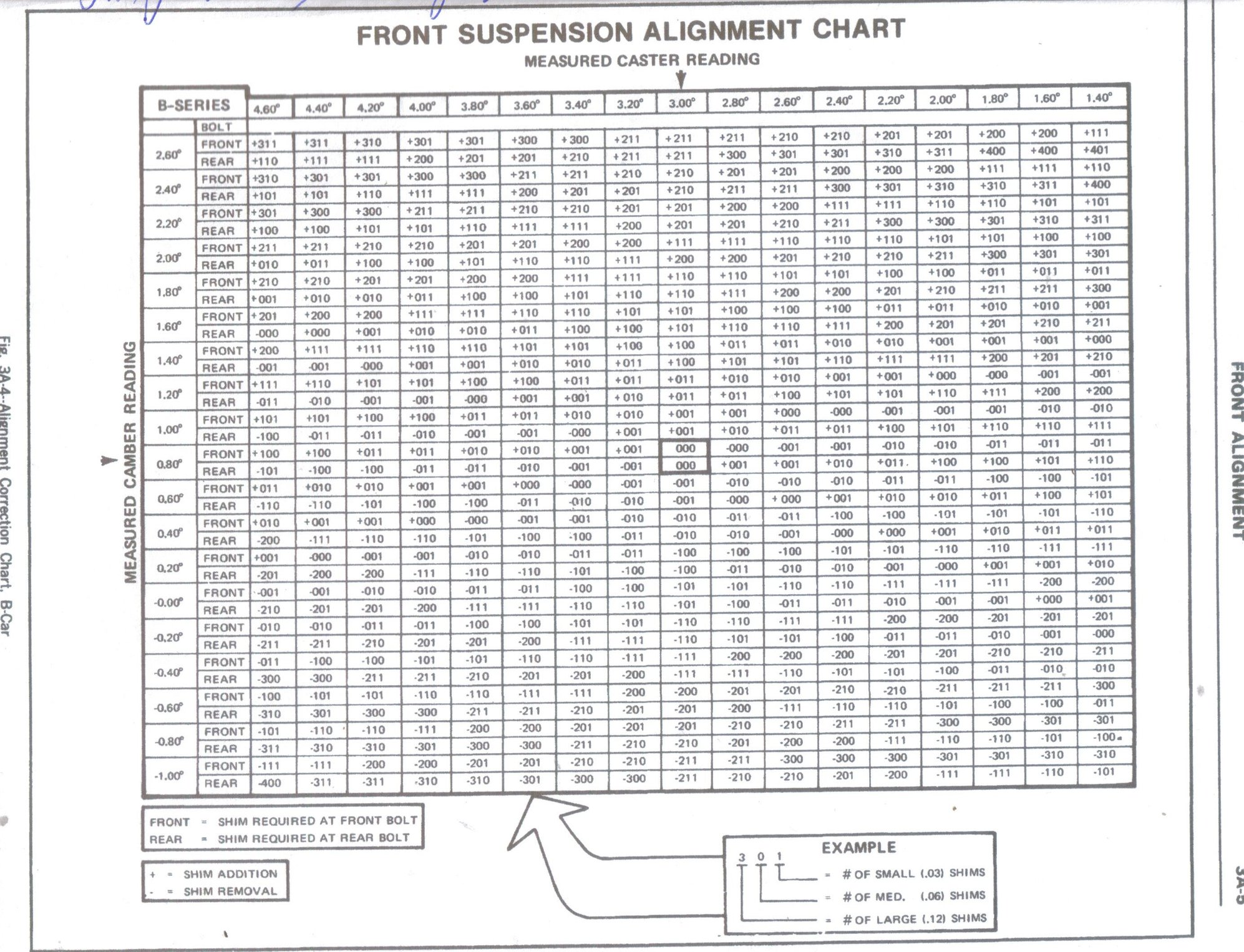

Hello my name is Jürgen ,and I come from Germany. I search a Correction Chart for 1976 Corvette ,in the GM-Sevice Manual is only A,B,F and X Series Thx Jürgen´

here is the alignment chart

Hello MelWff,thx for the charetr but I have this one.I need somthing like this

i have never seen a chart like that used to align a dual A arm front suspension on any GM car. You establish your caster angle first by adding and subtracting shims from the front and rear bolts and then establish your camber angle by adding or subtracting the same thickness shims front both the front and rear bolts.
