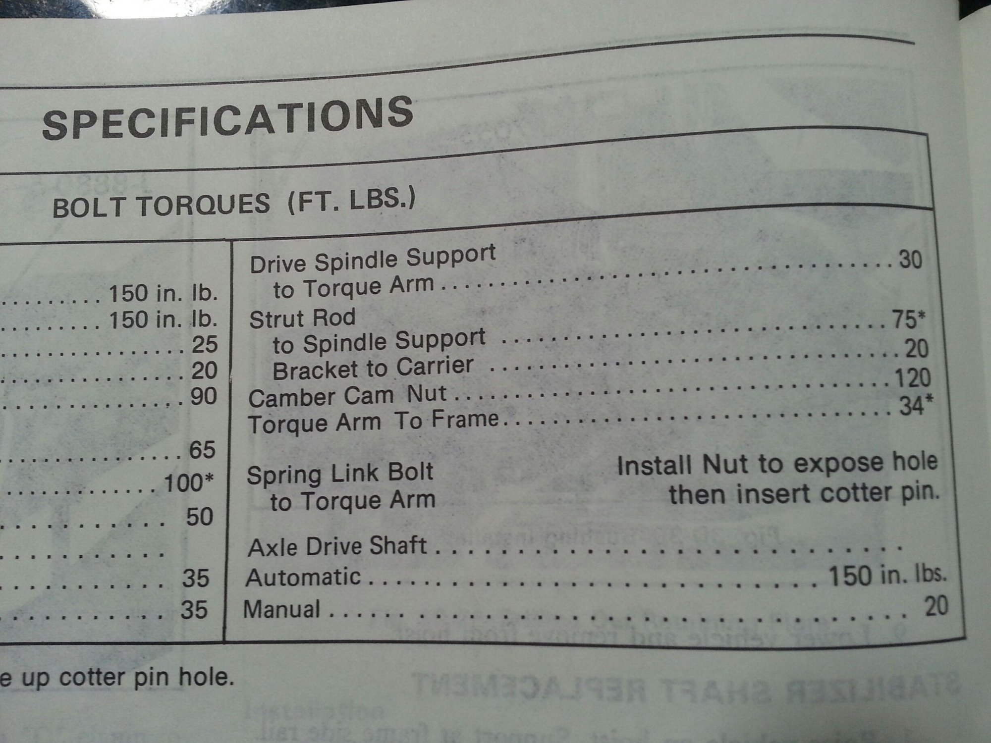

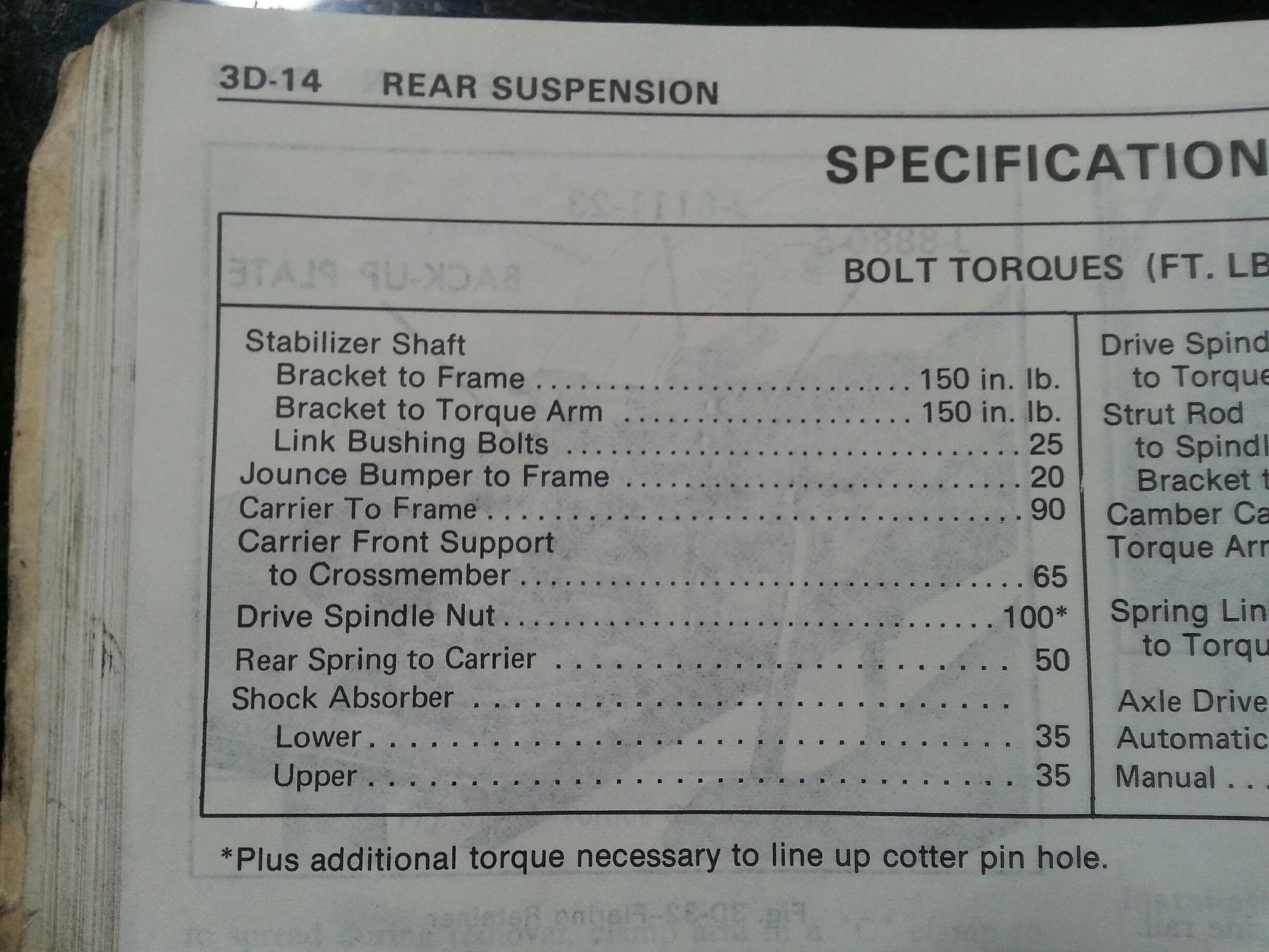

Originally Posted by Burnt71
Can Someone help ? I can't find the torq specs for the rams horn mounting to the frame ?
If your referring to the wing bracket to the frame, that would be 90ftlb
1980 manual specs
Other side of the page.
What Manuel is that ?
Sorry, I thought I put that in there. It's my 1980 manual. Mine is a 4 speed with a 383.
Actually, I did. Bottom of first image.
