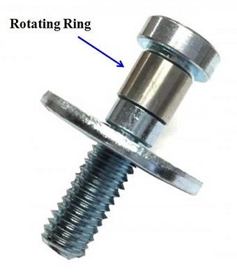

I have seen some of the door striker pins with a plastic/teflon sleeve on them, but most I've seen have a metal sleeve on them like this picture;
Many of these pins will also have more than one washer on them to adjust the striker in and out to better interface with the door latch.
There is a company that manufactures them in Stainless Steel and will machine them in just about any length if you are currently using more than one washer. (The SS pins do not have a metal or plastic sleeve they are machined to work without them.) All you need to do is tell them how many washers you're currently using and they will machine the striker to length so it requires only the one washer.
Good luck... GUSTO
