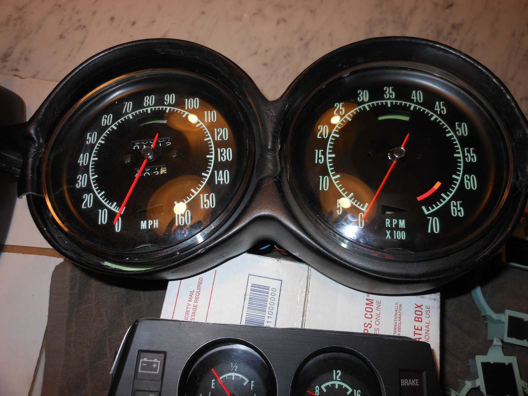

Maybe it's just me- but I think the original gauges (pre 77) just look at home in the C3- and the newer gauges just don't have that look.
I did a "newer" engine swap and just had the gauges converted by Corvette Instrument Service in Florida. No need for any "adapters."
He did the tach- speedo - volt- and even a oil temp gauge to replace the clock- important if you are running a Dry sump.
Even doing a custom dash- would have been easier to go w/ new gauges - but the originals just look too good.
Dakota-
Originals redone-
To LT1 to 1968 guages
