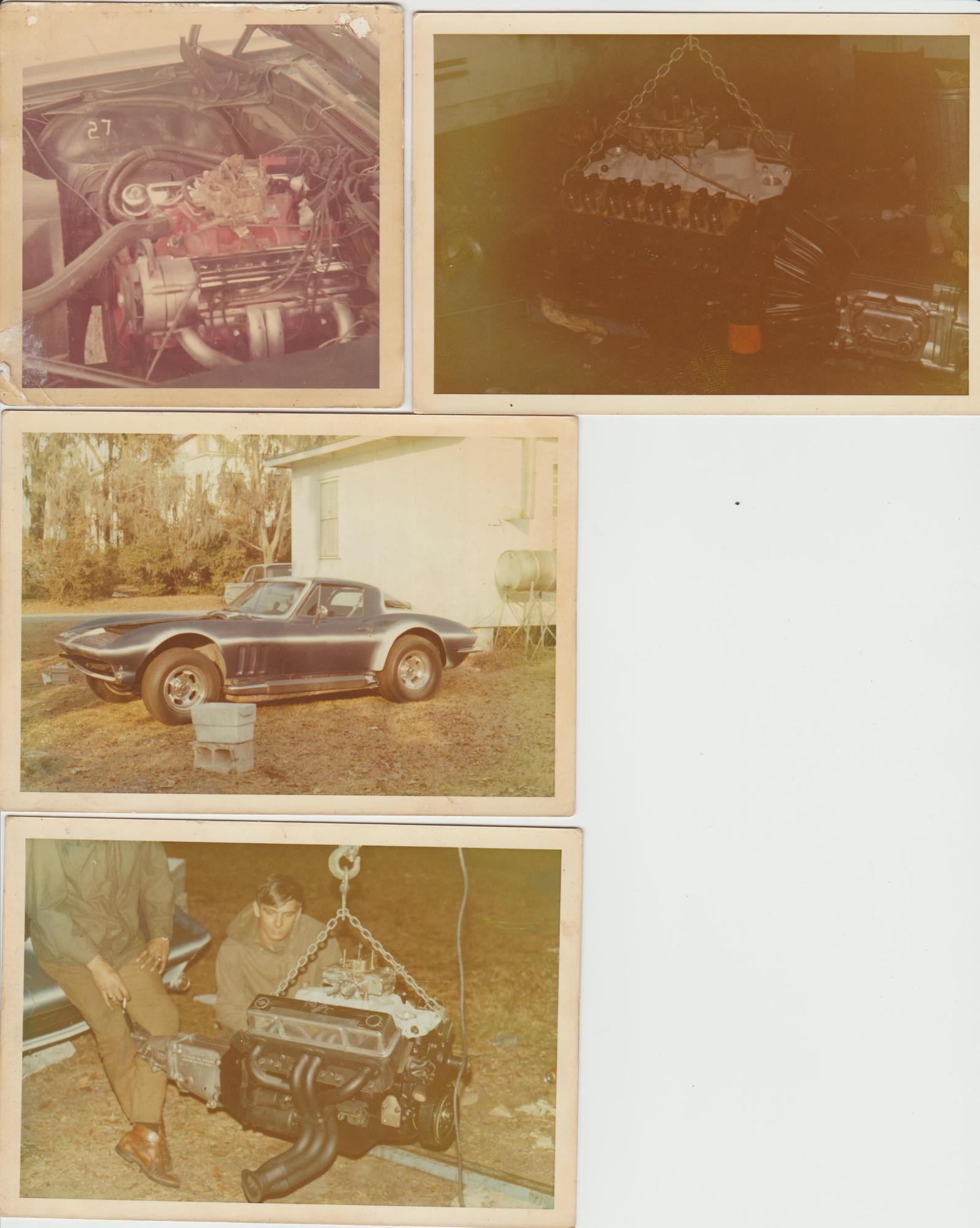

I found a couple of pix of engines I worked on back then. In the top left, the black hose coming out of the front center of the Quadrajet carb is going to the PCV Valve in the right rear valve cover grommet.
In the bottom picture the PCV grommet in the front of the right valve cover is hard to see and its PCV valve and hose is not yet installed, it connected to a tube in the base of the Holley, either center rear or on the right rear side of the Holley baseplate. Its intake hose went from the air cleaner to the left valve cover.
I have another picture that I can't find, of my 402 cu in big block that had the PCV in the left valve cover and its intake was a chrome breather in the rear of the right valve cover. I''ll post it later when I find it.
The man sitting behind the engine is a chopper pilot who flew flat out with his hair on fire every where we went. He drove his Vette pretty hard too. He was one of the best pilots I ever flew with. I can remember the inside of every engine I ever worked on except this one. It is possible that he had the engine built at a performance machine shop in Savannah and I did the r&r and tear down on it. The blue Vette he owned had full race suspension with oil coolers, and though I never raced him I rode in it.
I can tell you it went like a bat out of hell and cornered better than any Vette I ever rode in at that time. I'm pretty sure it had a roll cage with aircraft seat belts also. I believe it was a solid cam 327 with more than 350 hp stock. It had a Crane street grind cam and valve gear plus the truck load of speed parts he bought for it. The block was balanced, decked, line bored and I remember matching the intake ports to the manifold.

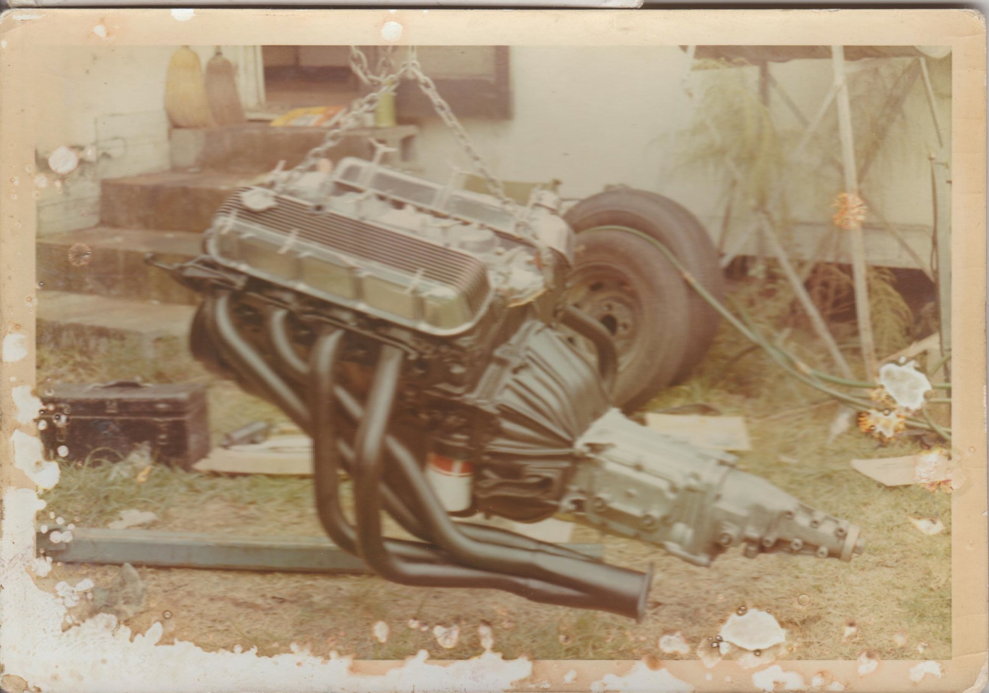

I found the picture of my 402 big block. You can see the PCV grommet in the left valve cover and the chrome breather on the right valve cover. The engine came out of a 70 Chevy Nova. I had the crank, rods, and pistons balanced. I matched intake ports and a 5 angle valve job with Crane triple springs and retainers. Crane pushrods finished the valve gear and a lightweight aluminum flywheel allowed the engine to rev very quickly. I had to mix Pontiac starter armature and coils with chevy nose cases to start it using a big truck battery for the amps. The stock Chevy starters burned up trying to turn it over. Ignition was a Vette transister amp and distributor out of a salvage yard. It could smoke the tires at any speed in any gear.
