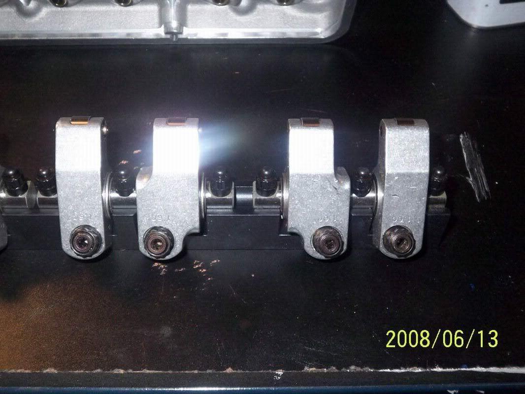

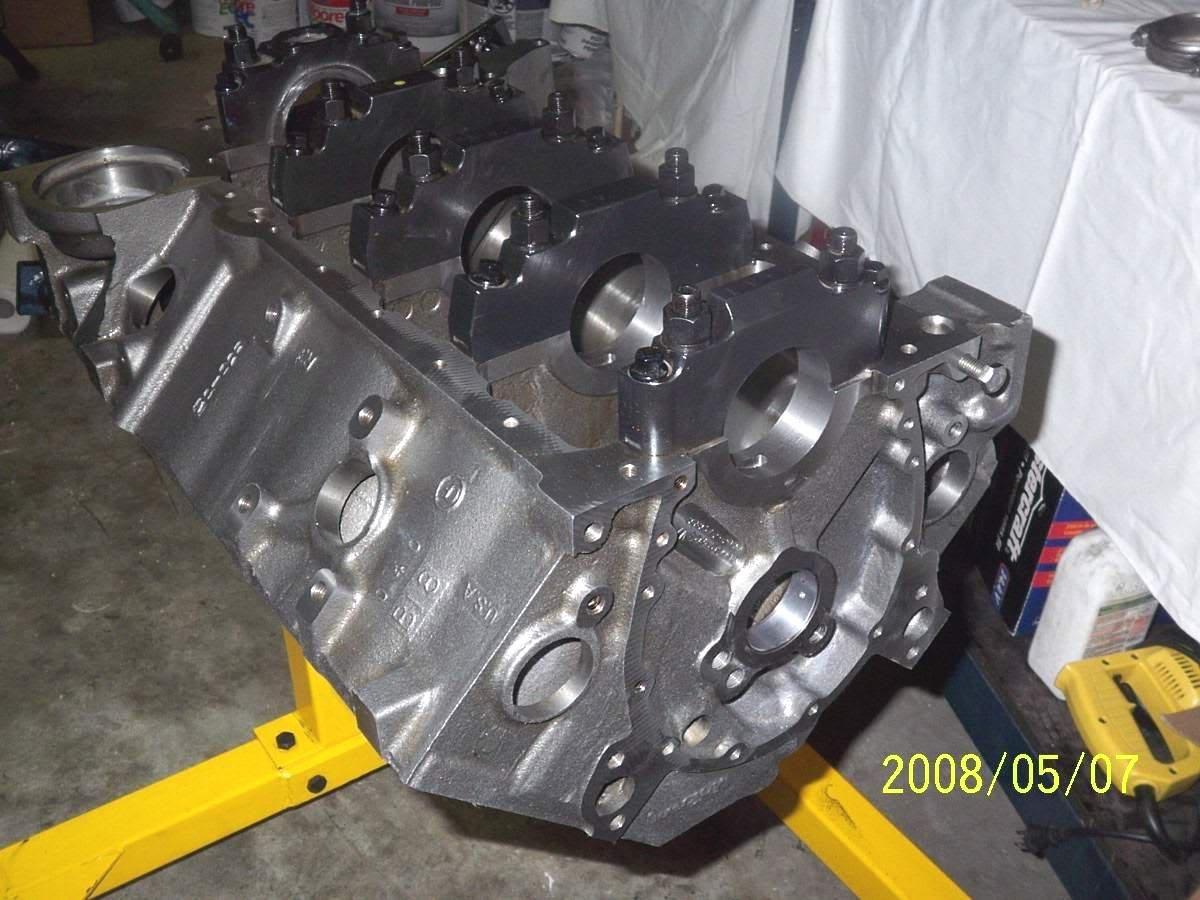

You are building a 427ci small block with a 4 in. crank. Not sure if anything has changed but when I built my 427ci the World Products Motown block was the only non exotic block that would handle a 4 in. crank with no clearancing.
The block comes with all five mains being 4 bolt with the inner three splayed. I paid extra to have the billet steel caps. It is pretty much bullet roof.
I went with AFR 227ci heads port matched to a Vic Jr intake, I would not use conventional valve train as the 60/40 split will put the intake rocker on a bad angle. It can be done but is no recommended.
Next mall base circle cam will need to be used along with "stroker" rods which are clearanced on the shoulder closest to the cam. You can see this in the rod below, the bottom shoulder has been milled down.
Another pic of the T&D Shaft rockers showing the intake valve rocker is moved over, in my opinion a conventional rocker would be on a unacceptable angle.
So in closing, the more power you make then both HP and Torque go up making the ol wive's tale of increasing torque and reducing HP with smaller heads not hold water. Take a look at the Engine Masters video on Ytube which they did a test on this.
My CR is 10.6 to one with a 248/254 dur. cam with .670 lift allowing the engine to make over 600HP. And yeas I can tool around town at 2000RPM and the engine runs smooth and does not overheat.

How does a Dart SHP 400 match up to a Motown?
Txs

I cant give you a complete comparision as I have no experience with the Motown, but here are the SHP block features:
* Priority main oiling system
* Siamese cylinder bores with extra-thick walls
* Extra thick decks to ensure reliable head gasket seal
* Blind head bolt holes (don't go through water jacket)
* Scalloped water jacket walls for improved flow around cylinders for better cooling
* Clearance for 3.75 in. stroke with steel rods
* Splayed outer bolts on middle main bearing caps
* Provisions for OE stock roller lifters and cams
* All OE bolt holes starter, clutch ball, etc.
* Uses 1981 to 1985 stock style oil pan and passenger side dipstick
* Uses stocked stamped steel timing cover
From my own mild build,I can also add:
* Minor clearancing was needed for a 4" stroke
* I am able to use standard base circle cam with a 4" stroke (I have to call out that I am using forged crank and H-beam rods from Ohio Crankshaft; these are probably designed to allow standard cam, so not sure if that still holds true for all other crank/rods on the market).
Hope that helps.

Txs Jim.
I can read specs from the mfg but real experience from a user of one helps a lot.
Dennis
