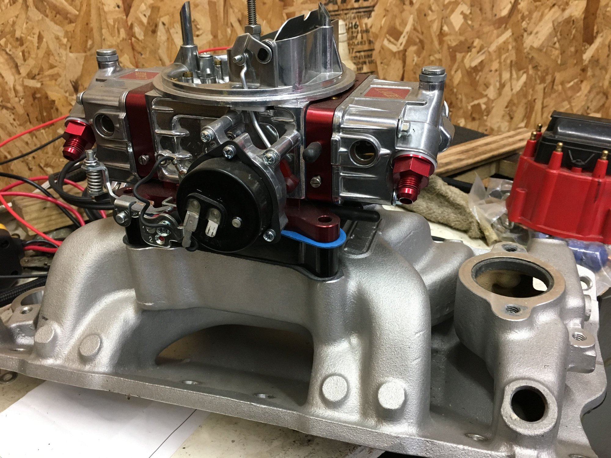

I think you made a good choice. I didn't port match mine to the AFR 195's. 357 rwhp on a Mustang dyno.

Right on sounds great Les, good choice going with Jim his work is top notch, his machinist one of the best.
Thanks- and yessir, Jim is top notch in all regards. And the machine shop balanced the rotating assembly to within .5 grams.
Originally Posted by stingraymaniac
That sounds awesome, the first start is always abit nervous, but that sounds very healthy
Thanks. So true about the first fire up. You don't want to wash the cylinders down with fuel while trying to get it to light off. I went to great lengths to get the rotor lined up as well as possible to the cap and it paid off. Lit as soon as I gave it a light pump of the throttle.
The size of the ports on the Team G were almost a perfect match for the heads and that's why I got the Team G. Well, that and the dyno tests were really good with it on other small blocks. I've told you this before- you have a very pissed off 355.

we have everything the same ~ other than my crane cam is the solid roller version of 236/242 which some people equate as being the same as an lessor rated H-roller duration.
I have the older AFR 210 with the bigger diameter stems with Manley 2.08/1.60 Raceflow valves My port polished CNC heas are some where in the 308 CFM over .600 through .700
I tried up to 1 1/2 open spacers and didn't find anything that you could feel even out to 7500 rpm.
My advice is to buy a 1/2 inch 4 hole wood spacer for better signal and the thermal block from some place like Summit Racing
I looked at a LOT of manifolds for my Dart 200 head 10.5 to 1 406.....but went back to a Team G as it is a short unit that works. I rounded off all of the casting bumps on the runner entrances and port matched. I used a 1/2" wood open spacer and a modified HP750 that flows about 780 or so......it runs VERY hard.
BTW.....I will probably put a Dart Single plane on it when more funds are available......that manifold flat out works. The Super Victor needs a butt load of poerting around the carb entrance and just staring at it I wonder why Edelbrock did that....the Wilson ported Super Victor removes ALL of that and is 30 horse beter on a 600 horse engine.
I never bother with the Victor Jr. anymore because it needs WAY too much work to port match.....not only only for size, but one also has two go damn near two inches up the runner.
It is a shame about the Titon intakes......but looking at one scares me because of the plastic water crossover......Ford did that years ago with the 4.6 and almost all of them crack.....the Dorman replacement has an aluminum crossover......
AFR should mold the intake in a silver after they fix it because to me the black looks all wrong......think FAST LS intake.....

This would be a good combo. Quick Fuel SS750, Dart intake.
Came off my 64. Will be posting for sale on forum.

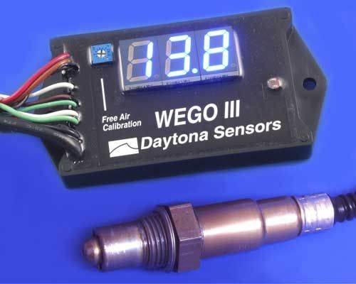

I've been using the Daytona Twin Tec Wego III for a few years. It's a bit more expensive than the LM1, but is compact, has data logging, 5 volt inputs to take data from other sensors such as throttle position or map sensors, and can be programed to display either lambda or afr. There's a dual channel also. Mine's a single. They gave it to me before they were making the dual channel.
Mike
That looks like a nice set up. Did they actually give it to you? If so, there must be a pretty good story behind it.
Yes they gave it me as well as some other things. I was performance division manager for Kuryakyn for 12 years. I marketed Daytona Twin Tec's products for them. Most of the performance products I designed or we designed as a team. I brought on some products from other companies though. They were usually thankful and would give me gifts such as the Wego III and their DTT aftermarket ECM for my Harley.

v2 whats youre personal opinion using one to fine tune than without?
Old May 3, 2018 | 02:13 PM
  #57
v2racing's Avatar
v2racing
Joined: Mar 2008
Posts: 2,666
Likes: 289
From: Spring Park MN
You know I tuned a lot of carbs on the street and the track before the wide bands were ever available to the public. I always had good results, but after I started using a wide band on the street and on the dyno, there is no comparison, especially in the part throttle and cruise areas.
WOT is the easiest to tune and I don't know that having a wide band would have helped with the racing, as I always tuned for best trap speed and set lots of records that way, but for the street I would never tune one again without a wide band.
Fuel injection is nearly impossible to tune properly without a wide band.
