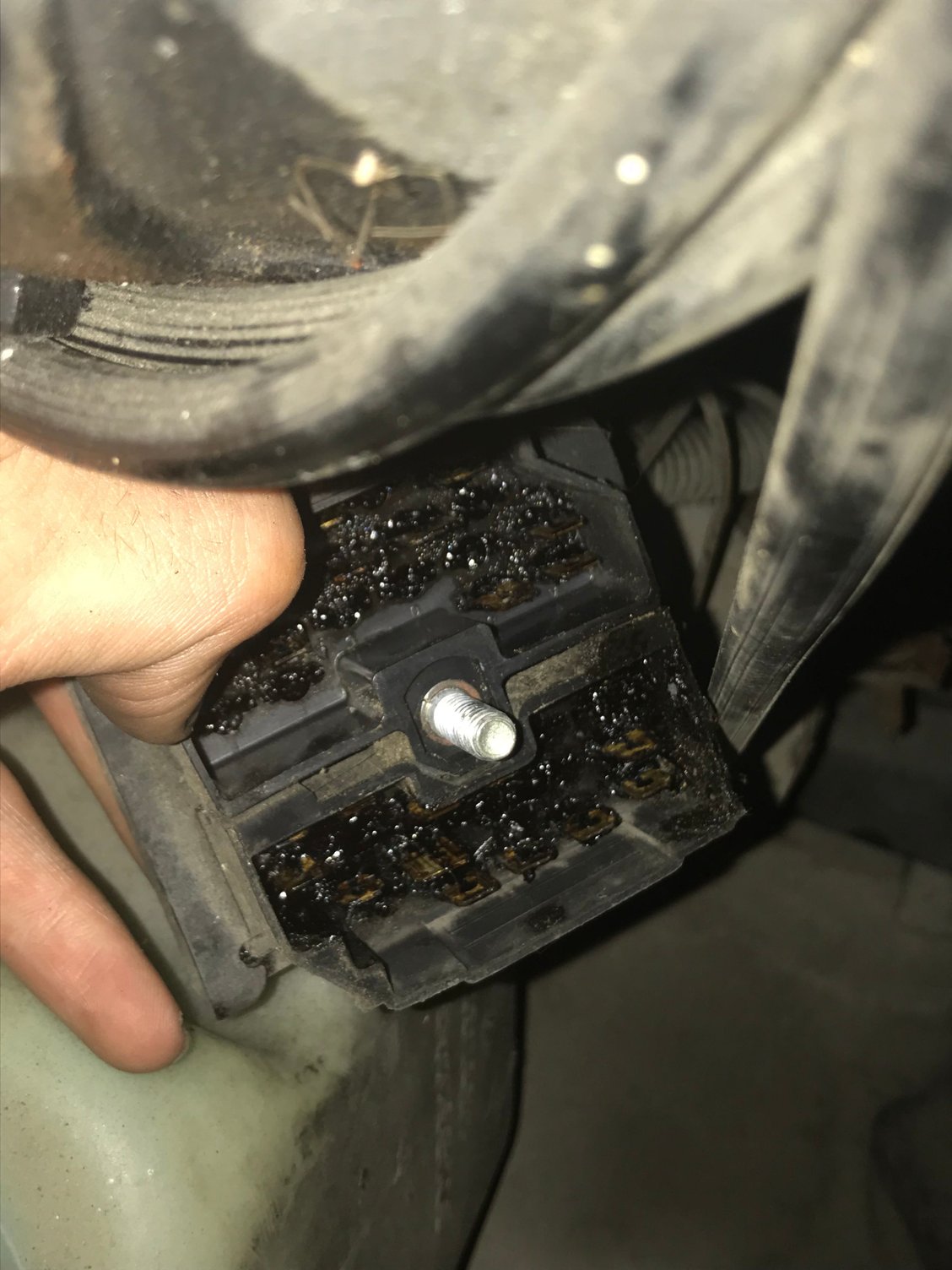

So for the past couple days I’ve been trying to find out what had been wrong with my head lights they go up fine (I know that the lights going up and lighting up don’t have any correlation) but none of the lights actually work, I thought it was a fuse or something but I don’t think it is anymore. I was looking for a bad ground or something along those lines and I was filling the harness all the way to the fire wall and unscrewed the harness from the fuse box on the fire wall from the outside and all the plugs were covered in some type of liquid, I don’t know if that’s a special grease or something used to help connections but I was wondering if someone could answer that for me?

Not 100% on what it is, I believe it's for water proofing.
I don't believe it will be causing the problem with your lights.

Do you have any ideas what is?

Could be di-electric grease.
Is used typically to prevent water from infiltrating the electrical connection, and can be used in connectors and bulb/sockets.
Not sure if that's what you've got in there.
It looks somewhat blackened, where the DE grease is clear-ish.
I'd suggest cleaning it off really well, hooking it back up and seeing if you get lights again.
You can always add a fresh gob of new DE grease after that, if you suspect it needs further protection from the elements.

Just clean it off the pins if you choose to do this. I do know that it's not Di-electric grease. It will be black like that on a brand new replacement harness as well.
I would say the problem is either the headlight switch or the dimmer switch. Do you have a floor mount or Colomn mount dimmer switch? At you dimmer switch you will have three wires (can't remember the colours). One will always be hot with the lights on, the other two will alternate depending on the position of the switch. If none of the wires are hot with the headlights on check your headlight switch.
