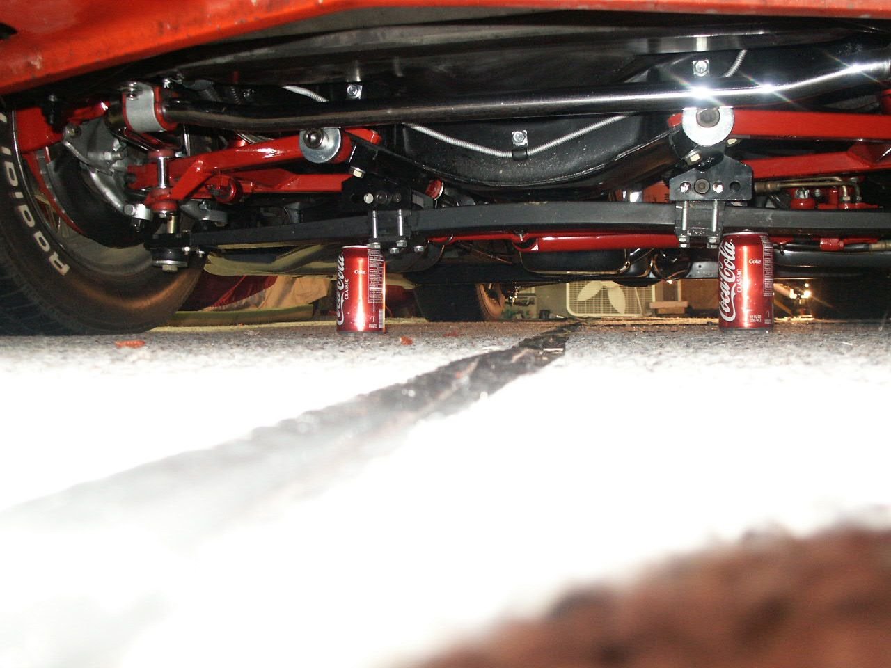

Here's a picture showing the ground clearance with the front mono spring. I've had the mono springs on my car for over 20 years and have never hit them on anything. The spring is right between the tires, so you would have to straddle something quite tall to hit it. You can see the spring and bolt just inboard of the front passenger tire.
I installed these long before the coil-over shock kits were available for our cars. I have my front spring on the 3rd stiffest setting and rear on the 2nd stiffest using 1" and 9/16" swaybars. Right now it tends to oversteer when pushed to the limit. Has a tight, but not overly harsh ride.

Good Pic of clearance
