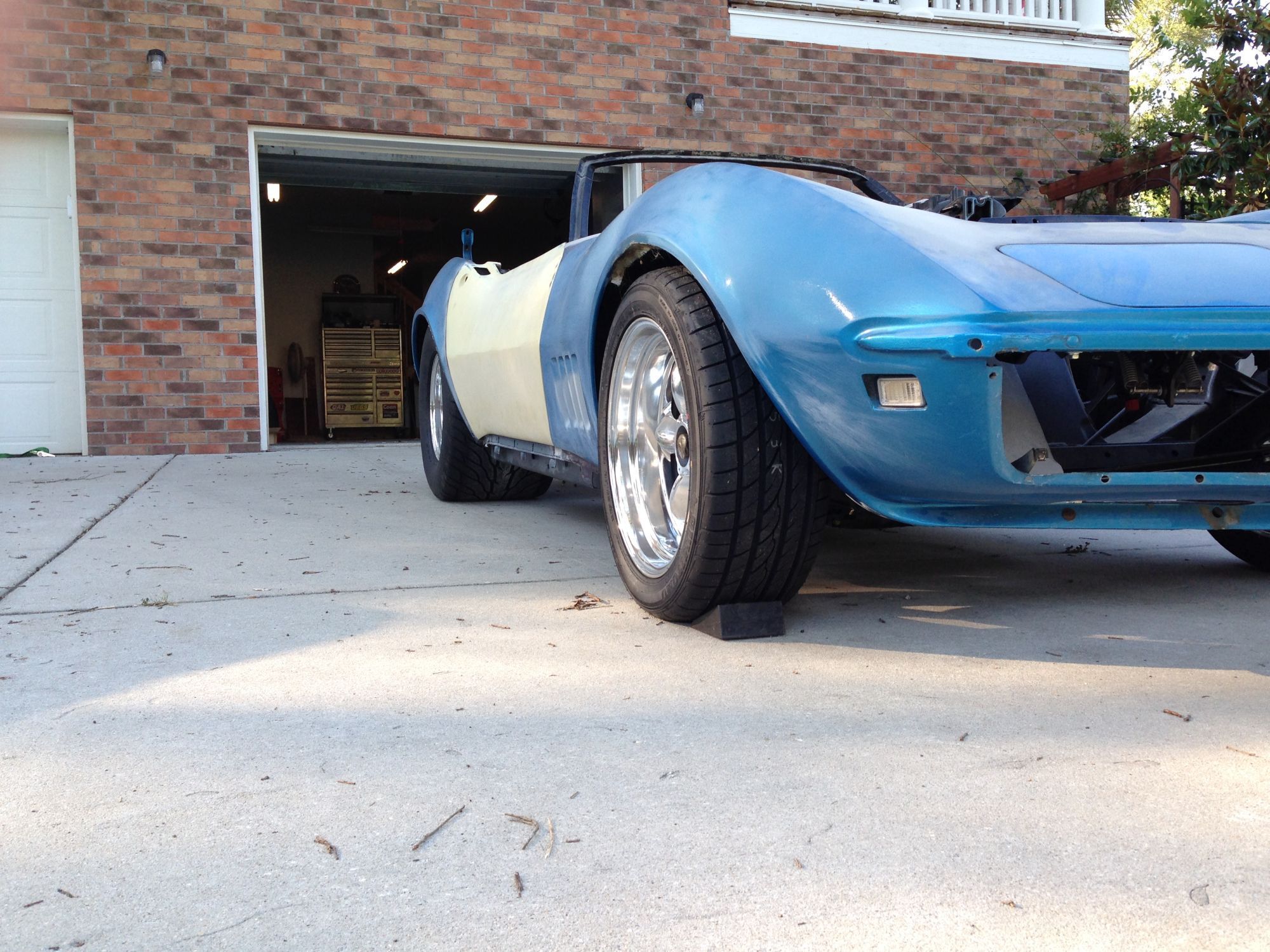

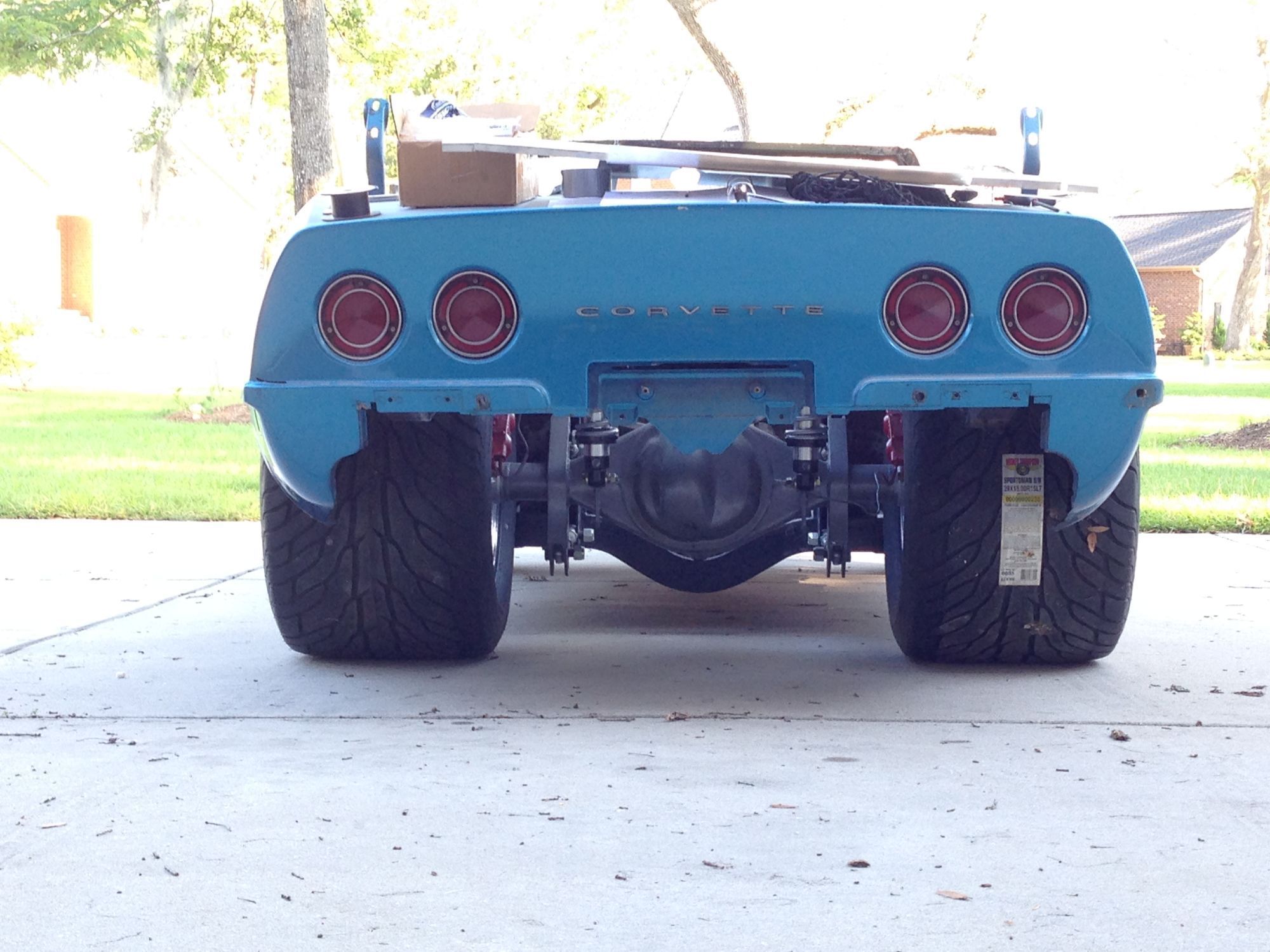

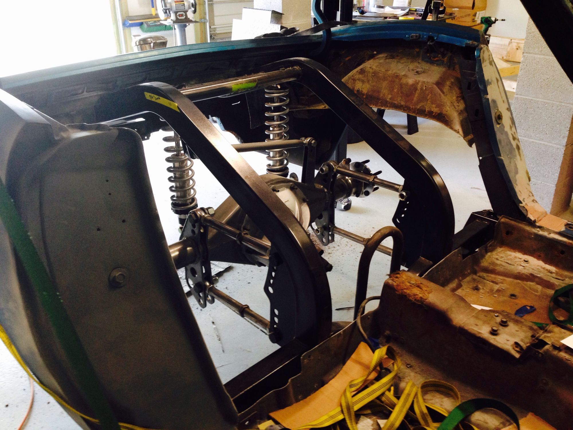

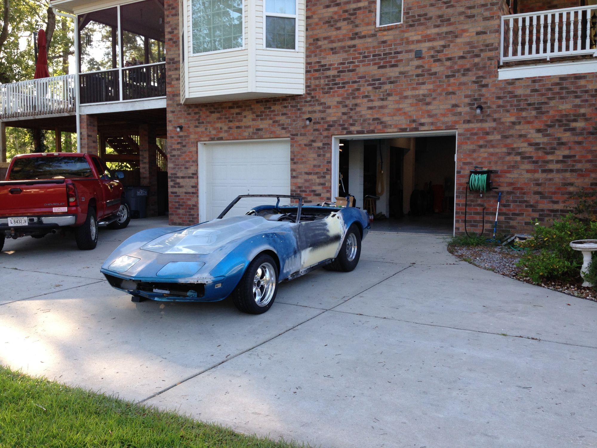

Someone recently updated their thread on the forum who was doing a frame off resto/mod on a 68 convertible that did a tubed 4-link.
They posted some awesome photographs.

I believe this is the link to the thread and a couple of photos from the nice work he did.
https://www.corvetteforum.com/forums...frame-off.html
