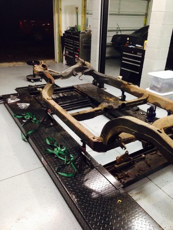

I spent most of Friday and today finishing unbolting everything from the frame, including lines, I now have a bare frame omit one bracket on the trans x-member and those two darn tire holder bolts (which don't want to come out -what a surprise! (Pun intended)-
I also spent some time moving a couple cars around and tucked the body in the back of the garage out of the way:
Frame:
I also spent an incredible amount of time taking off the a-frame apart thanks to those awesome rivet at the ball joints. The bushings were removed with a torch.
I started sandblasting one of them but my little 30 gal just can't keep up. Now I get to figure out which compressor upgrade I'm gonna need to do, since even my cutting wheel is using too much cfm for what my compressor can support.
I also figured out that I have a 3.08 gear in the pumpkin...haven't opened it, simply counted the turns. Was hoping for more gears so this will be addressed as well.
I still haven't figure out which direction to take but I need to make up my mind pronto, going to have the frame blasted in the next couple weeks or so.
