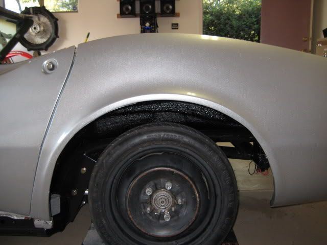

Those skins are insane. Dang!

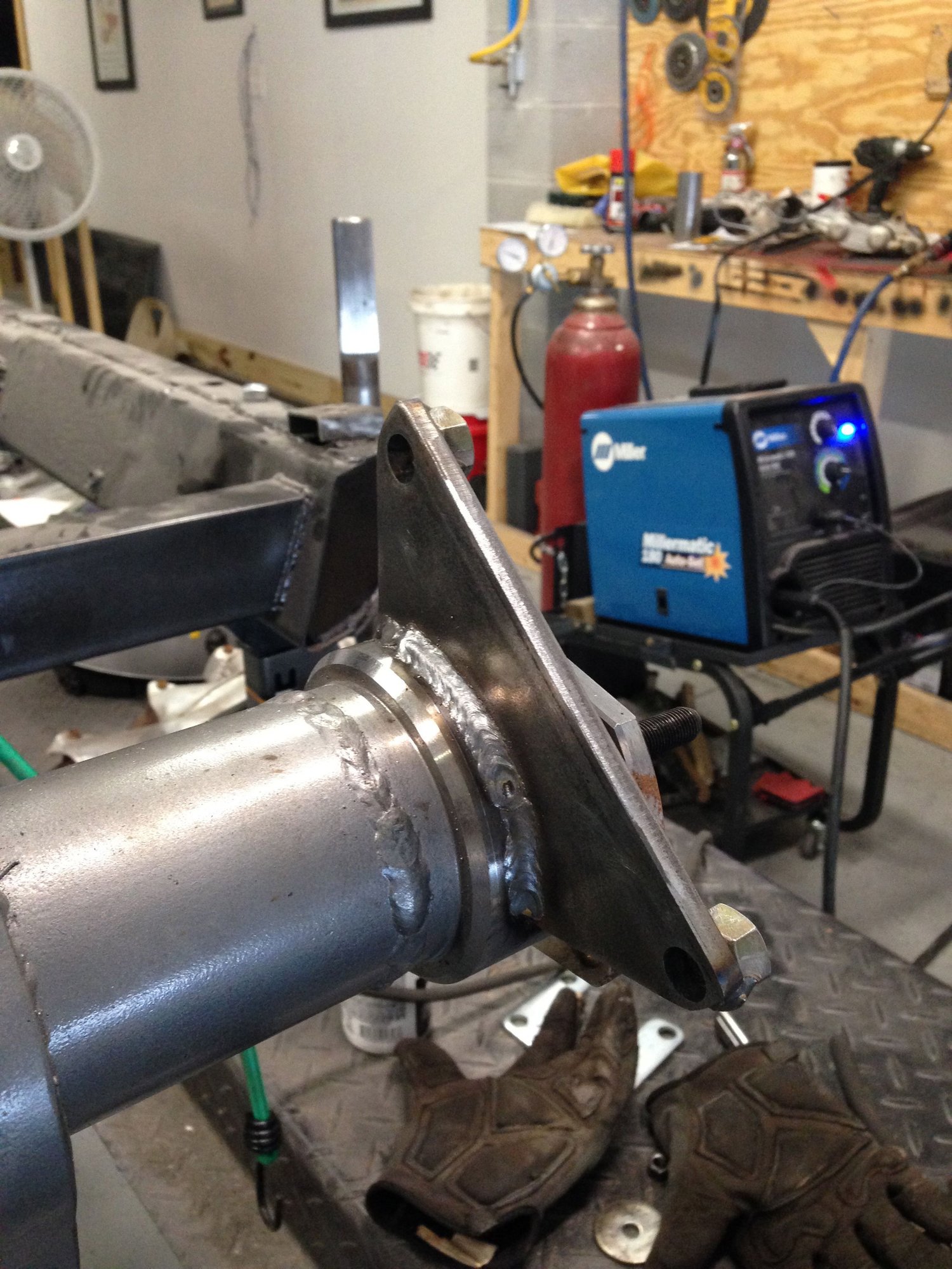

finished welding the rear end, mocking up the panhard bar

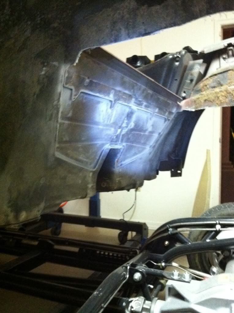

time for an update: other than painting the frame and getting axles for the housing, i decided to start on the body. There's a very good chance that i will be going down to the birdcage since the body mounts are a bit crusty:

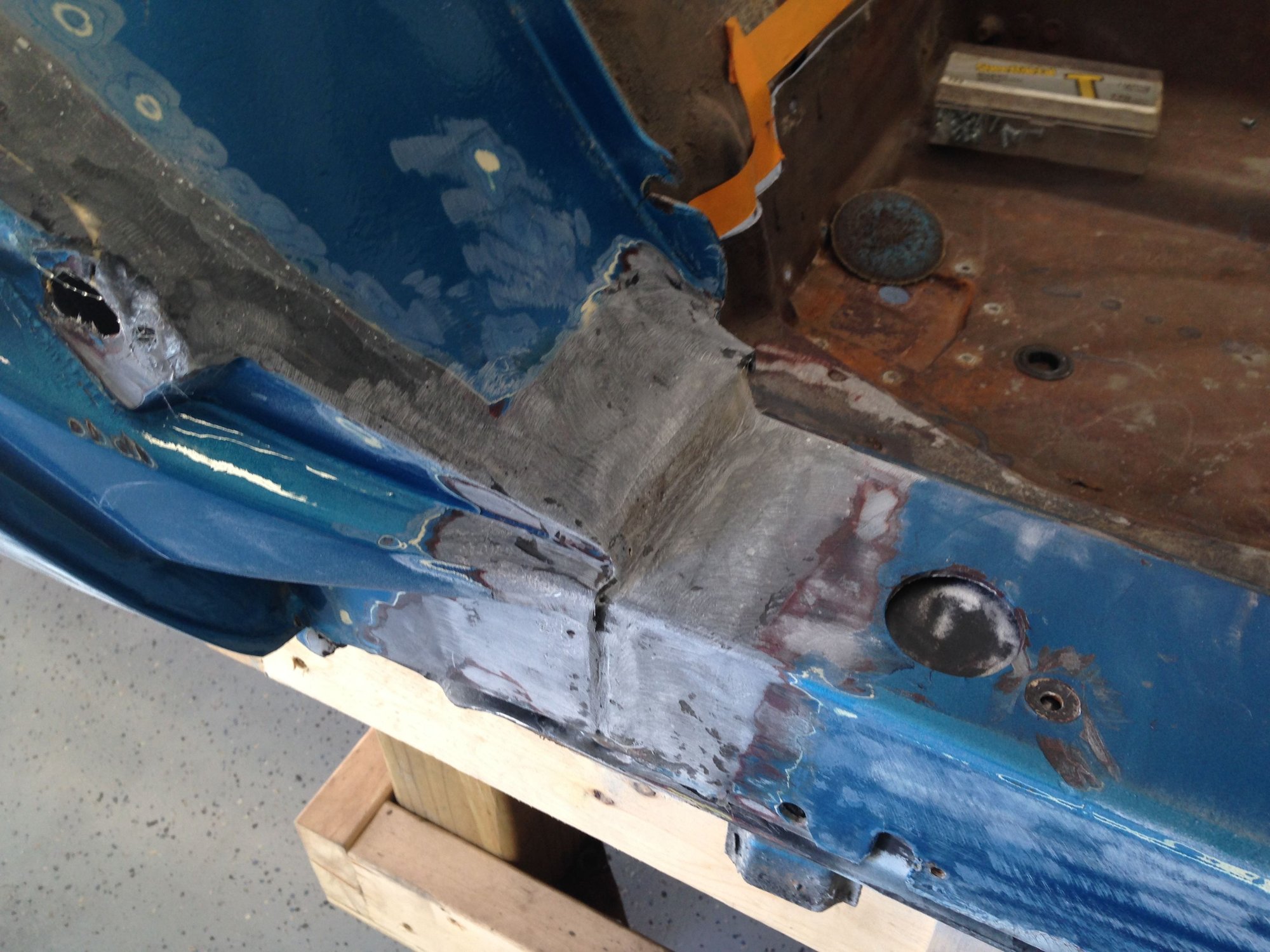

removed the rocker, the metal looks much better than anticipated
Since the back floor of the car will need to be cut out, I'm looking to find if there is a bonding strip that would be there, but thus far i think the floor is one piece from the firewall to the back... or is it?

Great project!! If you get into the birdcage take plenty of measurements. The floor from the firewall base to the back is pretty much one piece. I took plenty of pictures when I opened my birdcage up for rust repairs. Problem is lost most due to corrupt camera card, so write em' down and back up your pictures . Best of luck keep the updates coming.

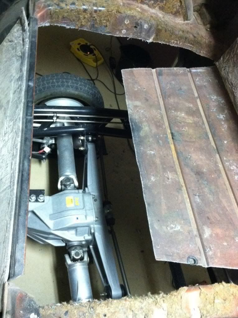

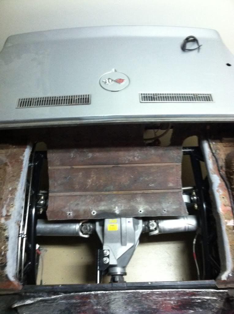

I certainly don't mean to intrude on this thread, but based on your last comment, I can sympathize with what must be running through your mind, and I thought these pics might help. I have more pics available, but I tried to include what would be most useful.
The 3 new panels you see going into the floor were supplied by SRIII, but you have to just figure out how best to cut and make things fit. You can see that I had the body hanging over the frame as a trial to fit things.
For reference and what you can barely see in the pics...the large flat fiberglass piece is fixed the an aluminum angle channel that is bolted and bonded to the rear of the 'cockpit' area. It is fixed at a height that allowed a flat floor area. I then bolted and bonded the existing floor panel to the new panel...then finally bonded in the side pieces. NOTE: the aluminum angle piece is only visible in the finished pics...you can barely make it out through the undercoating.
My thoughts are that it might be easiest for you to build a flat floor center section and then connect inside to outside for your inner fenders...hope that makes sense and I hope this can help.
You do amazing work! I'm stoked to see another '68 getting special treatments. Best of luck and if I can be of any assistance don't hesitate to send a PM or reply in the thread.
My apologies for any duplicate pics...
Rob

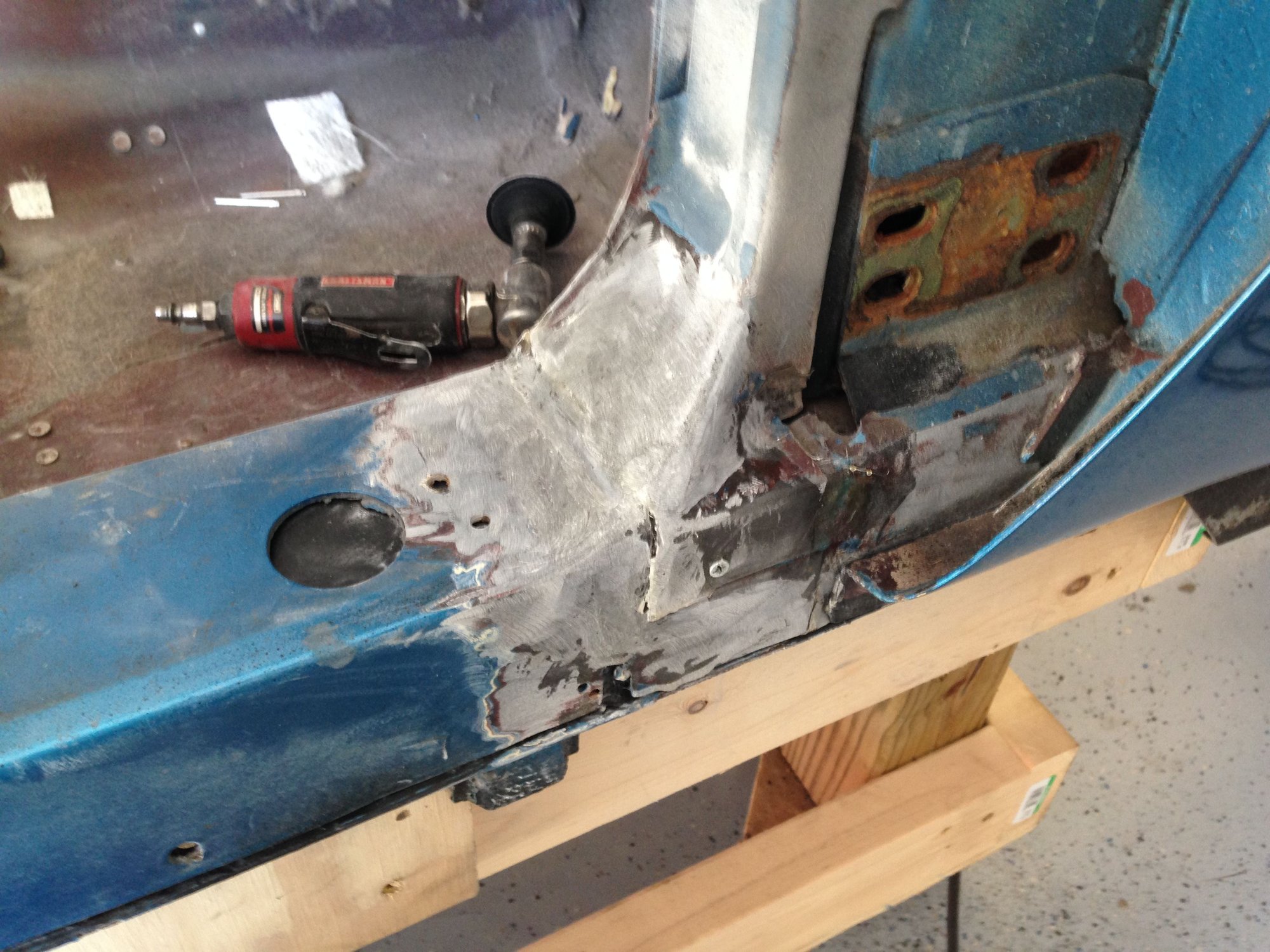

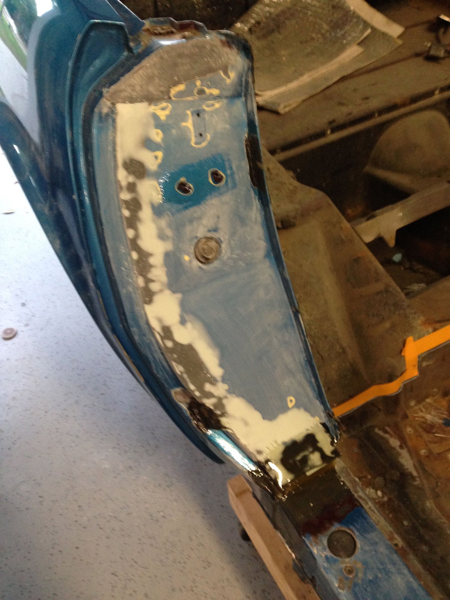

fiberglassing what I had cut off to remove the rear of the car...
fiberglassing that front piece back on at the front door jam, which bonds to the rocker panel…

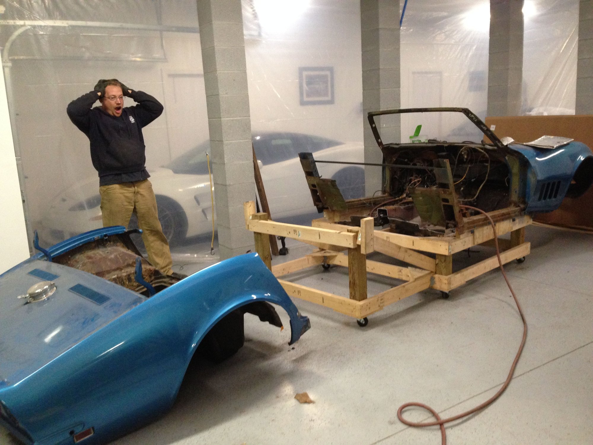

Oh yes, by "removing" the rear of the car, I quite literally mean exactly that:
"WTH the back fell off!!!!":
So really the pics are out of order, today I got to reglass all of that…well not all of it, since the back half of the car is getting its floor removed entirely so that the narrowed frame rails (24" wide) can fit in there…then gotta figure wheel tubs…but that's for later, I've decided I'd do most of the outside body work done first…I've attacked the front nose and the pesky raised rivets…didn't get far, about 13 rivets in…but yes now that the 'maro is gone, this projects is right back onto the hot burners...

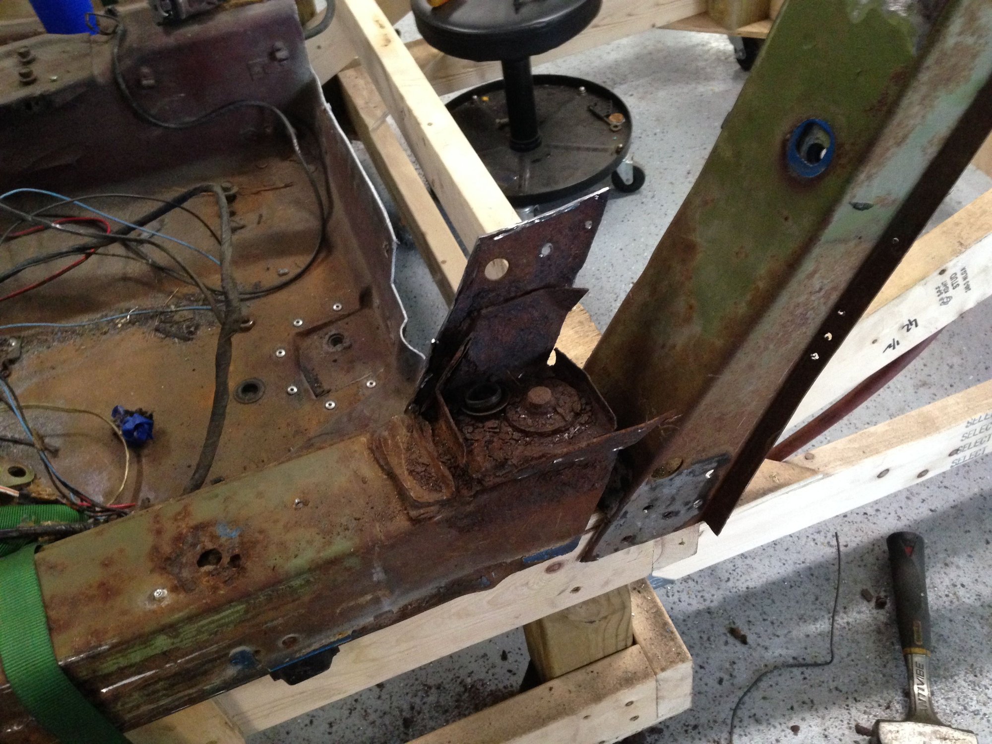

I spent most of Friday and today finishing unbolting everything from the frame, including lines, I now have a bare frame omit one bracket on the trans x-member and those two darn tire holder bolts (which don't want to come out -what a surprise! (Pun intended)-
I also spent some time moving a couple cars around and tucked the body in the back of the garage out of the way:
Frame:
I also spent an incredible amount of time taking off the a-frame apart thanks to those awesome rivet at the ball joints. The bushings were removed with a torch.
I started sandblasting one of them but my little 30 gal just can't keep up. Now I get to figure out which compressor upgrade I'm gonna need to do, since even my cutting wheel is using too much cfm for what my compressor can support.
I also figured out that I have a 3.08 gear in the pumpkin...haven't opened it, simply counted the turns. Was hoping for more gears so this will be addressed as well.
I still haven't figure out which direction to take but I need to make up my mind pronto, going to have the frame blasted in the next couple weeks or so.

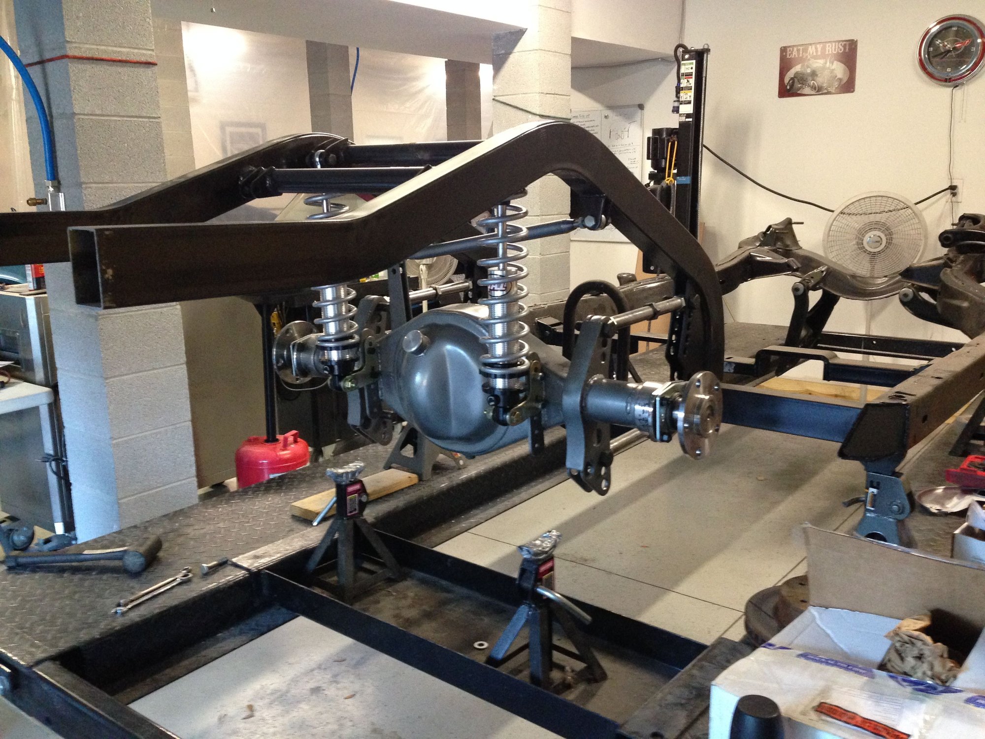

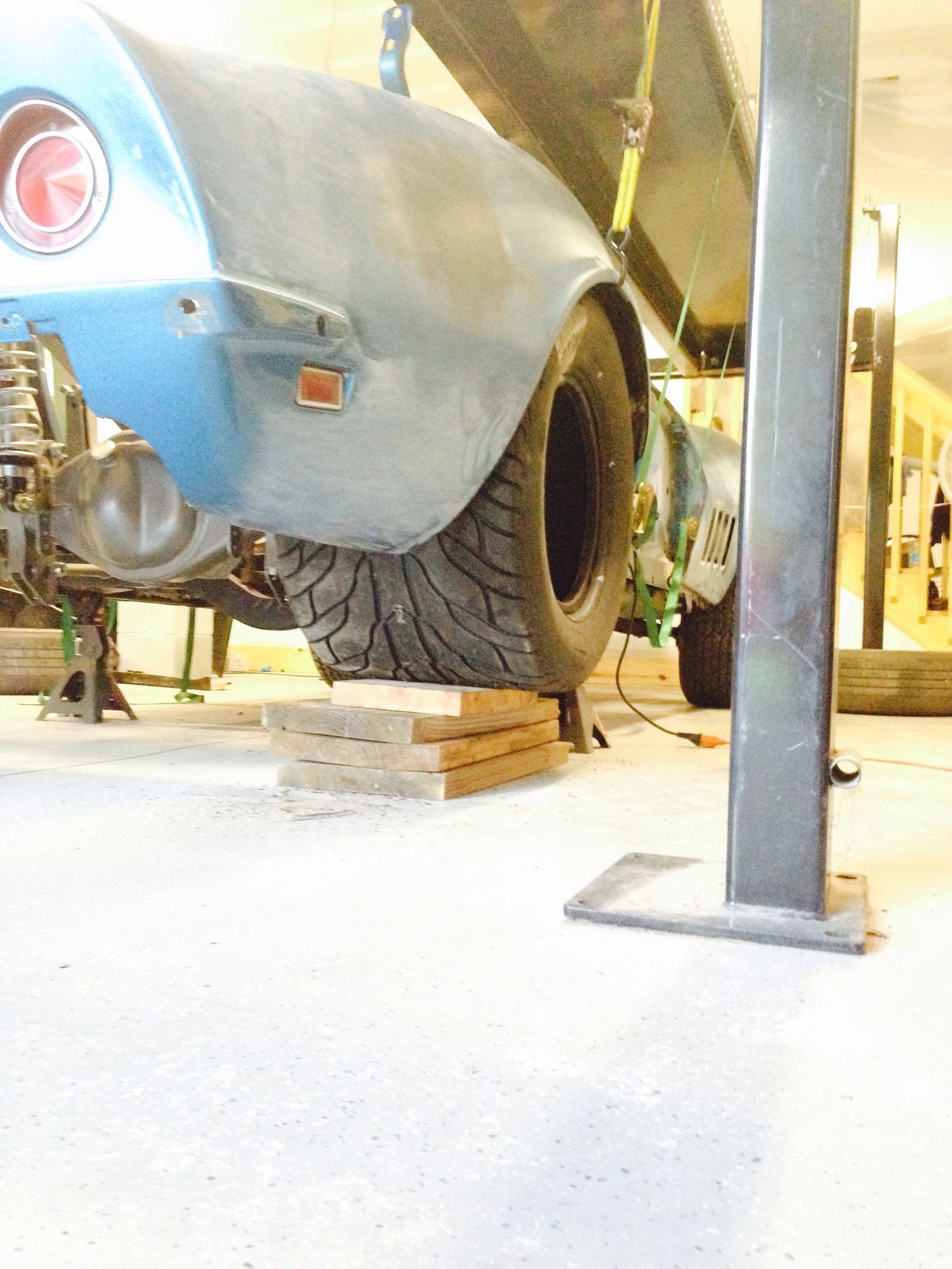

not a whole lot of progress, I ran out of parts, to "add" to it, but managed to get the front end together (suspension wise) and final mock up on the rear suspension….about to go back half the body….slowly….measure 8 time cut twice….lol

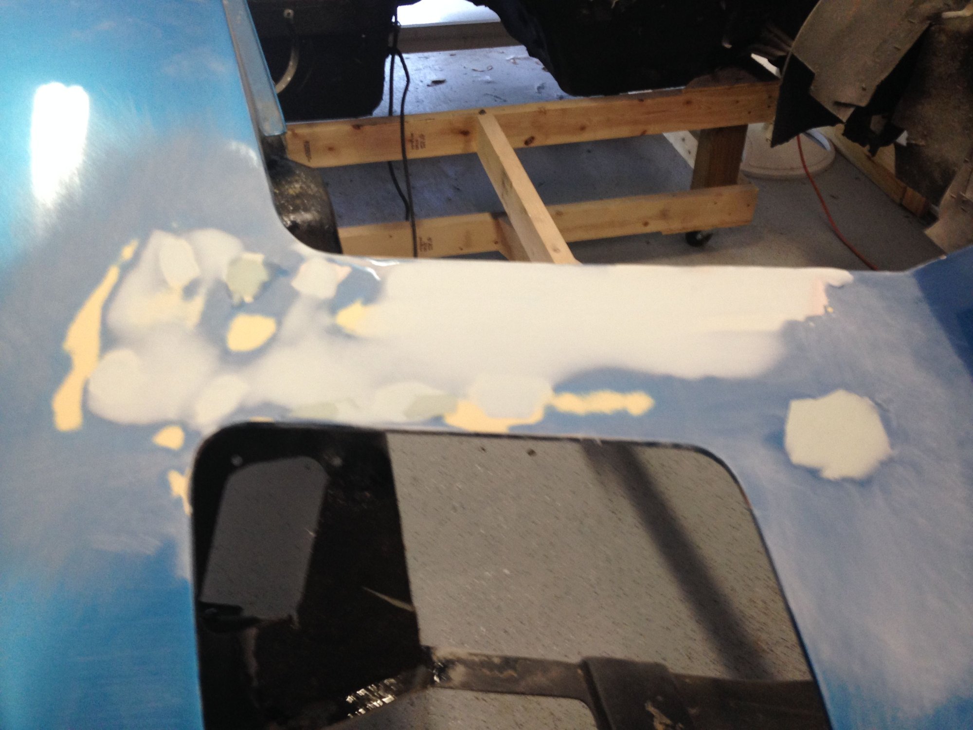

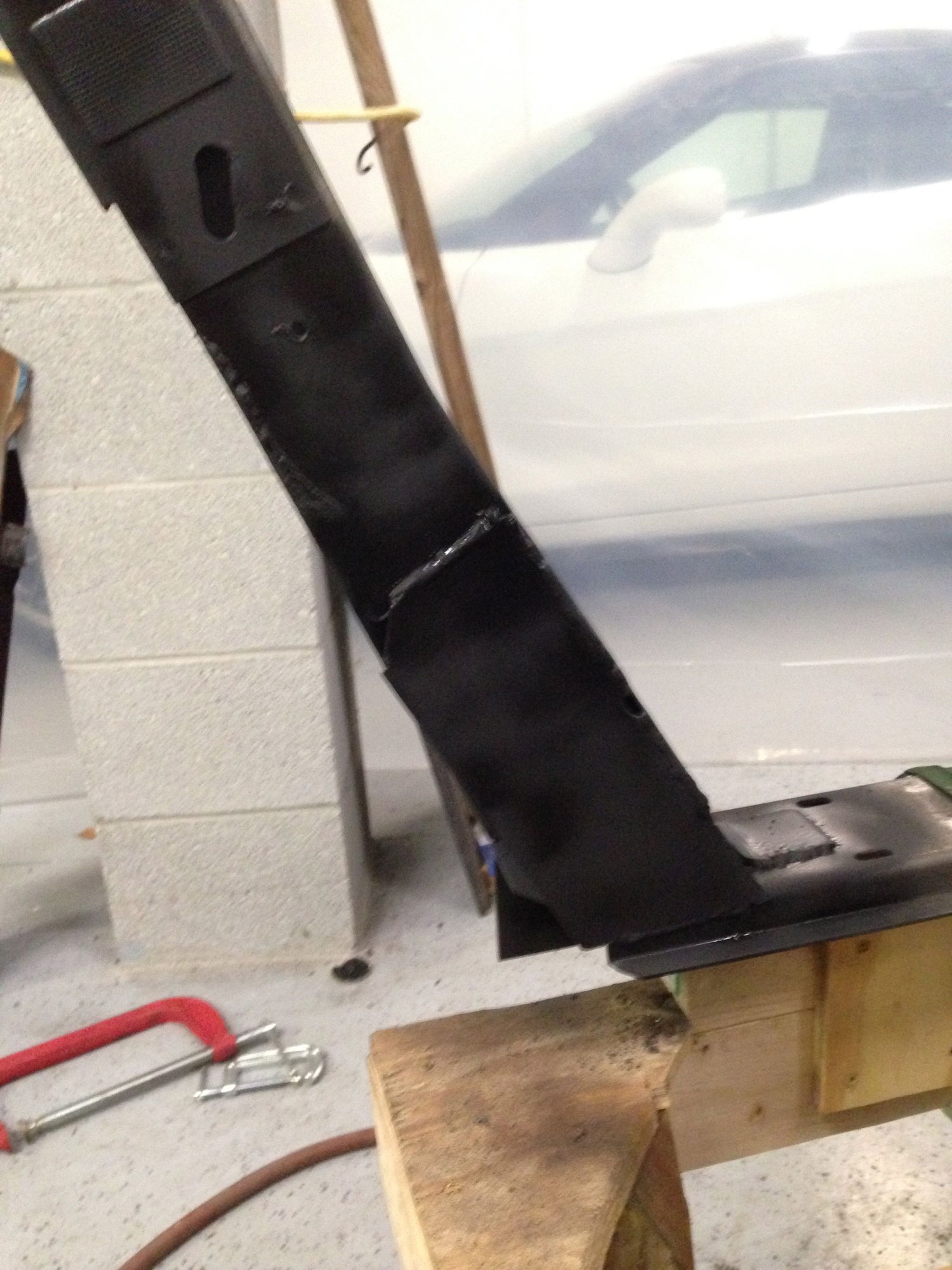

doing body work on and off as well, got rid of those popping front rivets and other small things:
glassing the back of the car on
smoothing things out
cracks repairs at the hood hinge mount
rivet repair (removed from underside, top had to be smoothed out a little bit)
one door jam done
rear suspension final mock up
front suspension back on

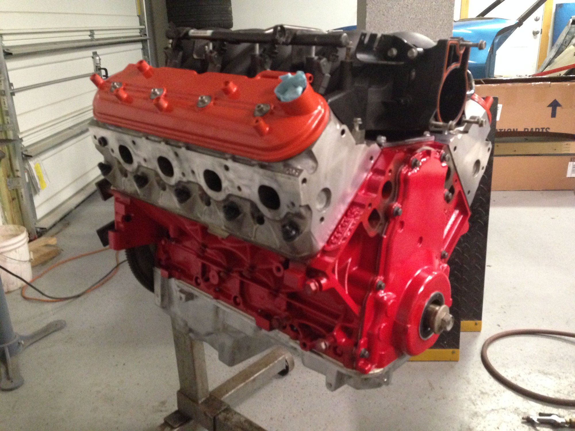

Motor is done:
Tick performance stage 3 turbo 5.3 cam with chromoly pushords, matching dual springs, ARP head studs and LS9 gaskets. Jeg's muscle car oil pan kit.

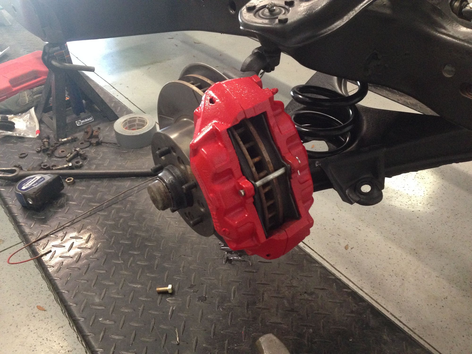

Fabed some brackets to mount the stock rear calipers:

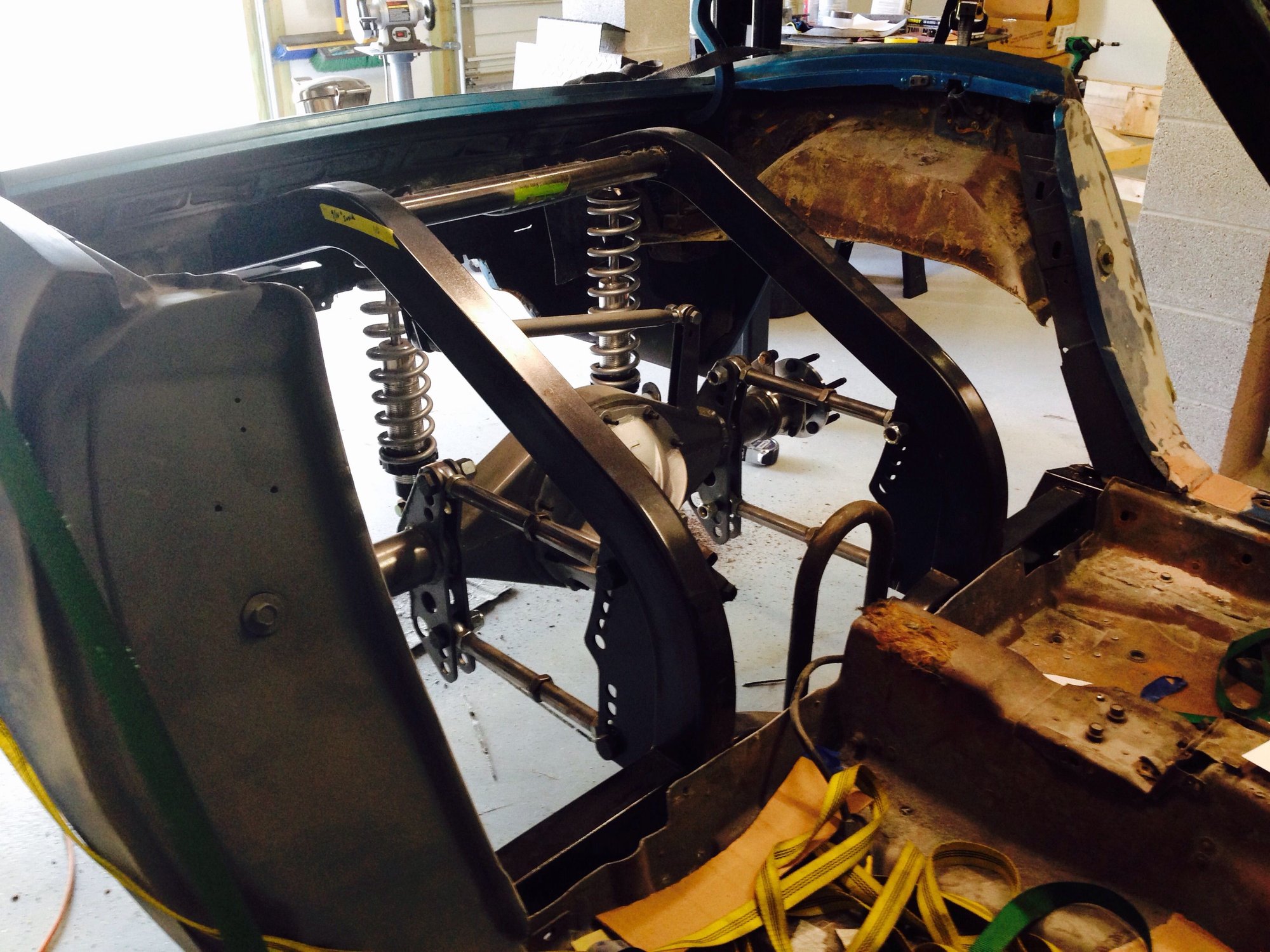

exciting day today, i decided it was time for a trial fit of the body on the frame:
