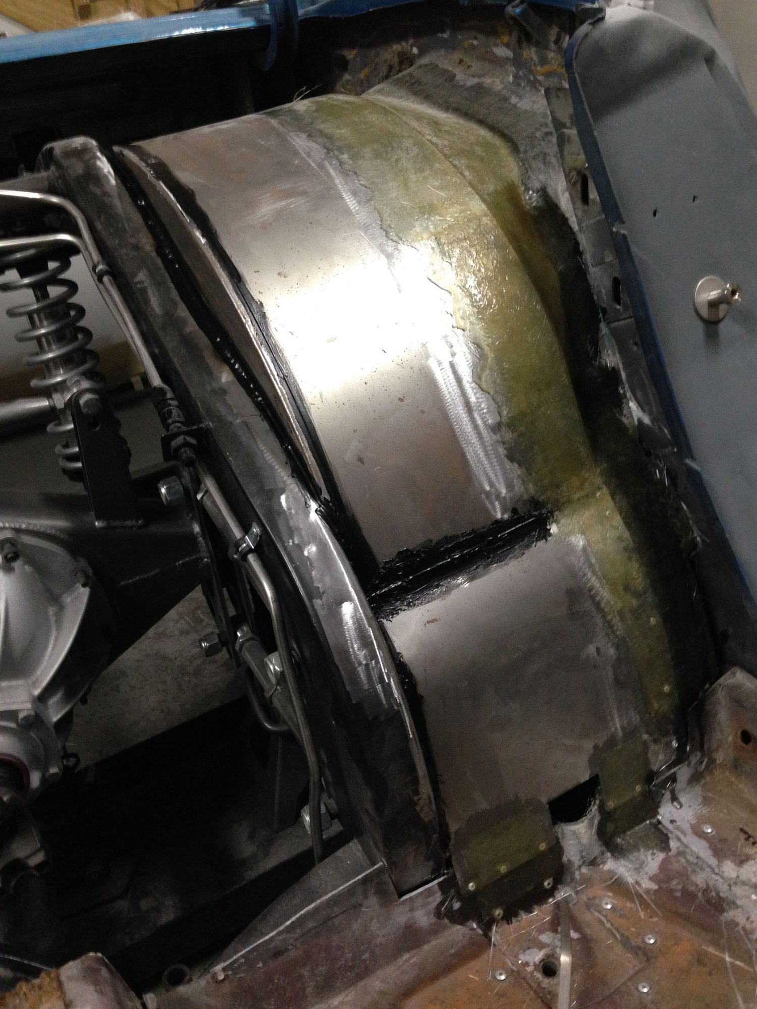

Great work. I have a 78 with the same issue with the front brace bonding. What are you using to bond it back on?
Originally Posted by mirage2991
While the wheel tub fiberglass was drying I decided to bond the front brace back on
another pic of the wheel tub almost all done, gooped it with seem sealer and it will get painted black

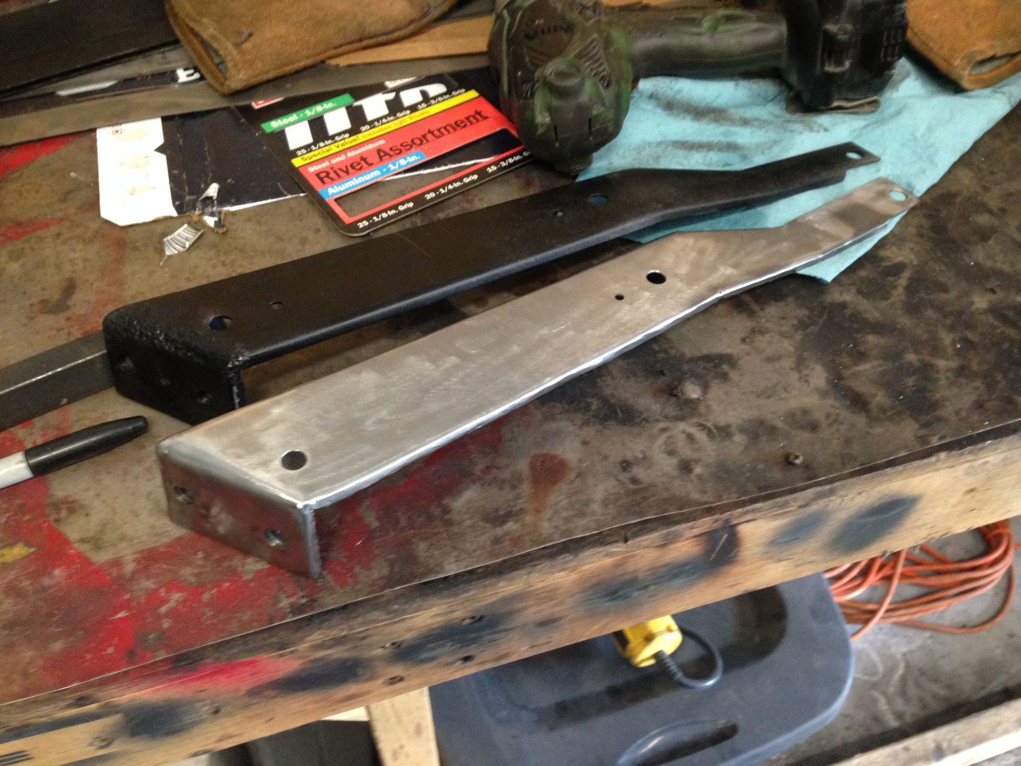

After buying the driver side radiator support renforcement bracket at the absurd price of 75$ (shipped), i decided i'd fabricate my own for the passanger side (which is actually a bit simpler than the driver side)

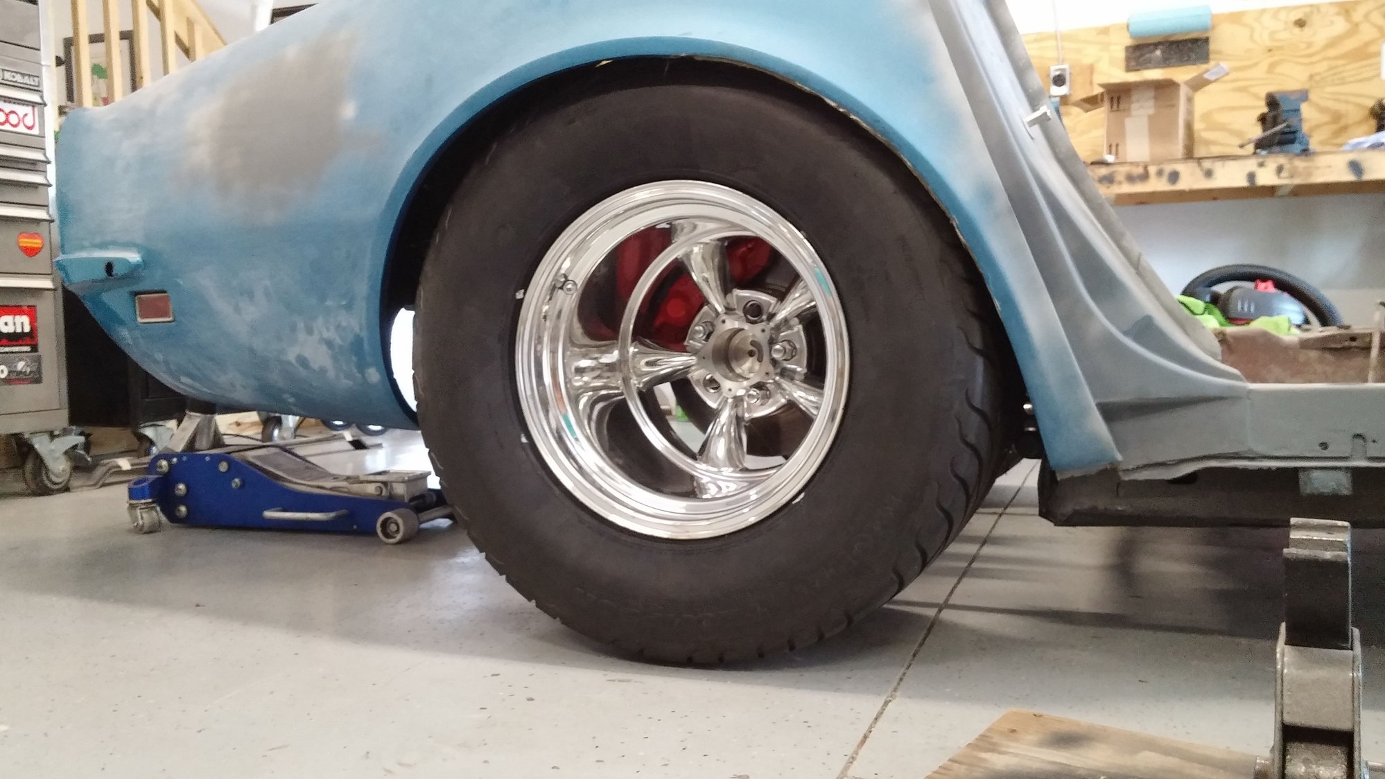

After almost a year, it is time to get back on to it: had the rims and tires mounted so i could finally see if all fits as intented and it does:

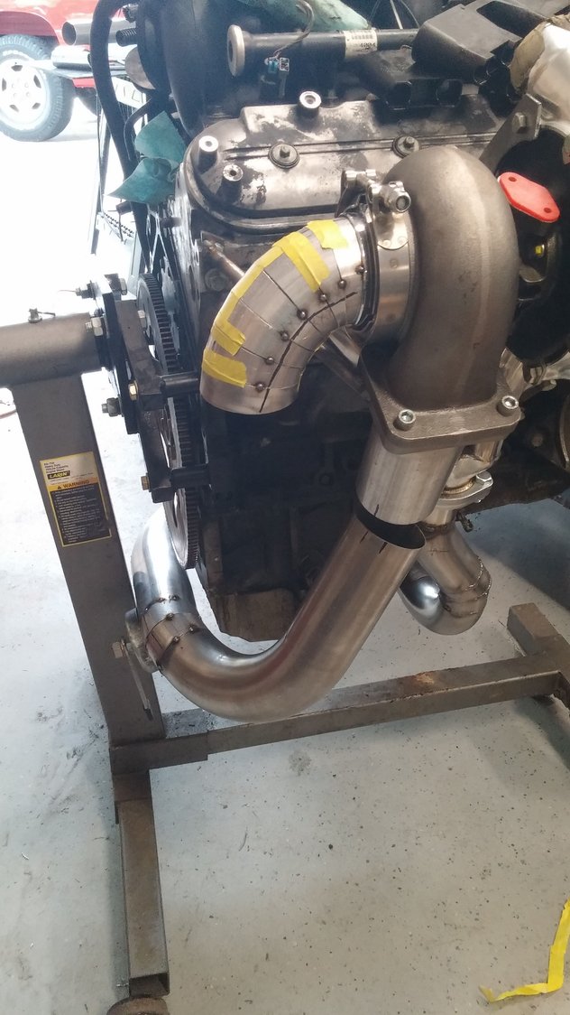

I have an absurd amount of hours in this y pipe....funny part is, i had to re do it and switch it back to,the other side (yup was on the driver side before). The radius using the pass side merge were going to be too tight... So i'm back to my original plan of running a single 3" pipe behind the oil pan....i'll also will need to mod the firewall to make room for the down pipe.

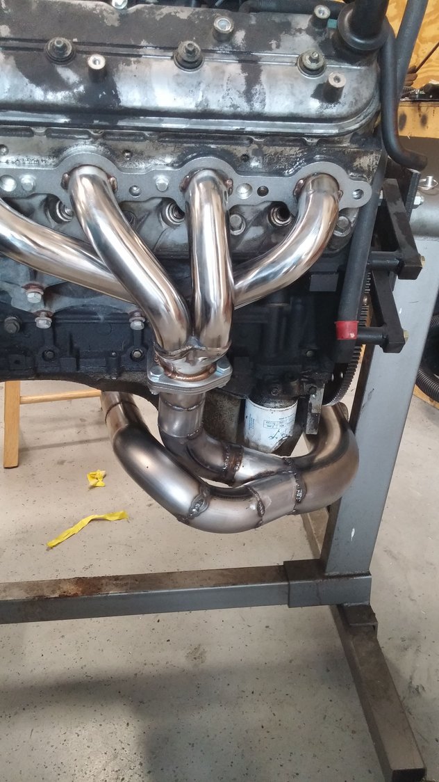

Hotside re-designed, and fabed the downpipe elbow

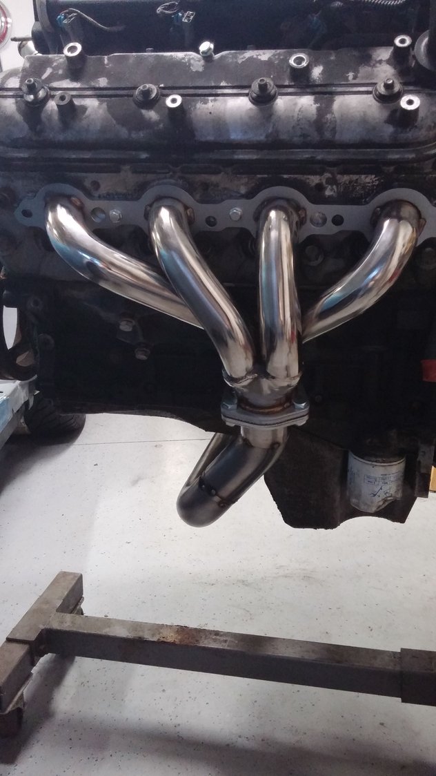

Great project. Your turbo placement is damn near the exact same placement as mine. I just ordered the block huger headers as well to switch out from the truck manifold setup I was running. Subscribed.

Here it is. This is why I'm going with the block huggers and running the cross over under like your doing. The current cross over I have a feeling is causing some heat soak with my fans and causing a bit of volt drop. I'll be going in front of the engine to try and keep everything tucked up as high as possible. I've also since gone back to the normal spark plug wire setup instead of wrapping around the engine.

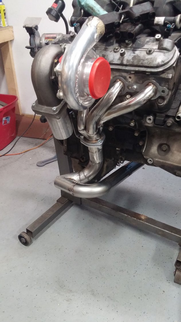

started making the turbo bracket
finished hot side, it will be sent to JetHot for coating
