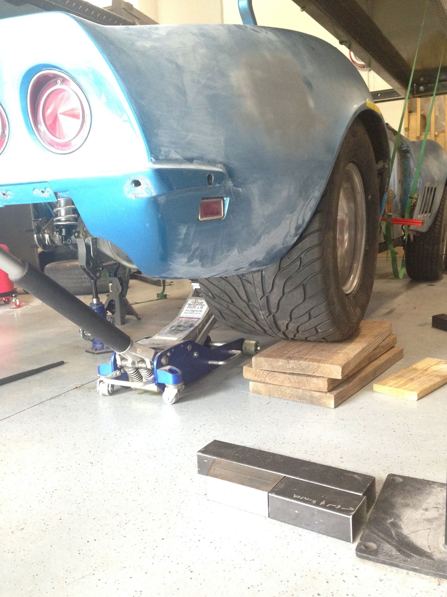

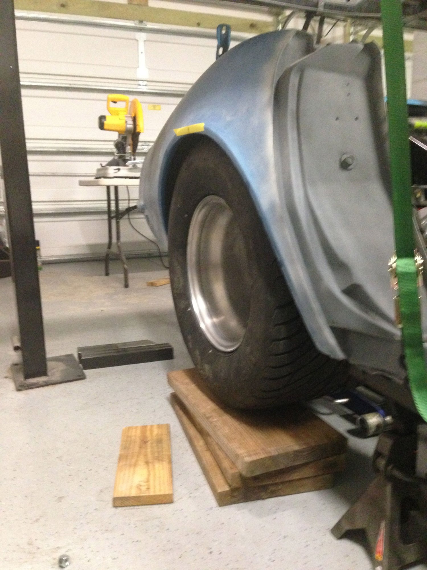

Progress is kinda slow, there's a lot going on and I'm a one man show….I borrowed a friend's 15x14 Welds rim and mounted a tire on it, and played with my wheel spacers to figure out the offset and adjusted the 4 link to get the best wheel centerline. This is where it will sit at the lowest ride height it can go (that only leave me 3" of clearance at the back half cross bar by the driveshaft loop). That's almost too low but I wanted to see how low I could get. Realistically I might raise it up 1/2" for good measure.
Evidently, I believe that overall it lowers the car about 1" or more from original height.
I could probably go another 1/4 to 1/2 outward but I'm out of backspace….this rim is a 4.5bs and I have 1" worth of spacer (to make it 3.5) and 3.5 is the smallest back space you can order

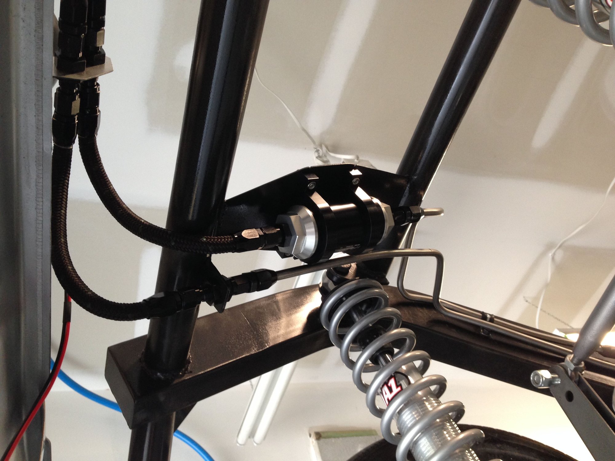

I received the new tank, installed the TankInc fuel pump and bent some SS line for the back half

revised the fuel lines and added a fuel filter

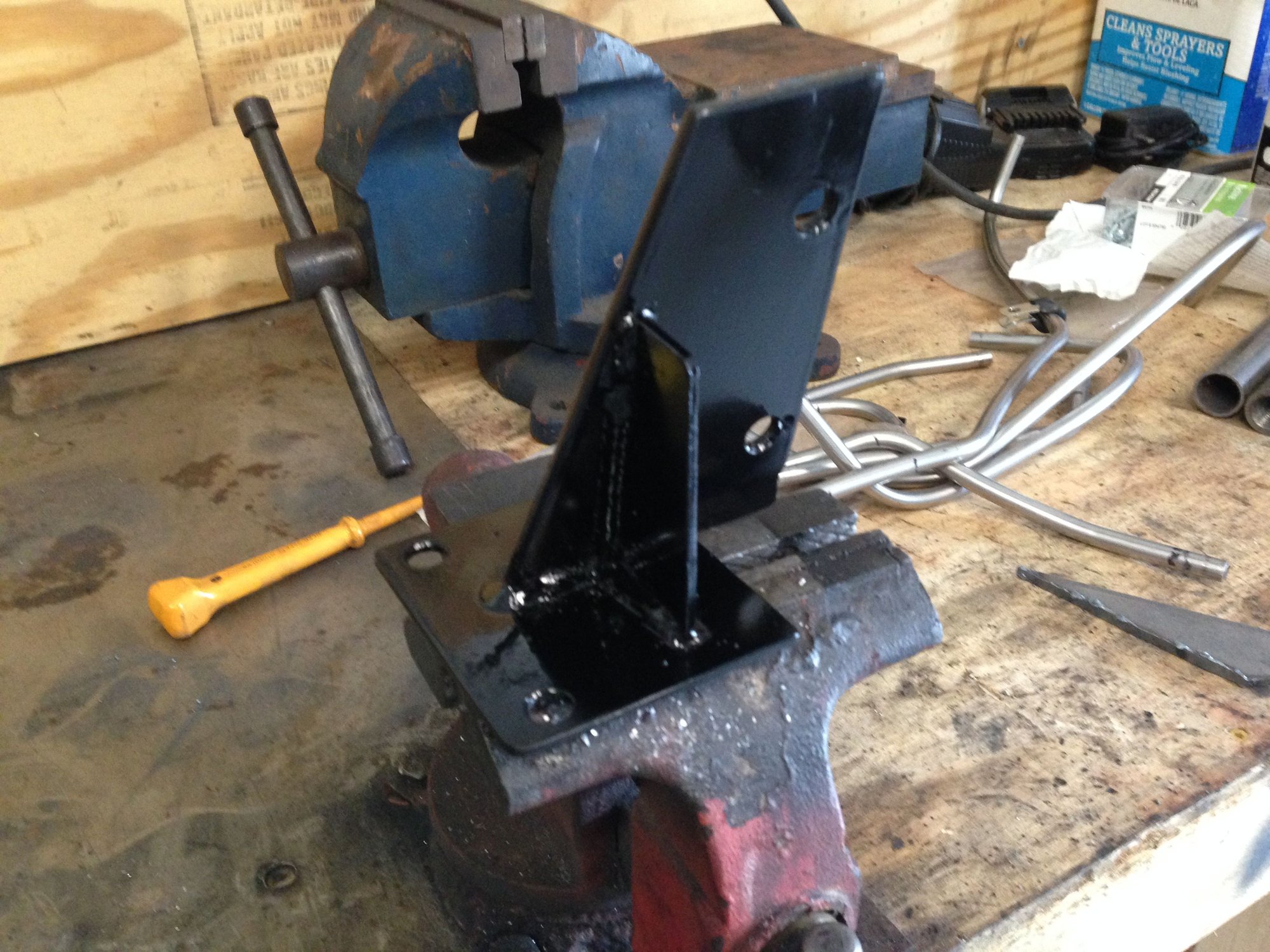

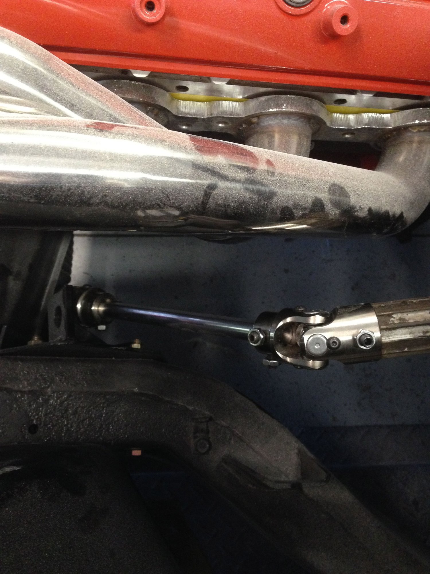

Then installed my rack and pinion: this is the Steroid kit, except I pieced it together. I bought the two brackets off them (save me fab time) and made one bracket (basically the gusset for the driver side bracket) and bought the rack from Rock Auto for 97 bucks

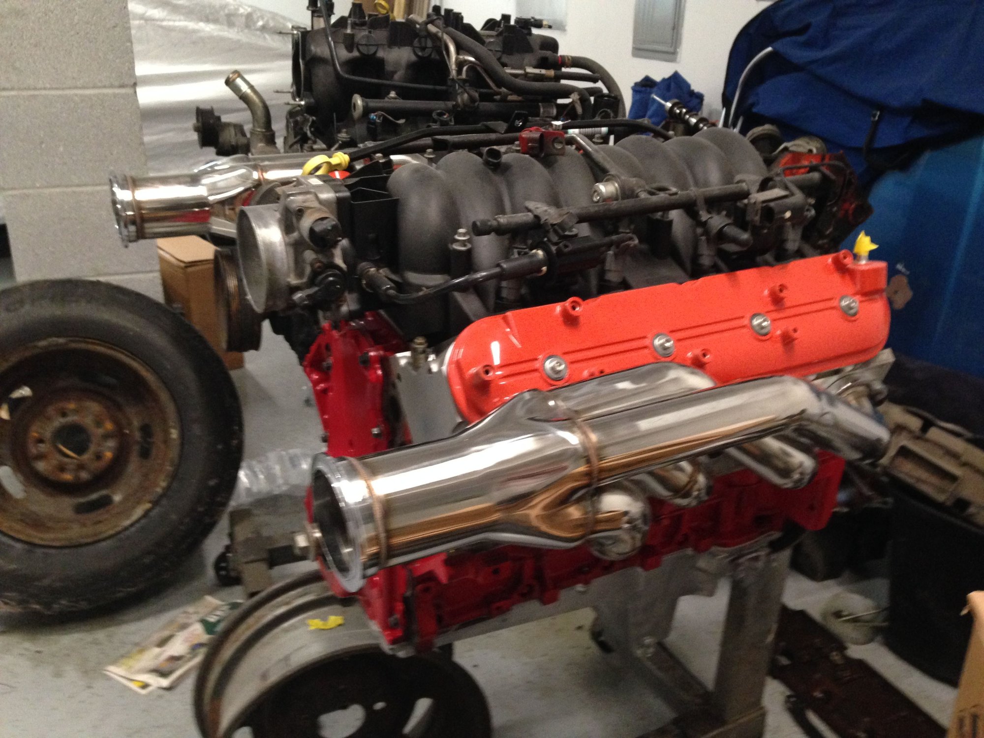

Bling!
shinny headers.

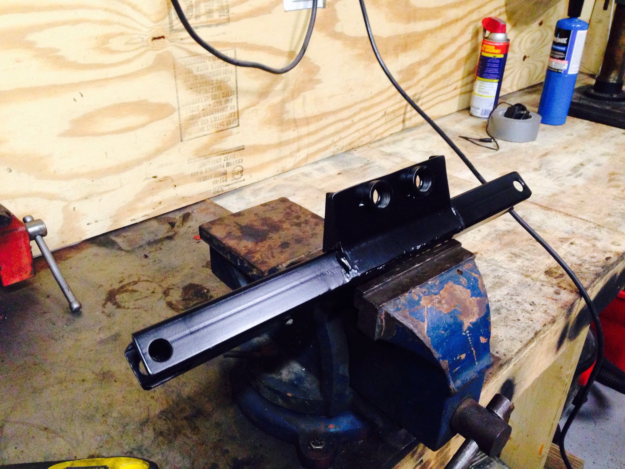

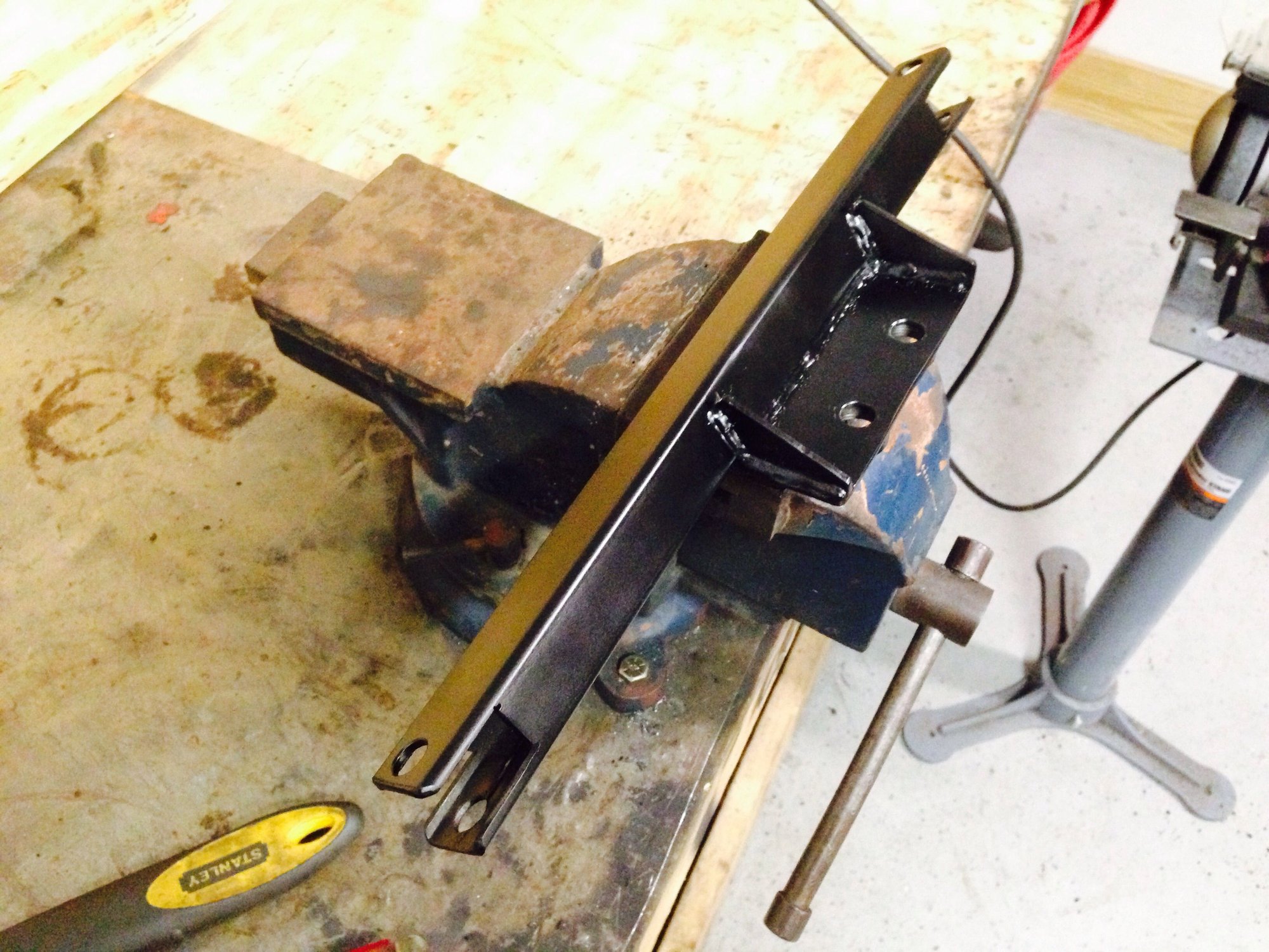

Finished the steering bracket:

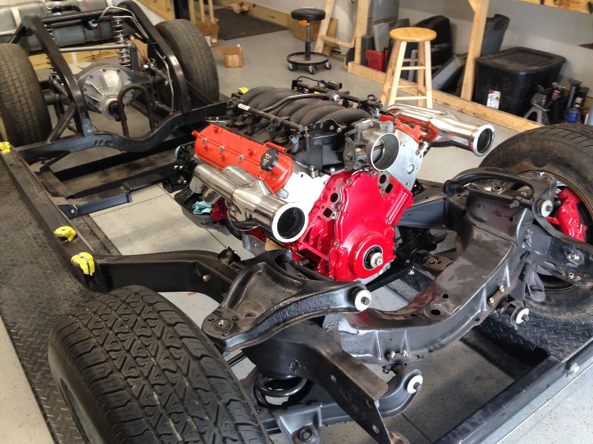

Bam! motor/trans are in….

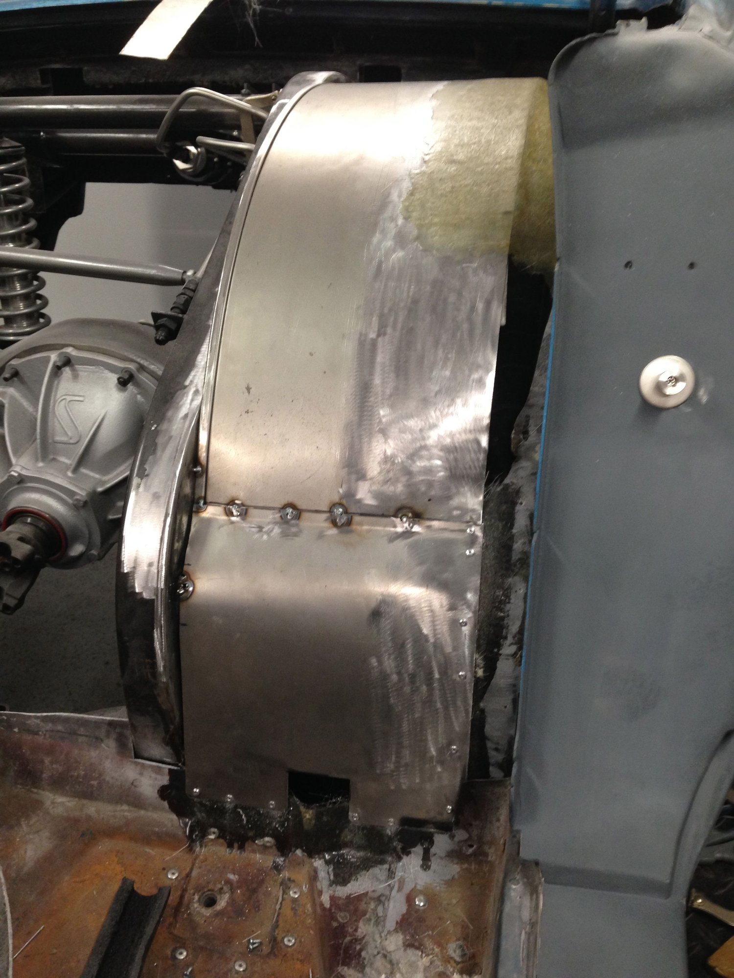

body is back on the frame, for good now, and I have steering. Working on re-constructing the back half of the car starting with the wheel tubs

While the wheel tub fiberglass was drying I decided to bond the front brace back on
another pic of the wheel tub almost all done, gooped it with seem sealer and it will get painted black
