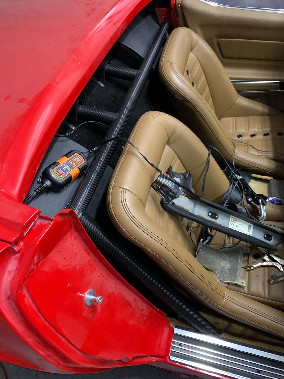

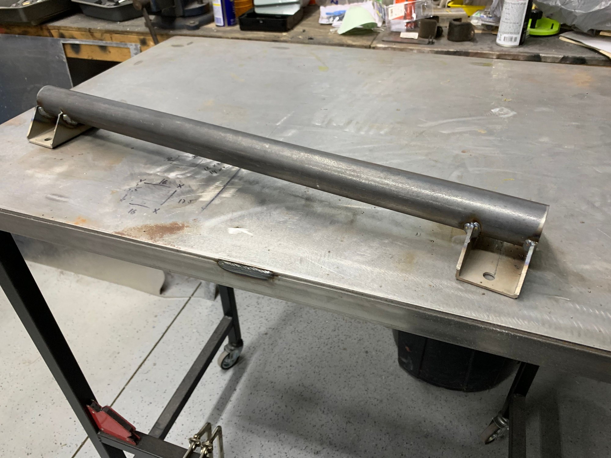

Took the car around the block for the first time, was uneventful (always like it that way lol), ride is pretty smooth (went all school, no seats, sat on the floor lol)...forgot I had no front sway bars either, installed that afterwards

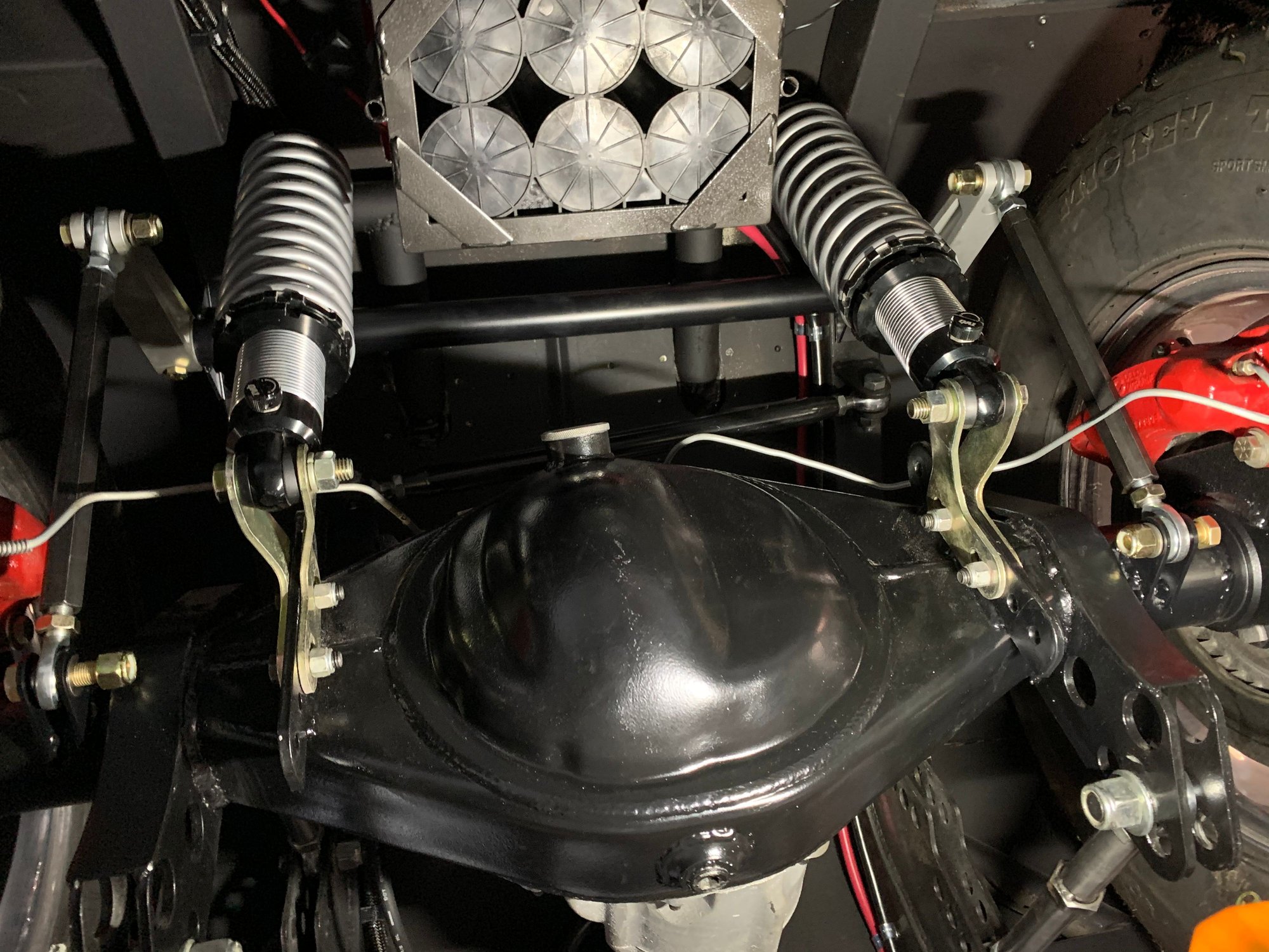

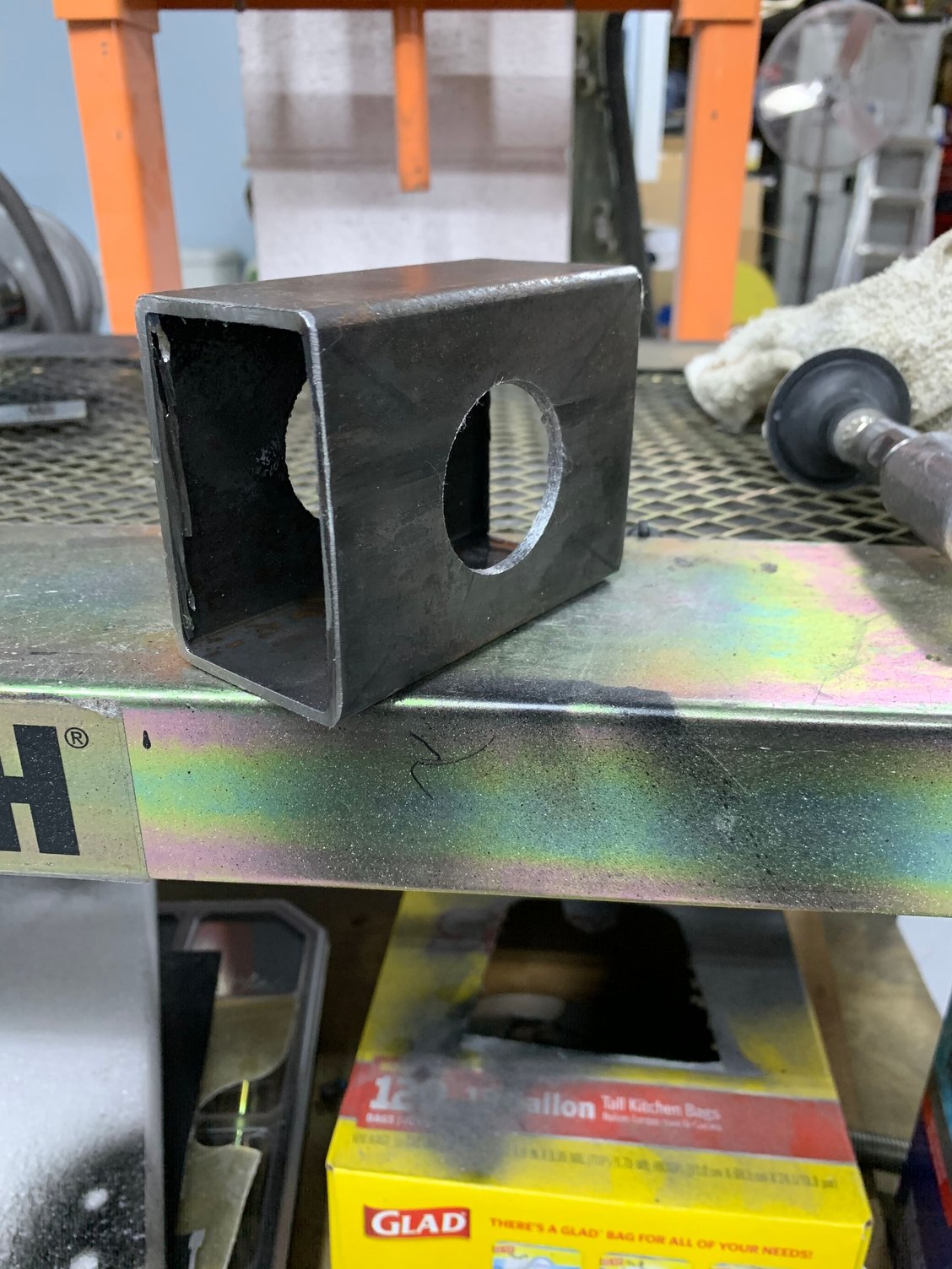

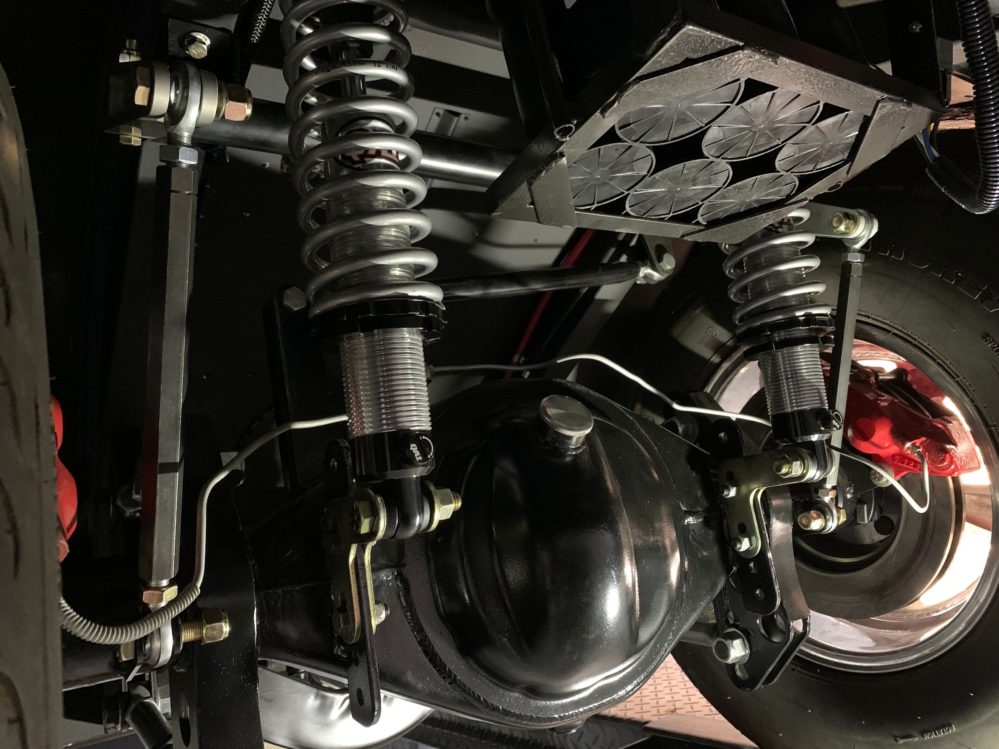

I decided to add an anti roll bar to the 4 link, got the Jegs kit, worked out really nice and easy to add. Couple custom brackets later, I made it a bolt on set up.
For the bracket I used a piece of square tubing, used a hole saw to drill its center, then plasma cut it in half and the end angles.

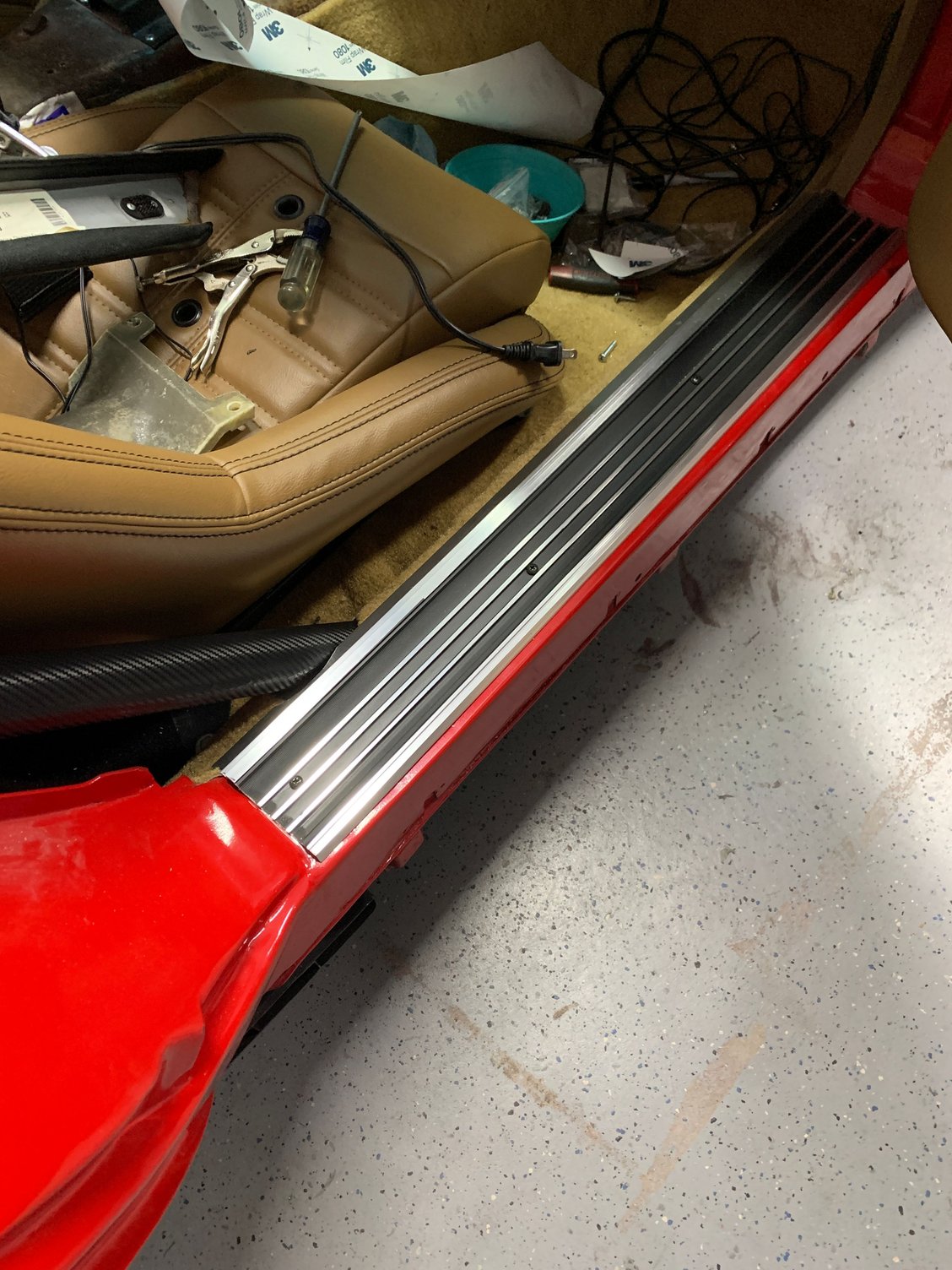

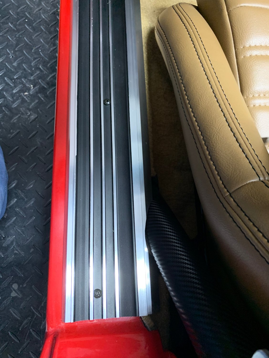

Drive side is pretty much completed, installed sill pate and wrapped the bar in CF wrap material...getting there, at snail pace these days...

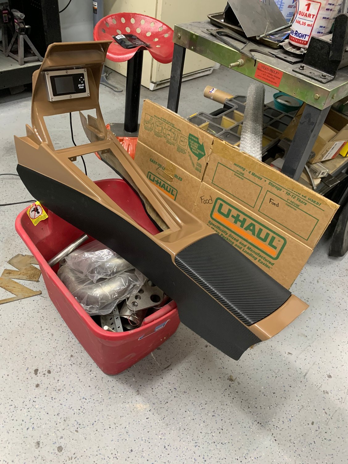

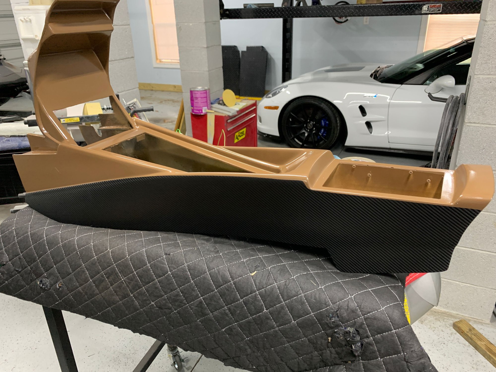

Working in the console a bit, added some cf wrap for the bottom:

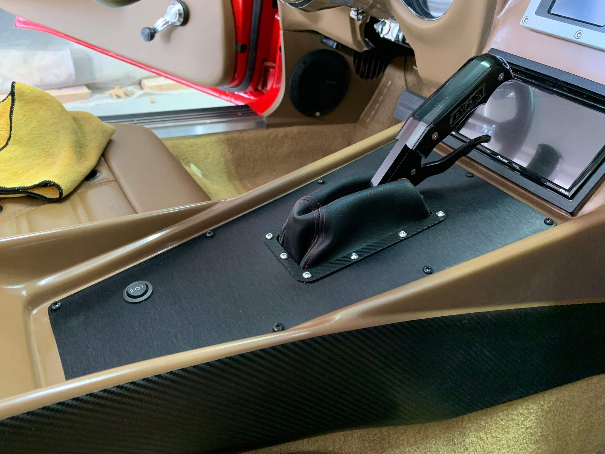

More work on the console, finished wrapping it, and installed the Fitech controller/screen as well

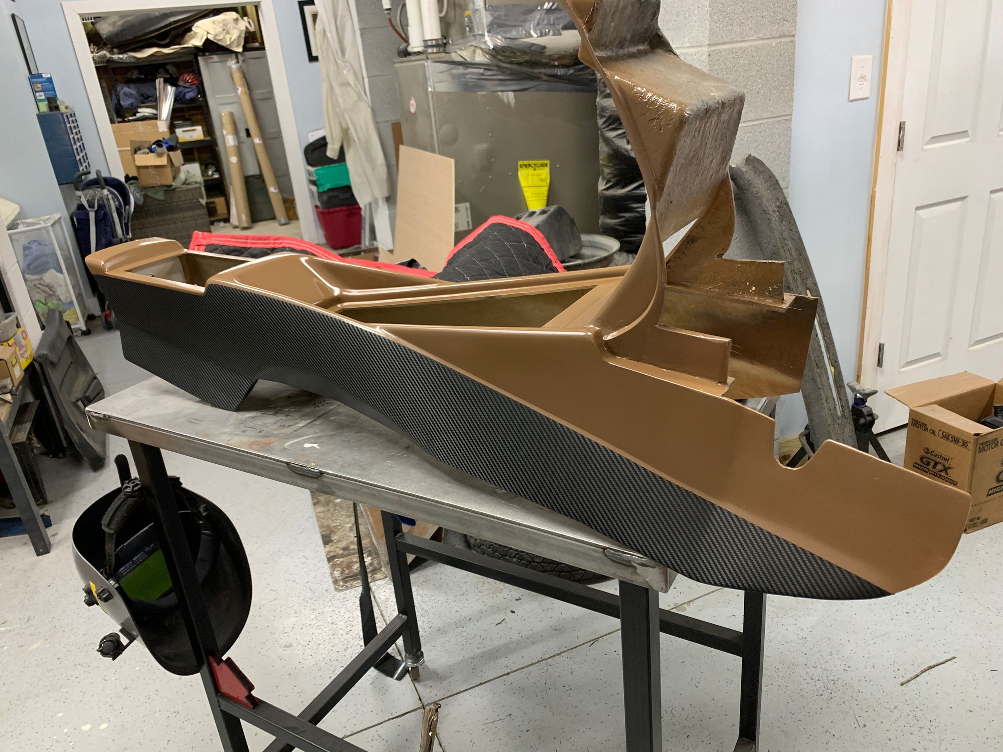

More goodies arrived today, from Modern Classic:
the center console in my car may be borked, so this is looking more appealing.
as you're doing all these fitment adjustments, is that info going back to modern classics? are they updating their mold to fit better? I'd like to use this but minimize additional fabrication effort which isn't necessary
also did you get your custom? on their website they don't seem to sell one with that rear storage compartment

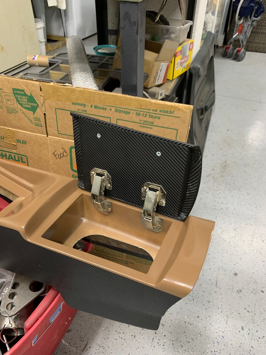

They don't show the rear storage compartment, it was a surprise when it arrived as they didn't say it would have it.
No I have not reported back to modern classic because it would be impossible for them to make corrections unless they had mine in hand. I also believe they are trying to have one console fit all C3... I have hours into this and unless you are comfortable working with fiberglass and fabricating, I wouldn't recommend it...now if you want to save some massive amount of time from making one from scratch then yes, this works well, 75% of it done, the 25% is simply fitting it to your car.

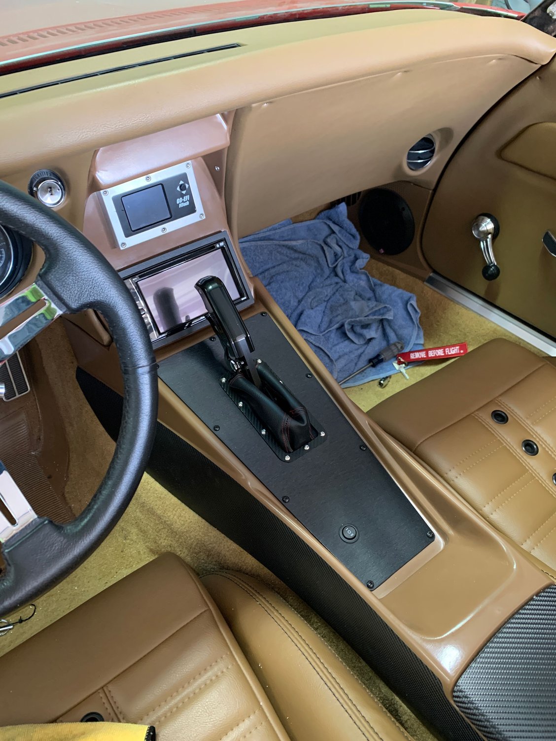

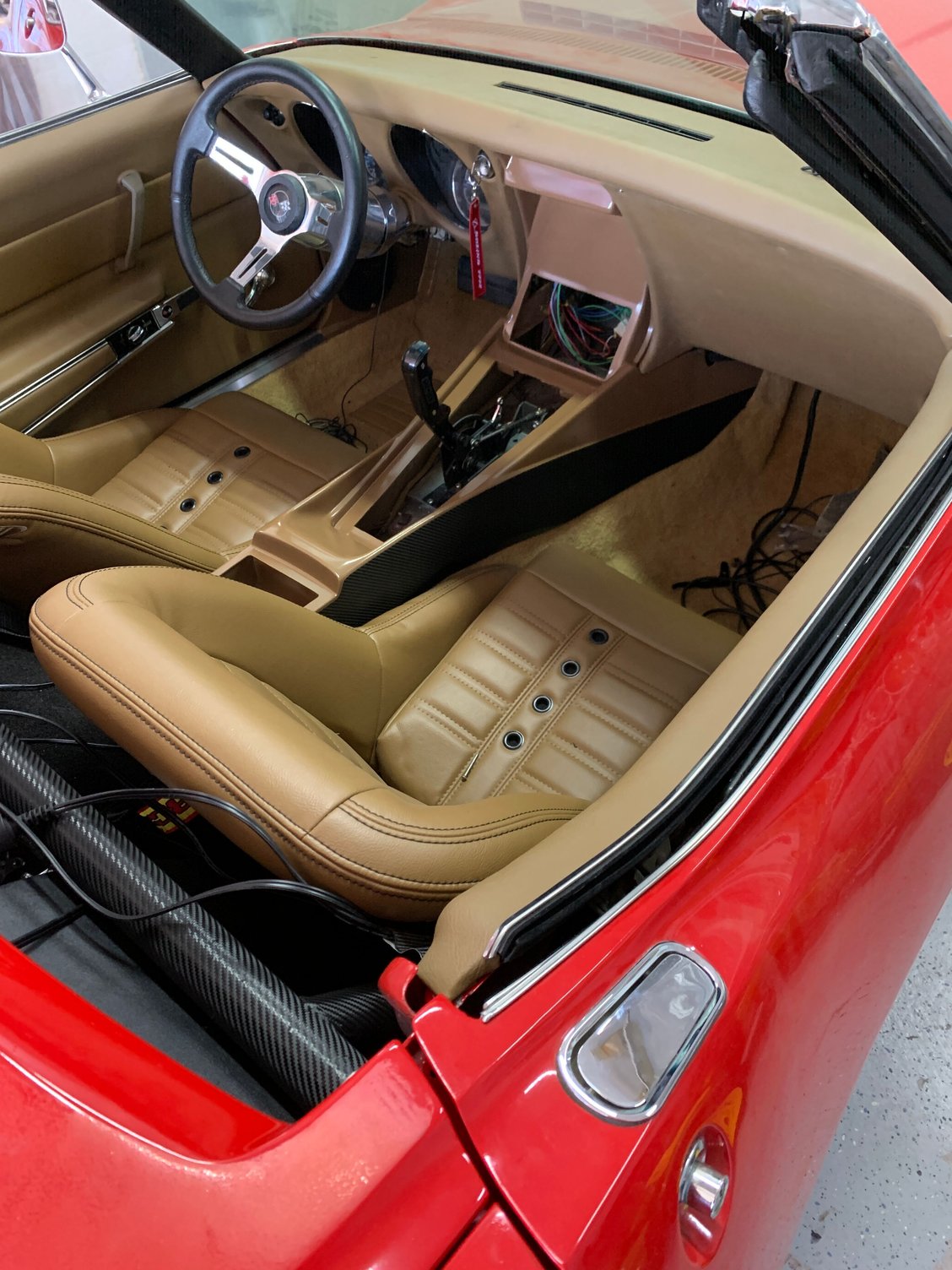

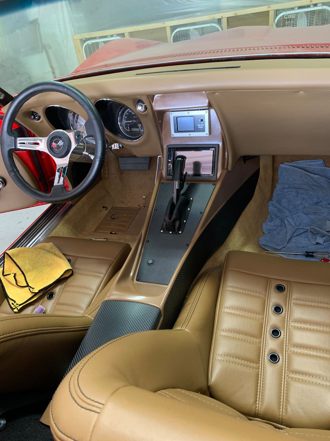

And now for a little update....basically the interior from the seats forward is done...console is all finished and in for good.

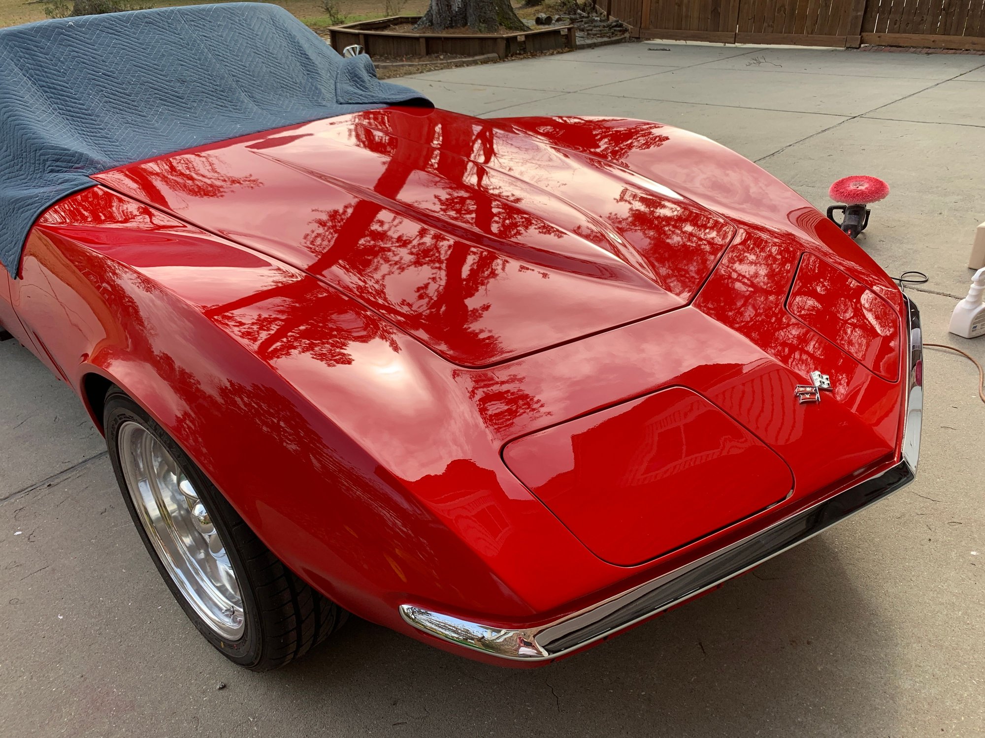

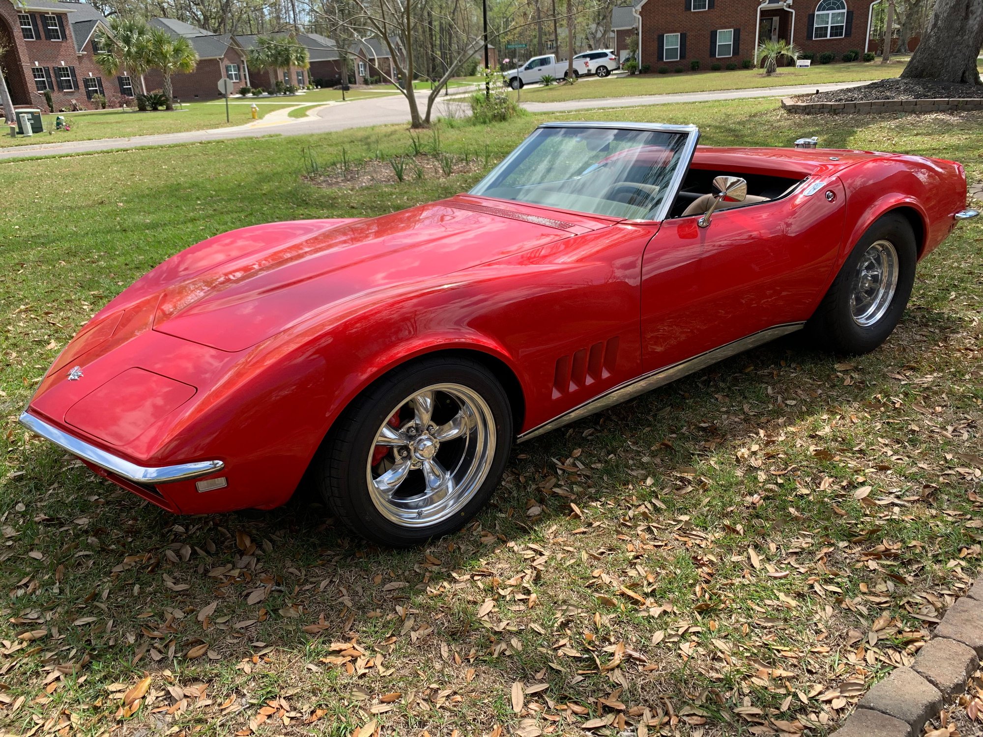

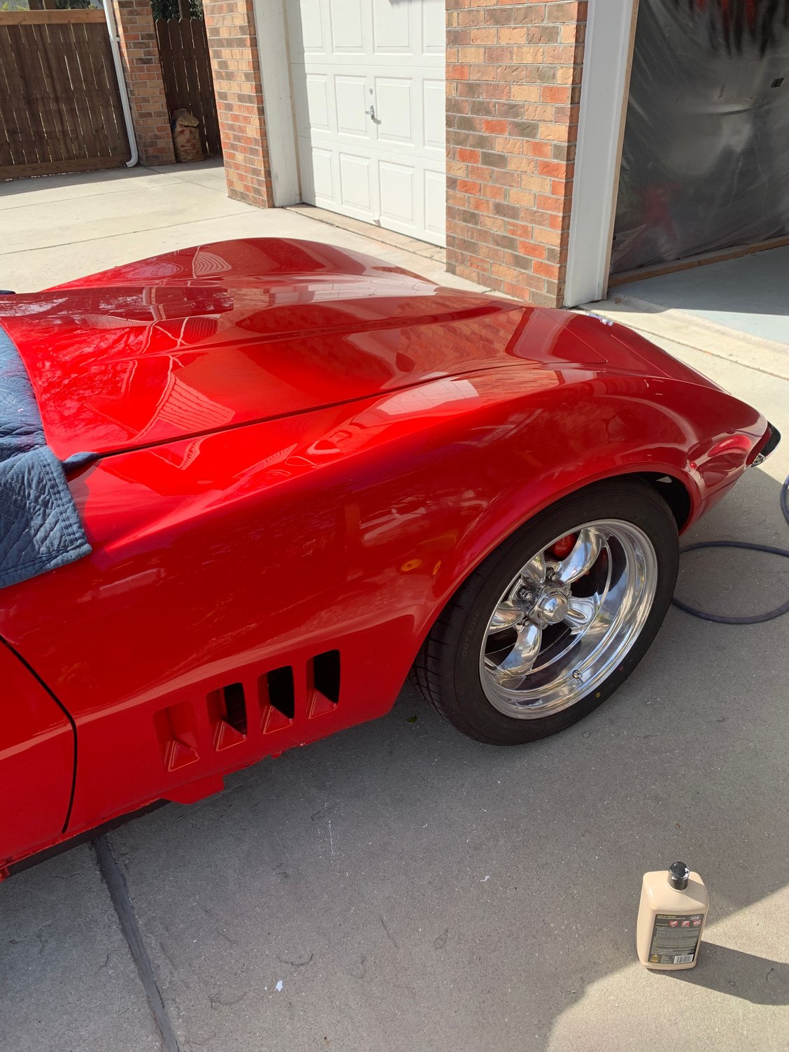

Had a warm and sunny monday this week, good time to start bringing some shine to the project, since I'm in the final stages:

The car looks stunning! I guess I missed something in the build.....the "handle" in the console, is that an emergency brake handle or a shifter? If it's one....where is the other????

B&M magnum grip shifter. No parking brake.

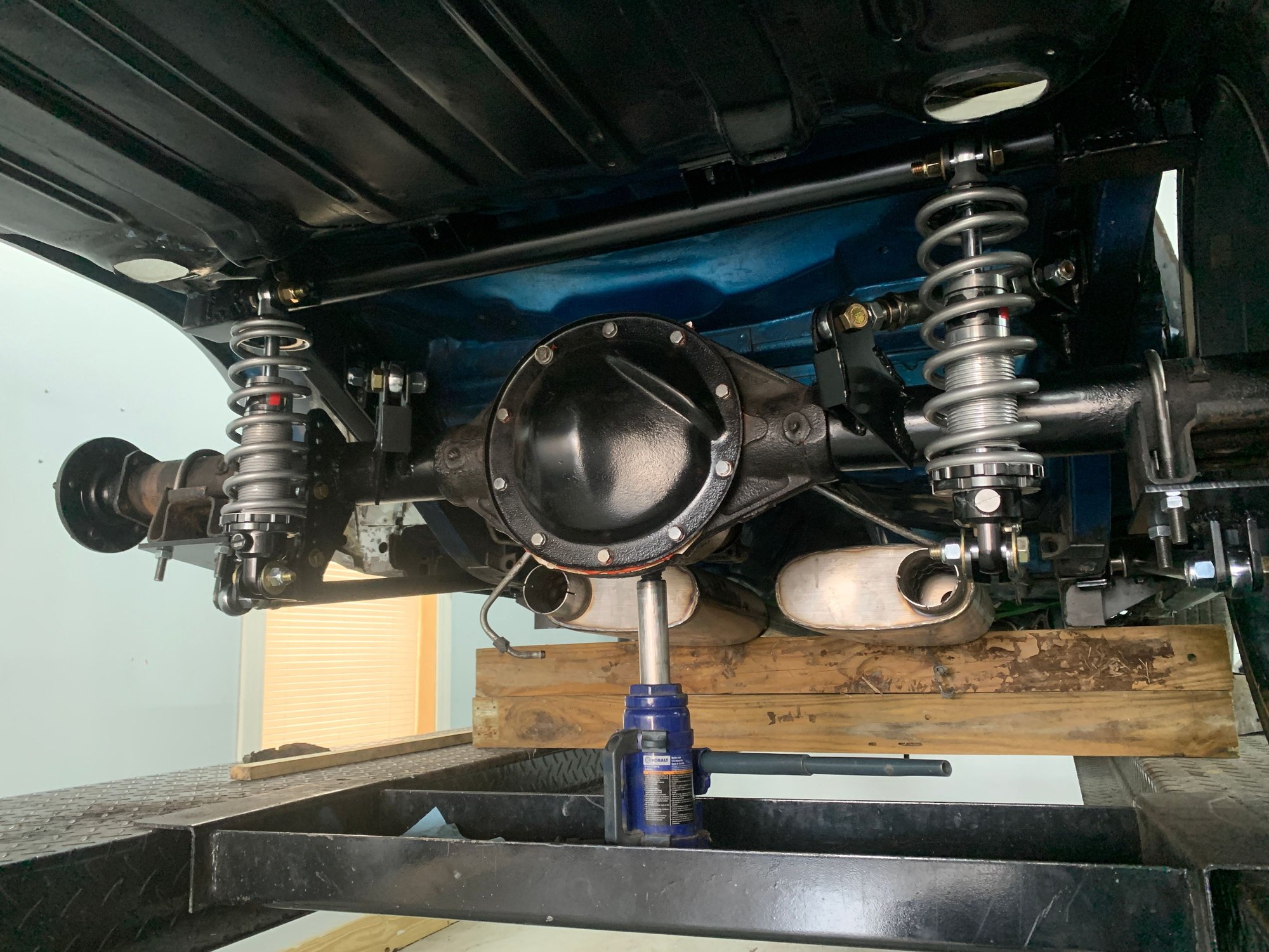

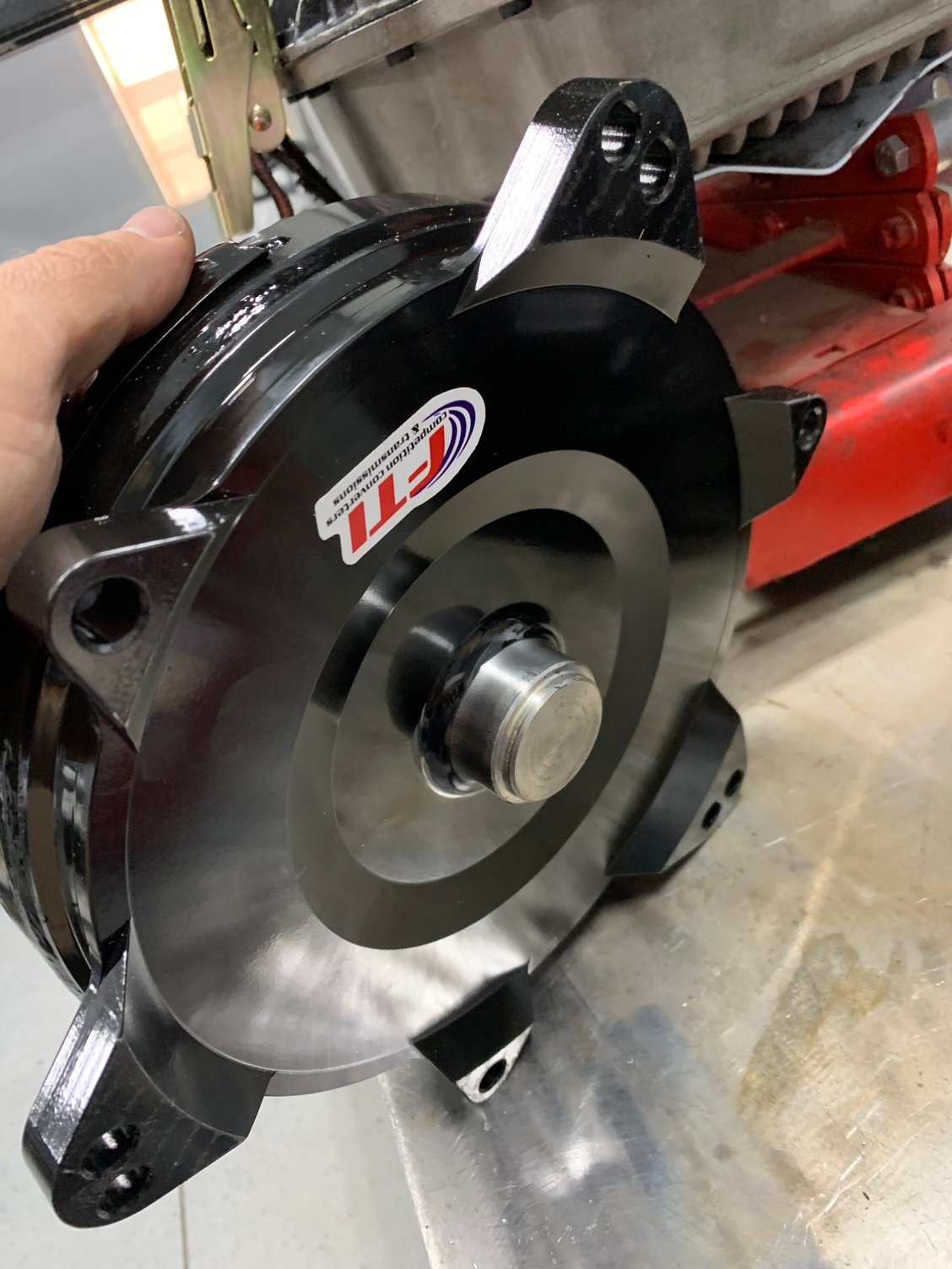

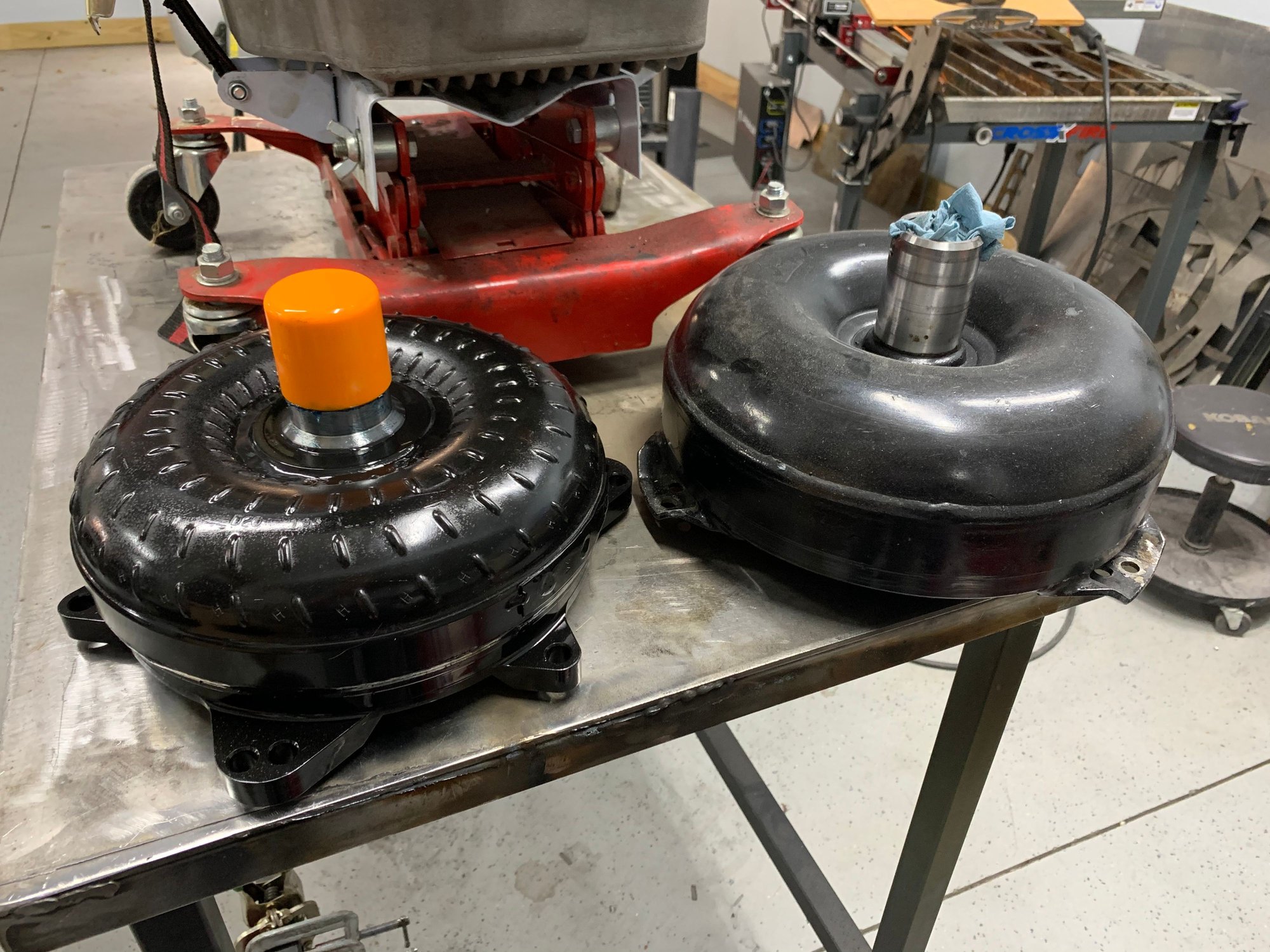

After almost 4 weeks (including shipping time) got the trans back.... since it was out, time to upgrade the converter... went from 2500 to 32-3400 to help spool that turbo quicker. Had FTI build me one of their SR series. Nice looking unit.
