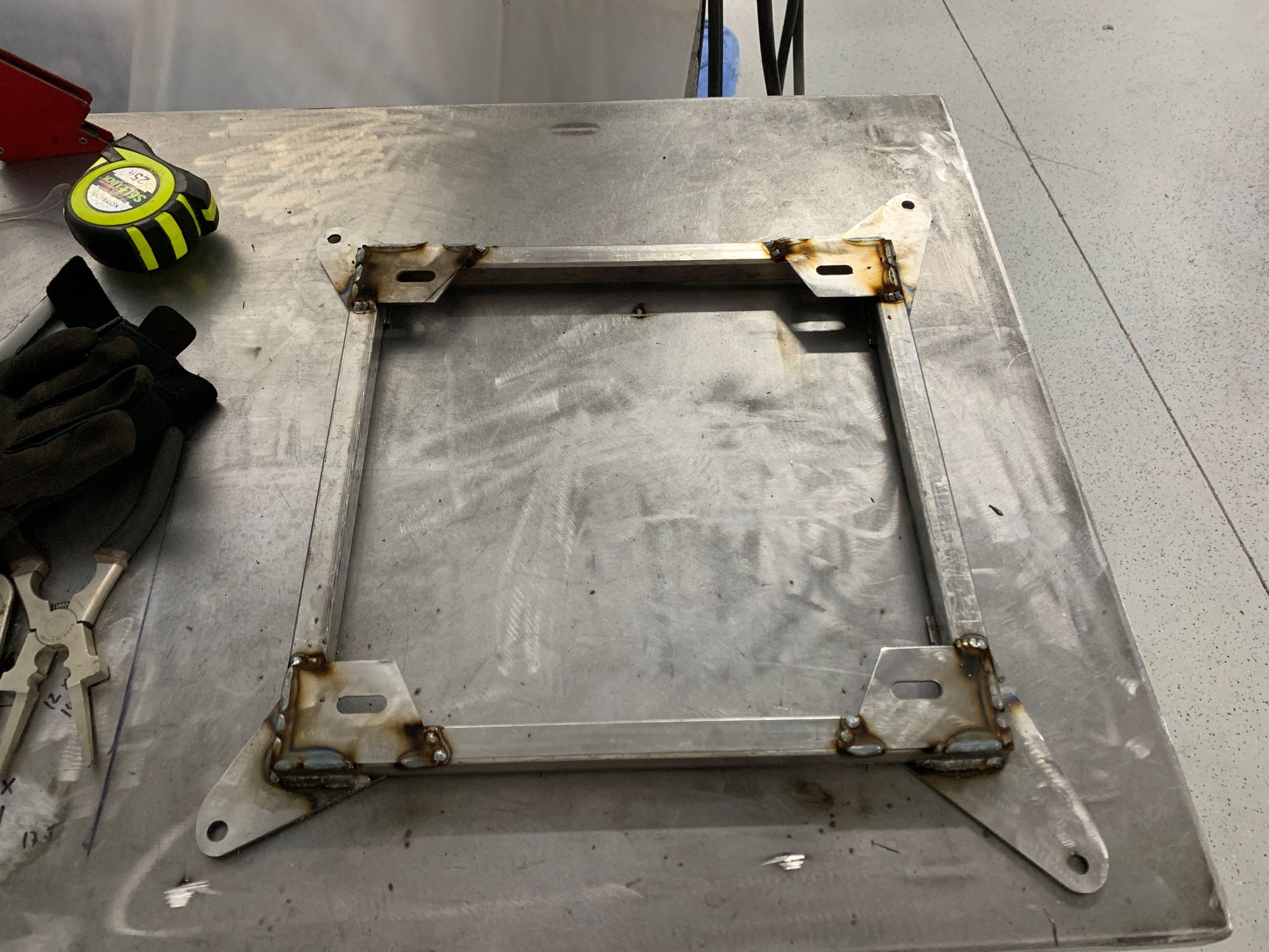

This is the seat brackets i made to allow the seat to sit as low as possible

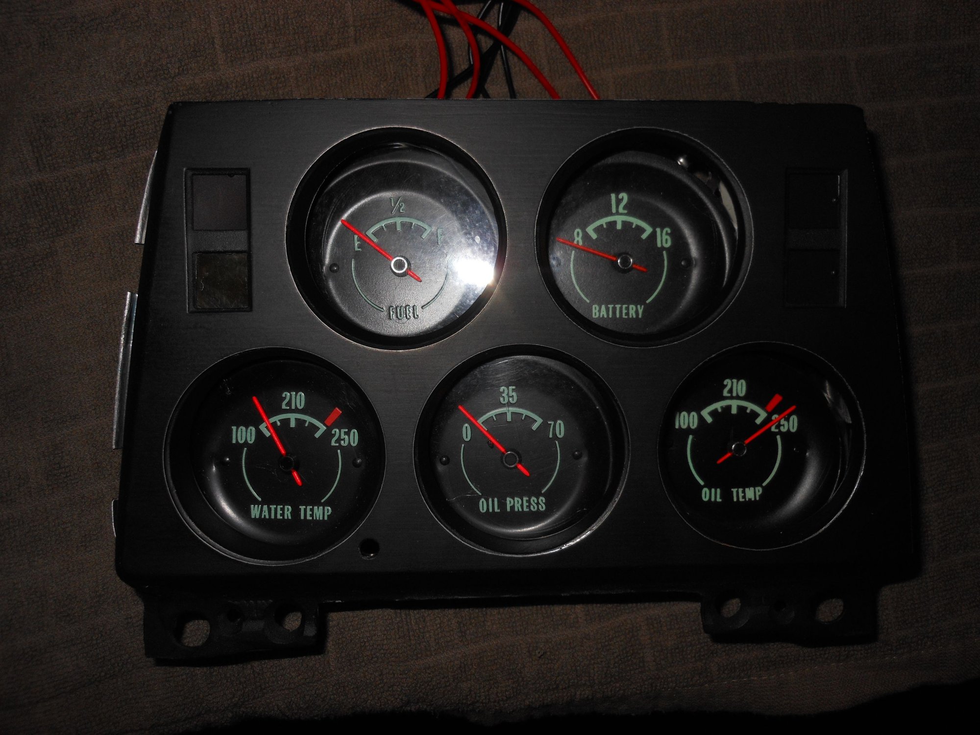

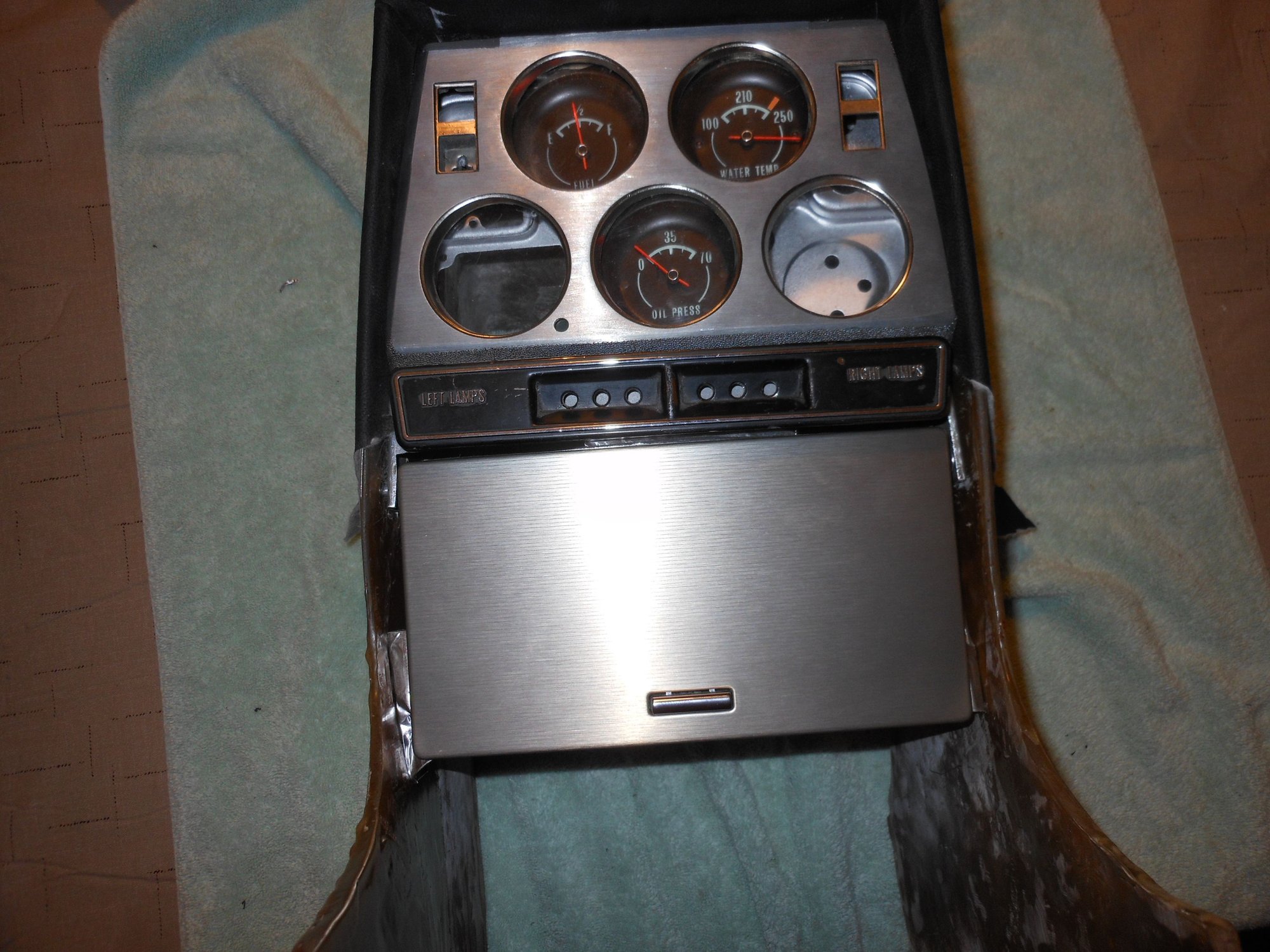

Here's a thought on your dash-console-
I'd stick with the tan- and maybe trim it out with a brushed aluminum look- painted black. I think it adds an nice touch- not as "look at me!"
I did it to my gauges- hit it with a belt sander - then sprayed it a flat black.
Here's the dimensions- for anybody else interested

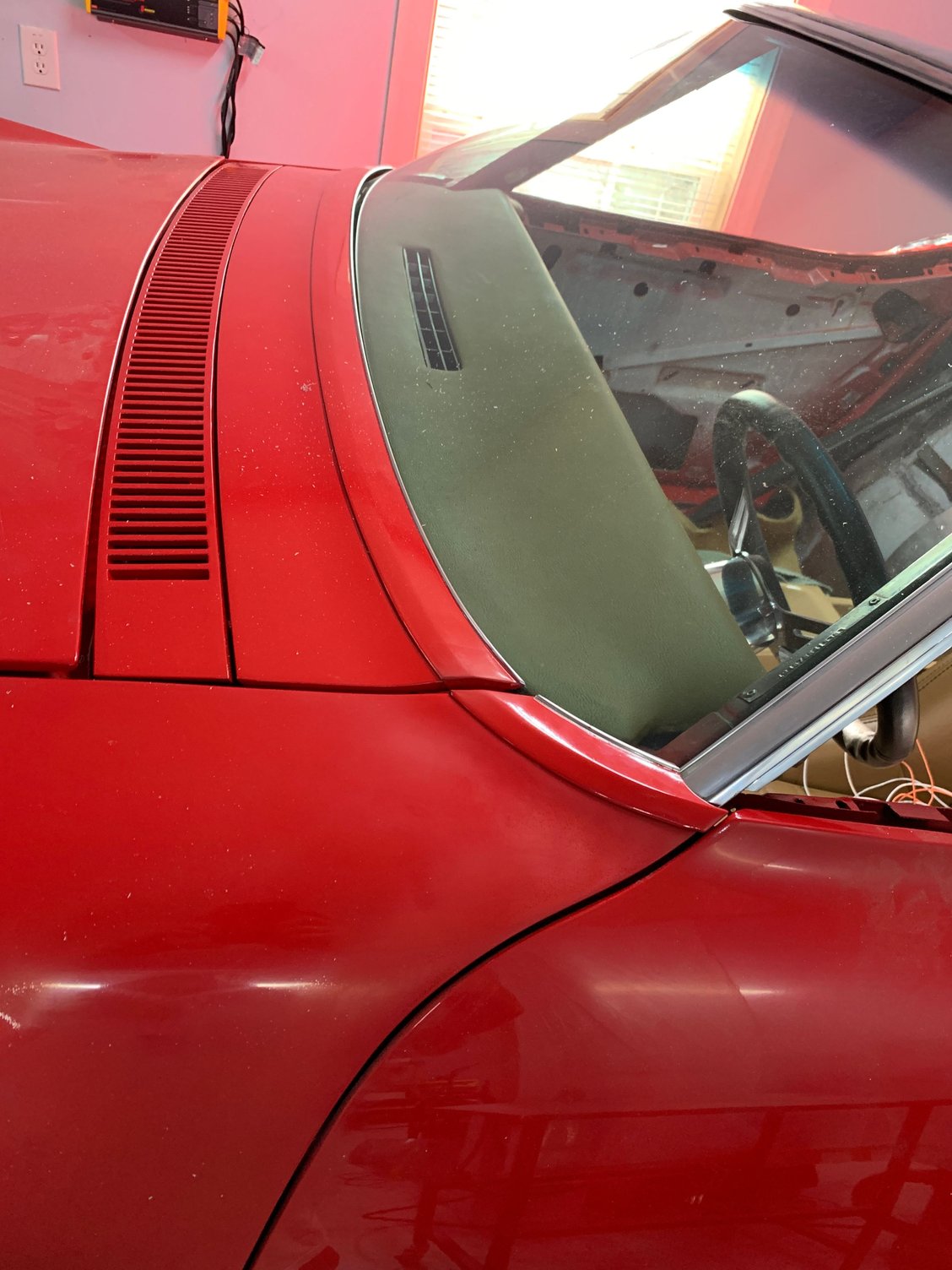

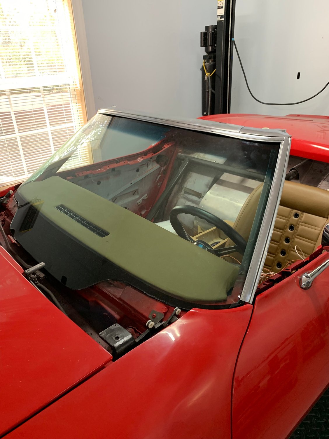

got the windshield in...not super thrilled with the original thin upper reveal that simply won't sit correctly. Lets face it, that's one bs piece of trim, you can bend it by just looking at it sideways and those clips, I'm not a fan of them either (I prefer 69 camaro trim clips over those by a long shot and I wasn't a huge fan of them either ! LOL). I'll probably buy a new trim piece later on. It sit flush until you tuck in each corner then it bow at the same two spots on the left and right of the windshield.
Got the windshield set almost right...could have been spaced out more on top, but I ain't pulling it out (that's how I cracked my perfectly good factory one, so no thanks !)

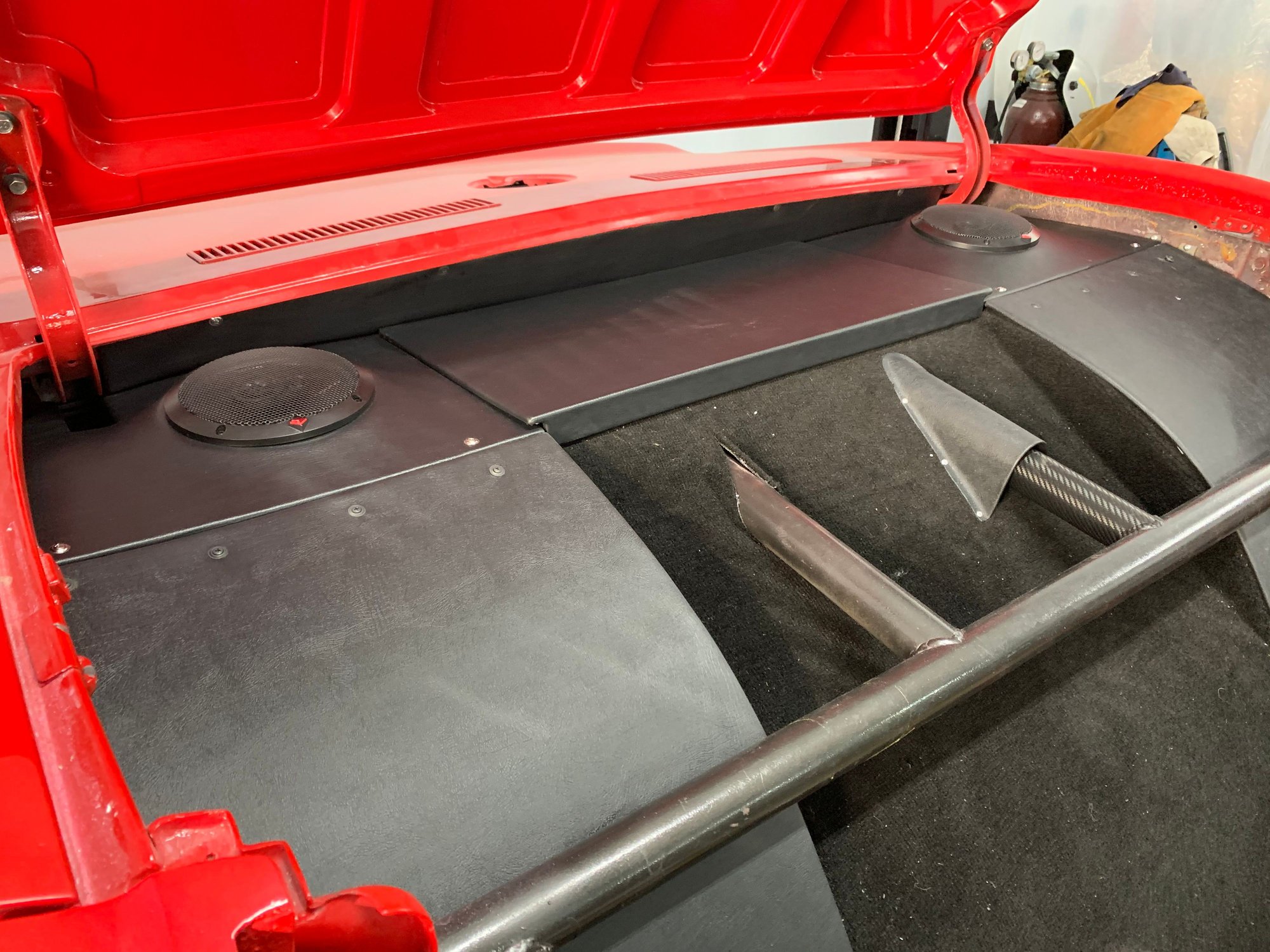

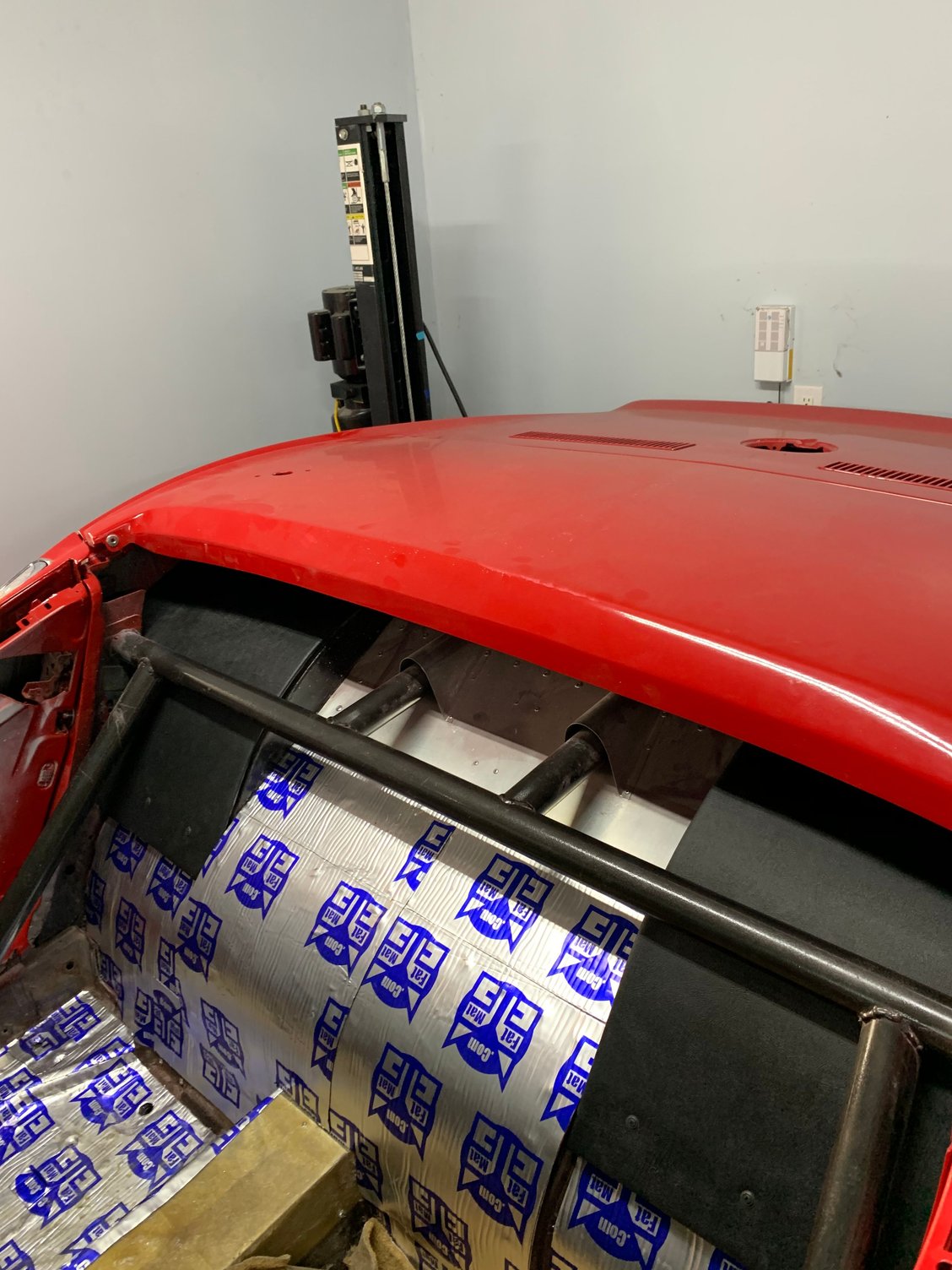

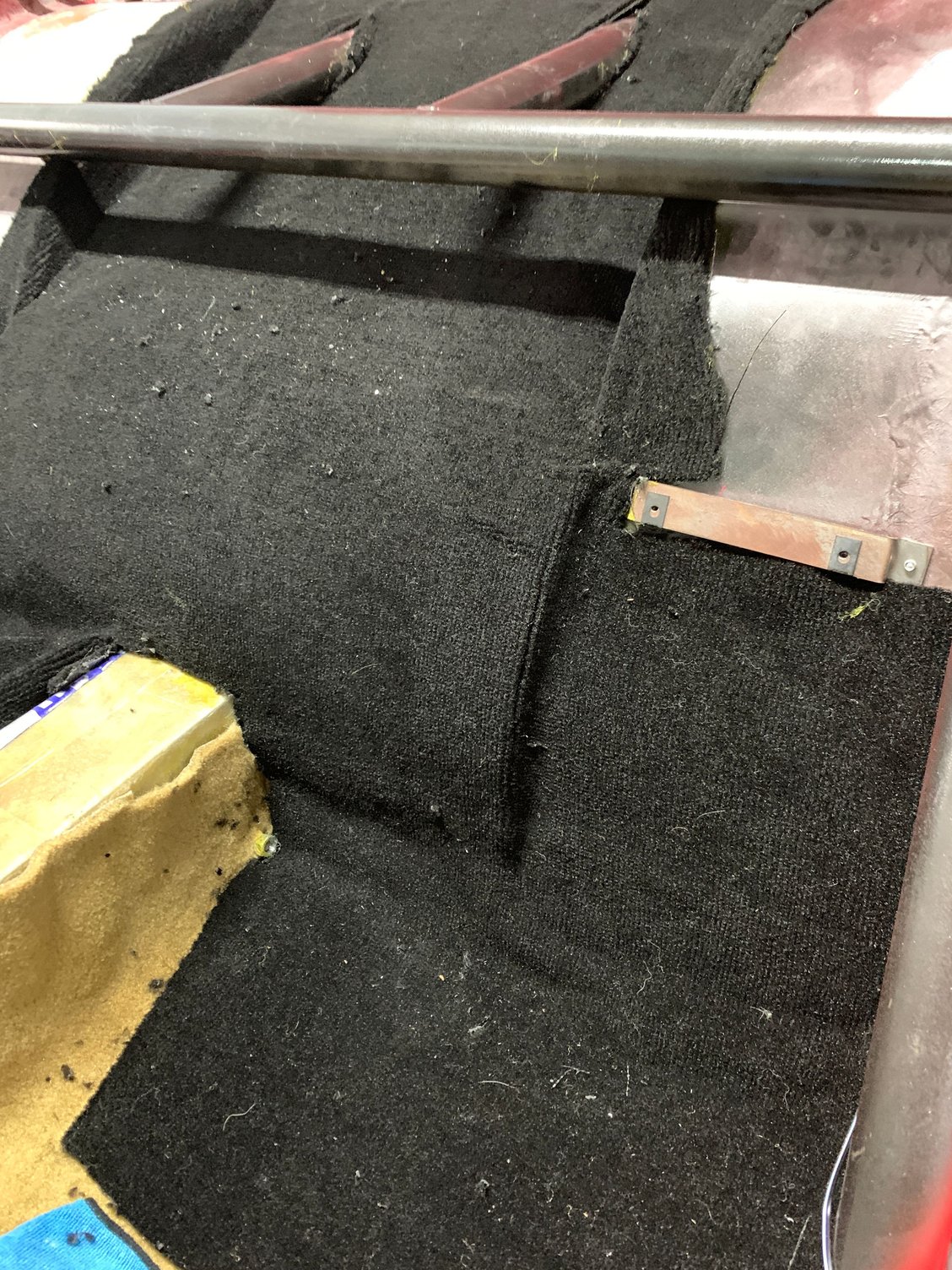

installed the wiper door and trim pieces, vinyl wrapped a couple panels and did some more Fatmat going over the center floor which will be carpeted

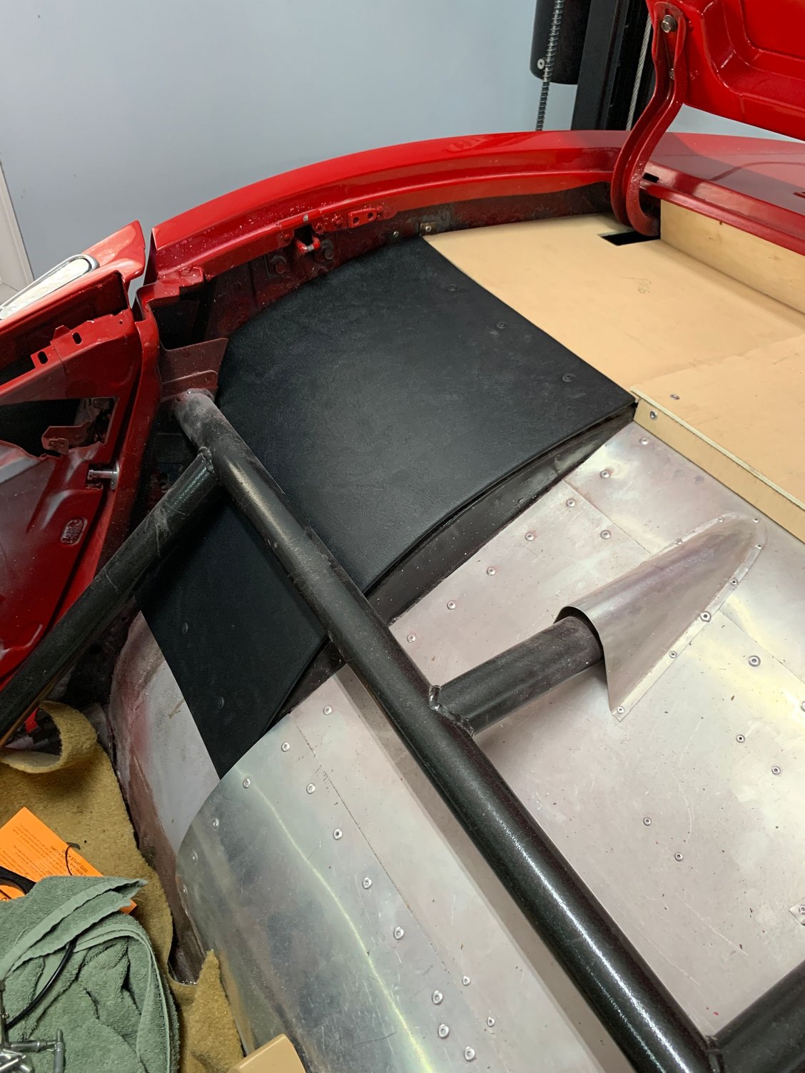

A couple more panels done today!

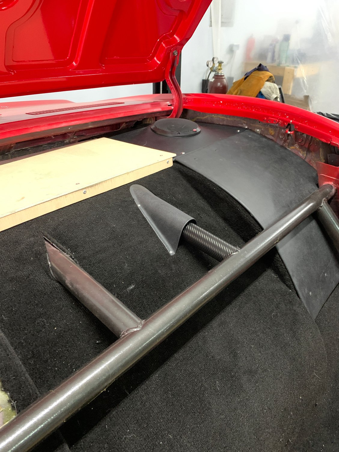

Ahhh- are you gonna wrap the whole rollbar with the Carbon fiber wrap?
I like the cover where the rollbar meets the carpet- I've cut mine and was looking for a way to trim it out- looks good!!!
I've got some 1/8 ABS plastic I was going to vacuum form and mess with.
BTW- my seats should be arriving next week- thanks again for the lead!!!
Richard
yeah, I think I will wrap the bars with that CF wrap. I had one spare piece large enough to try it as I wasn't sure if I'd like it...so far I do...and the couple friends that have stoped by to see the car also gave their nod of approval.

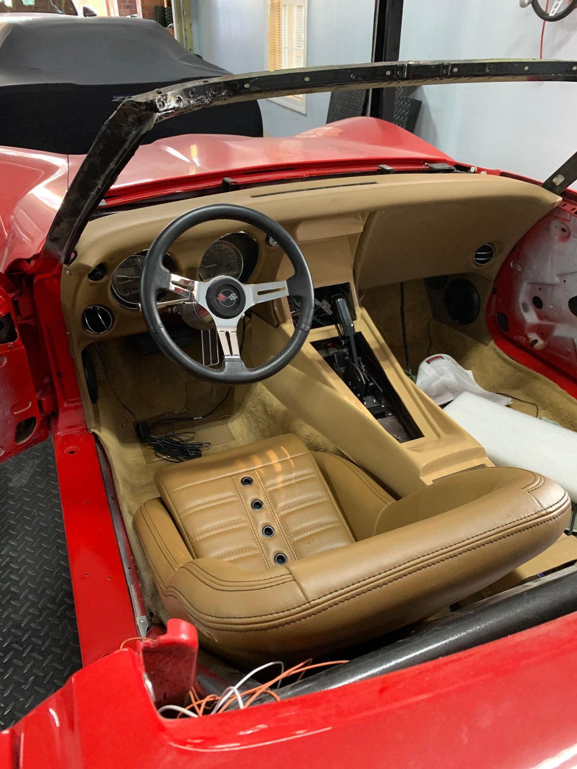

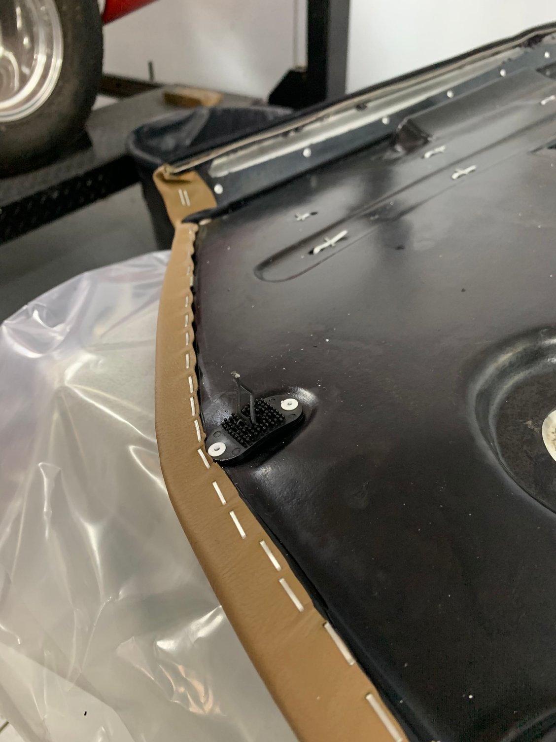

My answer to those silly plastic velcro like clips.... I added metal panel clips (drill rivets out, drill 1/4" hole in the center of existing clip, re-instal) and drilled a receiving hole in the door. Repeat 4 times around the door, and you get a tight, positive locking system while still allowing removal of the panel with no drama (I must have removed it 12 times as I was fighting the install of the door pull -yes 69 door panels on 68 doors, you don't have the upper door pull fastener bracket, had to make that).
I thru the seat in (not fastened) and added the A pillar cover to see how it all ties in...so far so good I think

I think I’m going to use your clip idea but with different clips. C3 door and console design is a pita in almost every way imo, lol.
by the way, you don’t have the rubber anti-flex/rattle donut on our door linkage rods. They might rattle. They go in the Chanel area. My old ones were hard as a rock. One on the inside too. I’m doing my interior now too or I wouldn’t know.

yeah the car didn’t have them when I got it either, I’ll get some for good measure! Thanks for the heads up!
