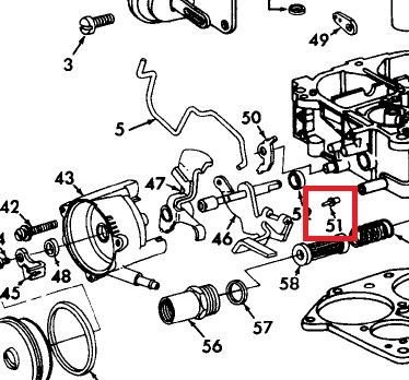

When you rebuilt the carb did you remove the aluminum choke housing #43 on drawing? If so did you install the small white plastic vacuum tube for your hot air choke #51? Your high speed setting should be around 1300 M/T 1600 A/T. I run my 77 A/T around 1400 rpm on cold start.
