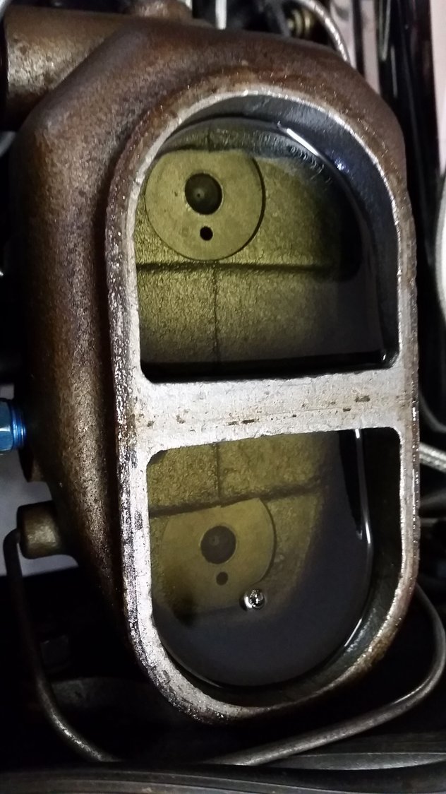

1969 car - running/driving until a year back when I started a 4 spd conversion and trailing arm rebuild. Brakes worked fine. So I opened the rear system for extended period of time while the arms were off. Now that all is reconnected I have ZERO pedal. I mean nothing - not enough to even bleed. It feels like just a swinging pedal can't make enough pressure to push fluid to the calipers and won't gravity bleed either. I've had soft pedal and sinking pedal but never zero. What to do?

I suspect the Master Cyl is full of crud. Pop the lid, take a flashlight and look at the brakefluid. I bet you can't see the bottom of the MC. Do you recall the last time the entire system was flushed? The "swinging pedal" sounds like the MC piston is stuck.

Crystal clear fluid in the MC. Not even cloudy. Since it won't gravity bleed I decided I'll just pull the MC off and mess with it on the bench vise. When I disconnected the 2 lines, no fluid ran out. Shouldn't brake fluid run out if the MC is full?

Ok. Just for the heck of it, take a line wrench and re-snug both brass line fittings at the MC. Or in your case, blue fittings.
Re-test for bubbles.
I don't want to be the one to tell ya, but . . . . . . . it doesn't look good.
Fluid looks pretty good buts lots of corrosion where the lid gasket rode indicating high humidity. What is the history on the MC? Original? Rebuilt? When?
