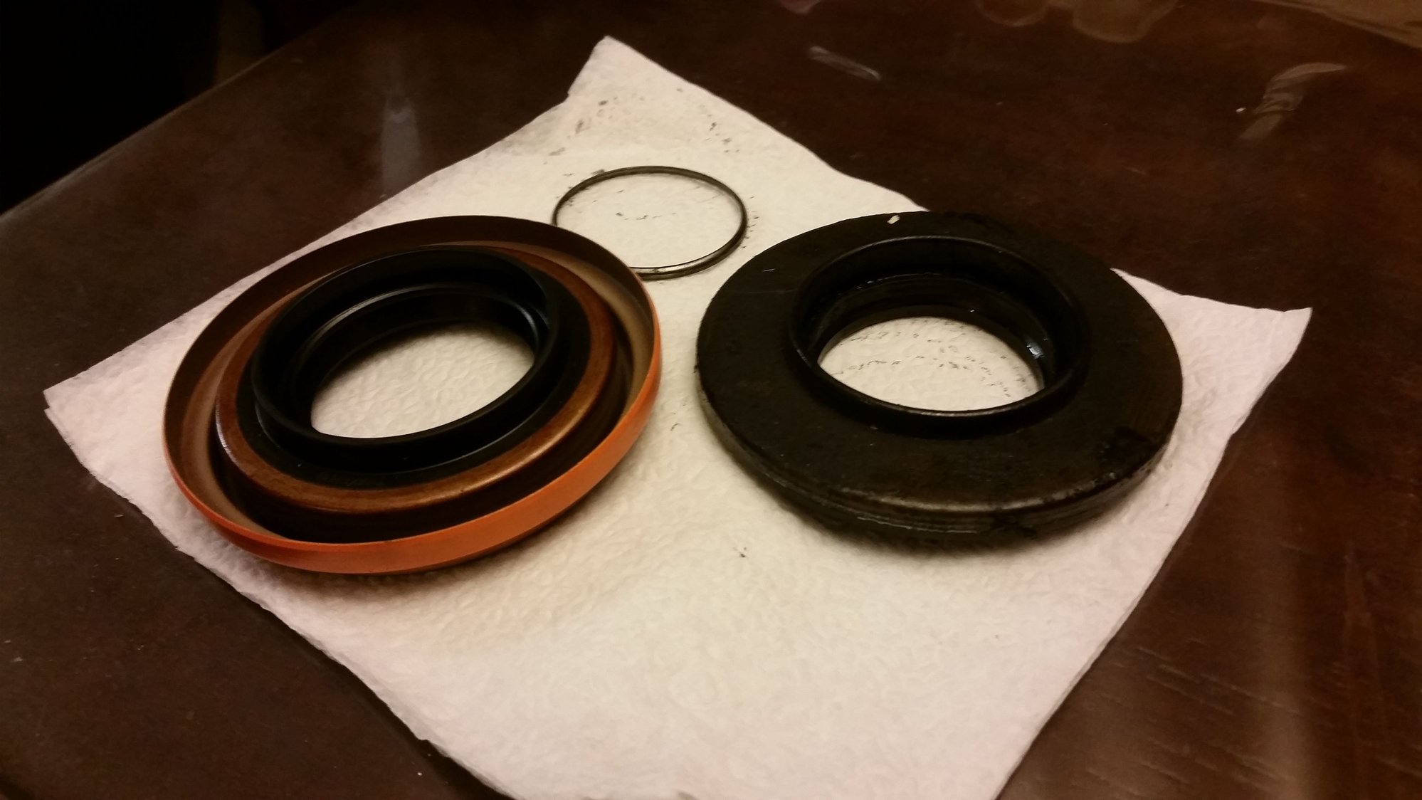

Thanks for the replies everyone. You're all right, it was 1 1/8". I pulled the old seal out and it doesn't look like the new Timken. Check out the pics below. It seems like it'll fit, but it's definitely shaped differently. Does it look right to you guys? The side with the spring does face into the diff right, just like the old seal?

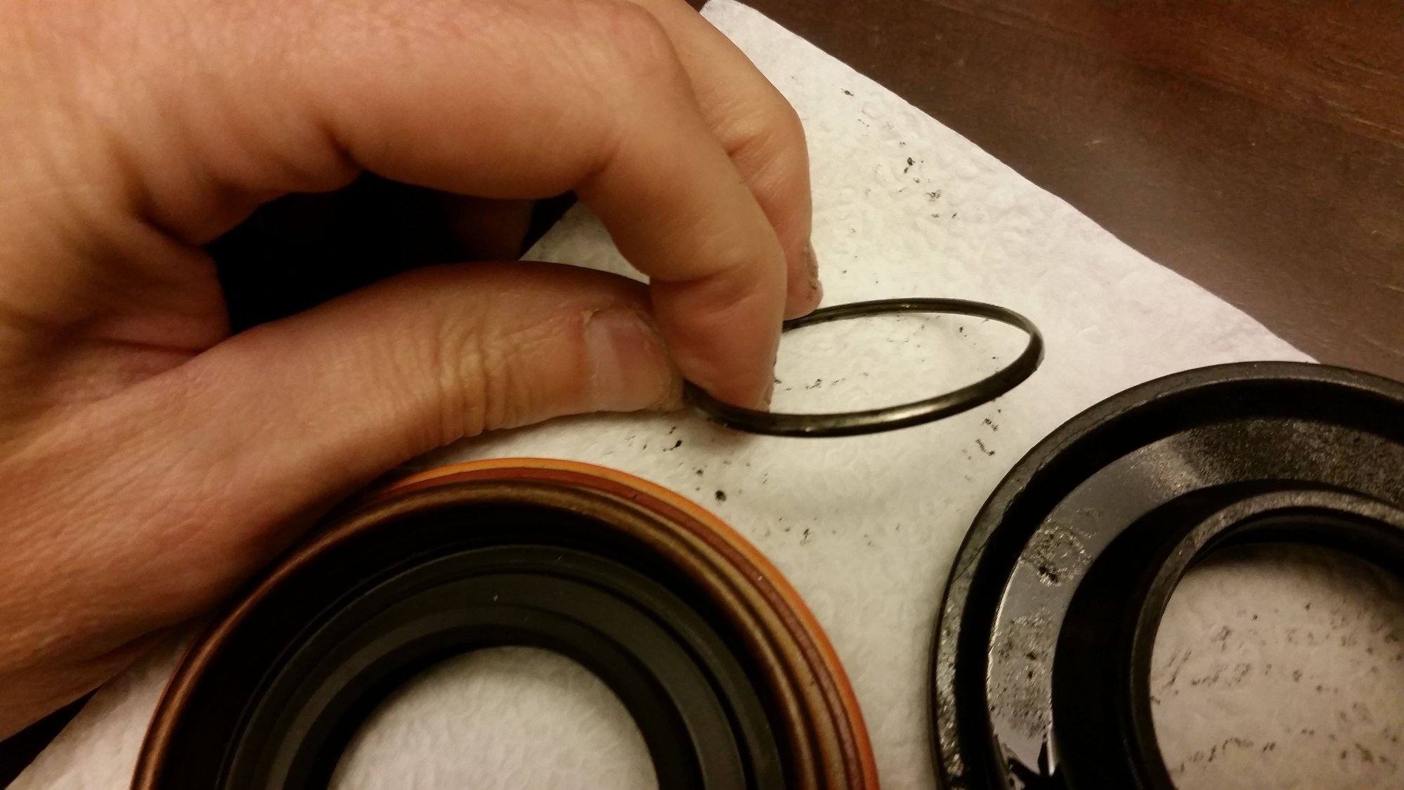

On a side note, right behind the old seal, between it and the bearing was a little ring I've attached a picture of. It was just kind of hanging on the shaft. I have no idea if it's supposed to be there. It doesn't seem like its in place. Does anyone recognize it? I'm thinking someone may have been into the differential before, as the bearing that's in it is a Timken bearing. I'm guessing those didn't come from the factory?

Im not sure about the later C3 Dana's, but that is definitely not the seal I just used on my '69. I believe my part number was Timken 8460N.
Old Nov 13, 2017 | 12:00 PM
GTR1999's Avatar
GTR1999
Joined: Aug 1999
Posts: 15,175
Likes: 3,986
From: Connecticut, USA
The seals for 63-79 are not the same as the 80-82.
