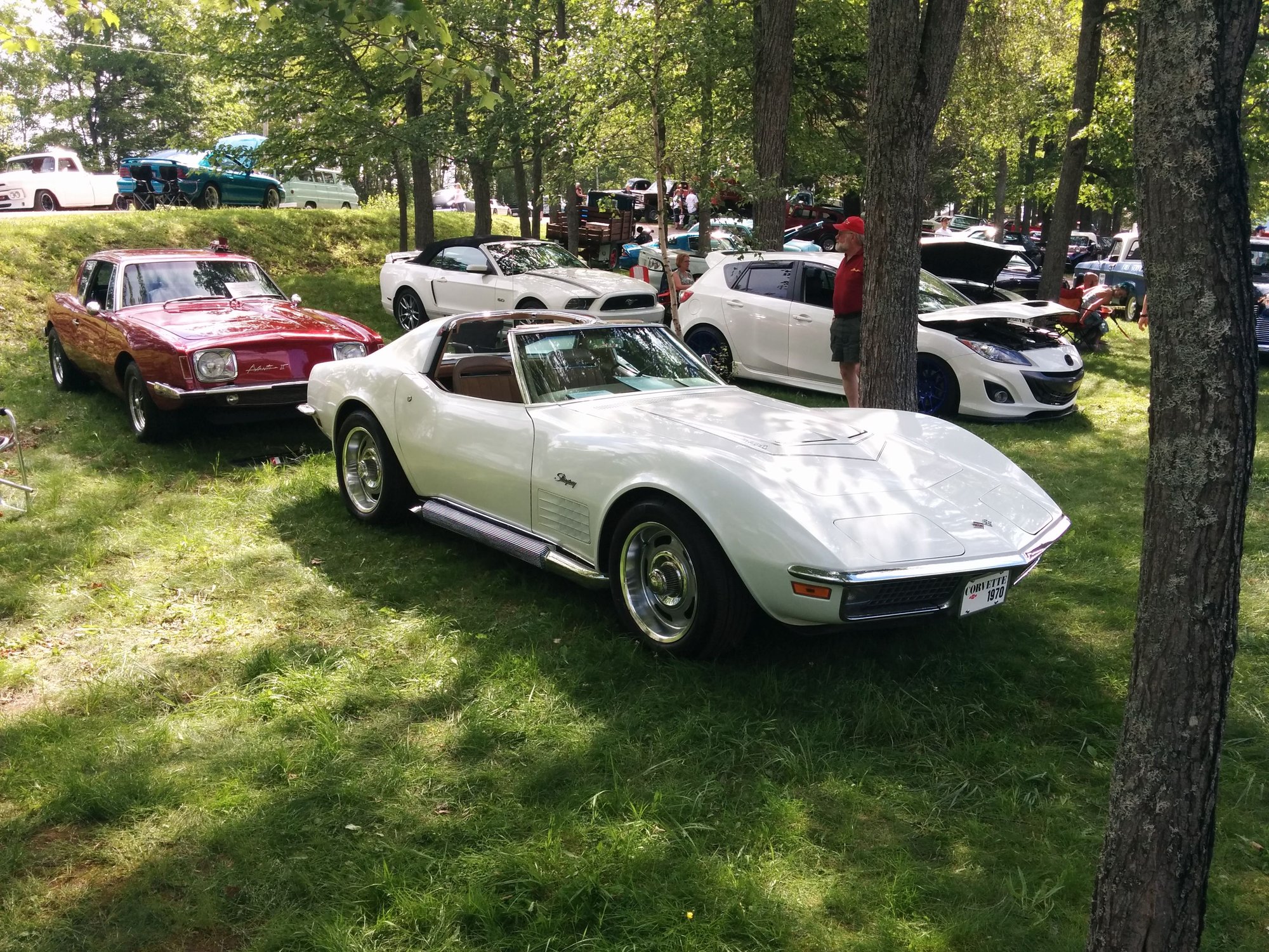

They will bolt on without any problems. I would check steering lock to lock for tire frame touch, mainly depends on the size of your tires. Many have installed these wheels without spacers.
In my case, I decided to go with 1/2" spacers. Then you need longer wheel studs.

excuse my ignorance but what is that car behind the corvette? that is gorgeous

That's a Studebaker Avanti.

As Bikespace says, it's an Avanti.
It's my Brother's car, and officially it's a 1975 Avanti II. Still a fibreglass car. When Studebaker folded, Avanti continued under different private ownership.
My Brother's came with the original 400/4bbl SB Chevy, 400 TH Auto and original Studebaker Dana rear.

Barry's70LT1 - Your car looks really good with them on it. I'm liking that look more than stock 15" rally wheels.
Thanks, I have no regrets, amazing improvement in driving with the 17" and Michelin's.
