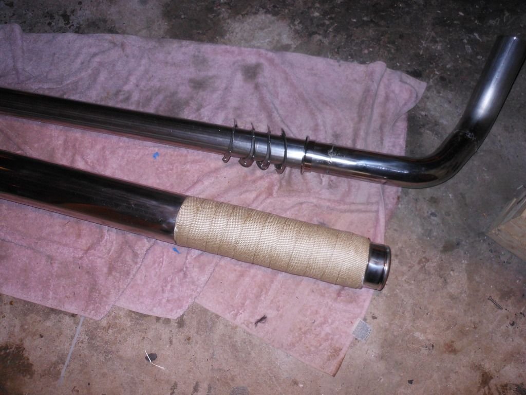

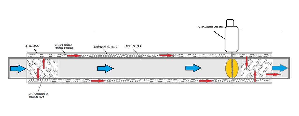

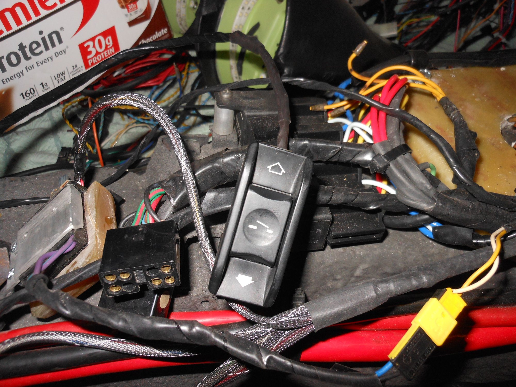

Here's how I did mine-
Basically my system is 2½" straight pipes that I can add a muffler to quiet them down-

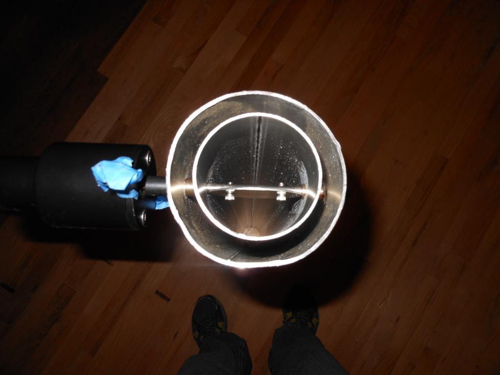

I'm using a w/ a toggle of a switch- well actually a sunroof switch that resembles opening and closing!!!
I have a SS 304 straight pipe 2½" inside a 4½" SS outer pipe. The straight pipe will be opened/closed by a QTP electric cutout motor.
For the motor- I used some bronze valve guides-cut down and stepped to hold the stainless steel butterfly in place. Just need to make some standoffs to mount the motor.
QTP motors-

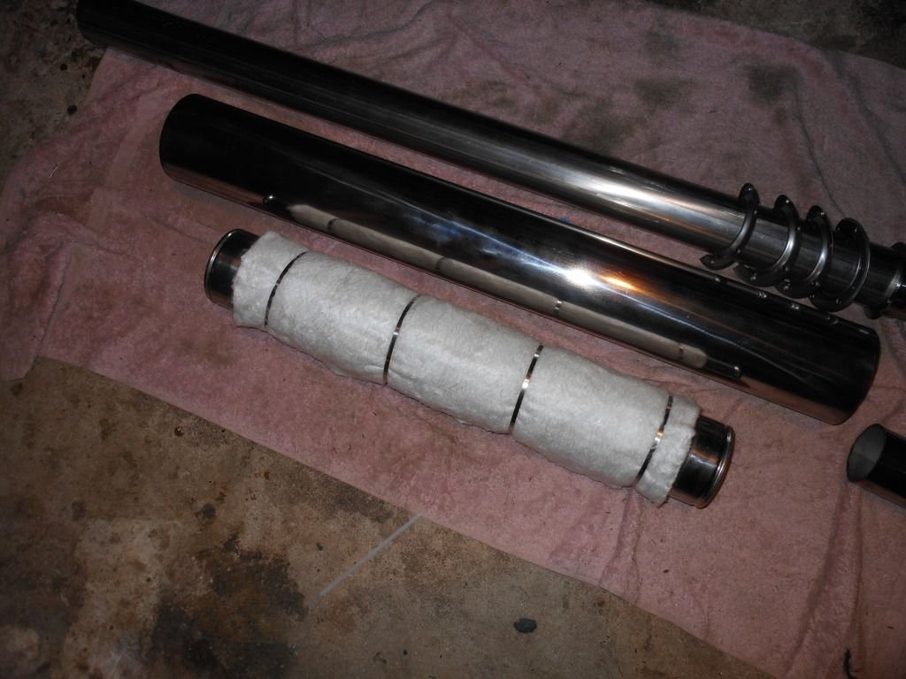

Design-
Close the straights- and I'll have a 2ft glasspack muffler

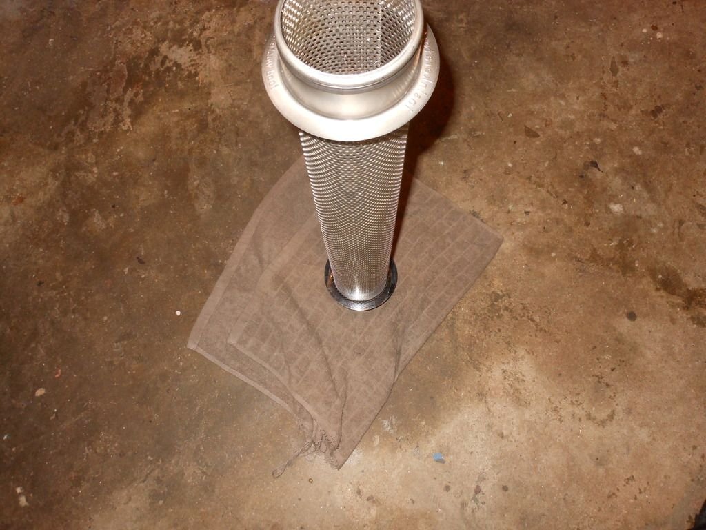

Glass pac- perfed SS and a couple SS insinkerator garbage disposal flanges for spacers...
Exhaust packing-

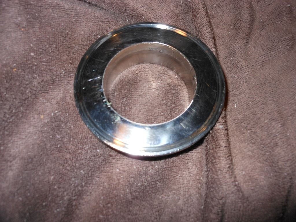

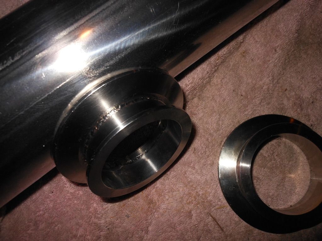

And V-bands to hold it together-
