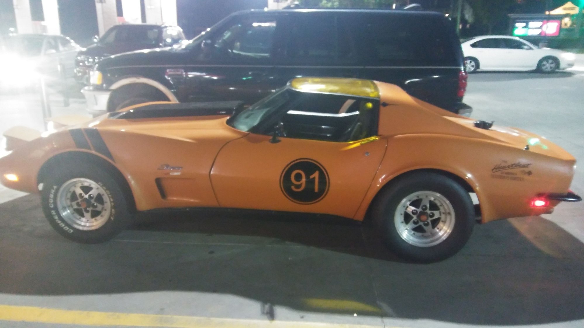

I wanted to know if anyone was running a set up like this?
Front 235/70/15
Rear 275/60/15
Factory Rally Wheels
Here is the open door:
Why or Why not?

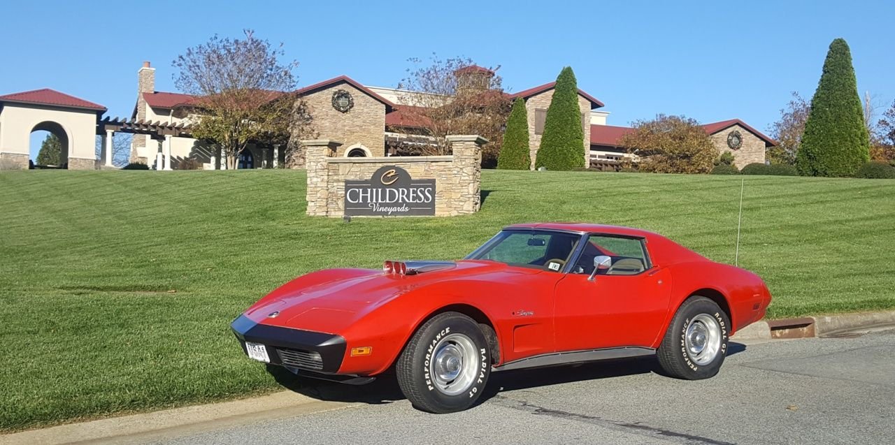

Originally Posted by mudtime
factory 4-speed; 350, .60 over, upgraded cam (not sure right now which one) it is written down at the house, camel hump fuelie heads, 650 double pumper, Air Gap intake, Flowmaster exhaust. Rear is stock I need to crawl under and get the letters off of it for the ratio. I do like the look of the 275/60 and 245/60. Are they on 8 inch wheels?
yes they are on an aftermarket 8 inch rim thats same backpacking as orginal wheels. this is an old pic but still need to cut those front springs lol
