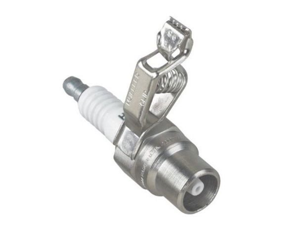

An inexpensive tool to have in your tool box will let you know if you have a spark or not....and the intensity of the spark also by how the spark looks.
You can also make one out of a good spark plug and a section of wire. Does the same thing if you do not want to spend a few bucks.
And YES...using a screwdriver also works while having someone turn the engine over works..as long as it is a good insulted screwdriver. Not responsible if you shock yourself using this method.....hence..why I have my tool.
DUB

Very clever. So how is the gator clip attached, a little sheet metal screw?
Maybe spot welded?

Spot welded....tack welded or silver soldered or brazed...regardless... it is attached so the clip is able to ground it out.
The same would hold true if you stripped off some insulation on a wire and wrap it around the metal portion of the spark plug and grounded it.
Like I wrote..I like this design due to it not having an electrode in the center...when it sparks...it goes to the side on the spark plug and you can really get a good look of the intensity of the spark.
DUB
