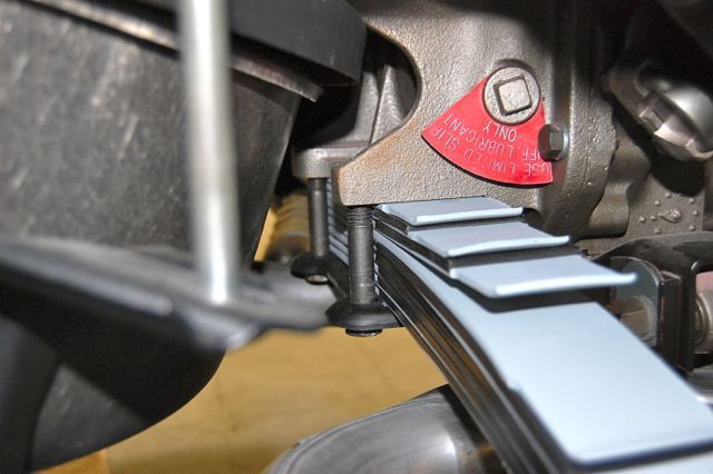

My 79 with a 2 1/4" gymkhana spring in a 2 1/2" carrier with shims(one in front also).
Original in my 79.
