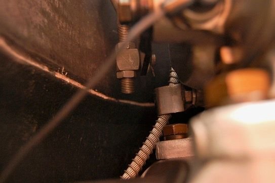

Here's the bracket on the transmission. Look for it at the upper bolt that bolts the transmission to the bell-housing.... just above and to the rear of the clutch fork.
