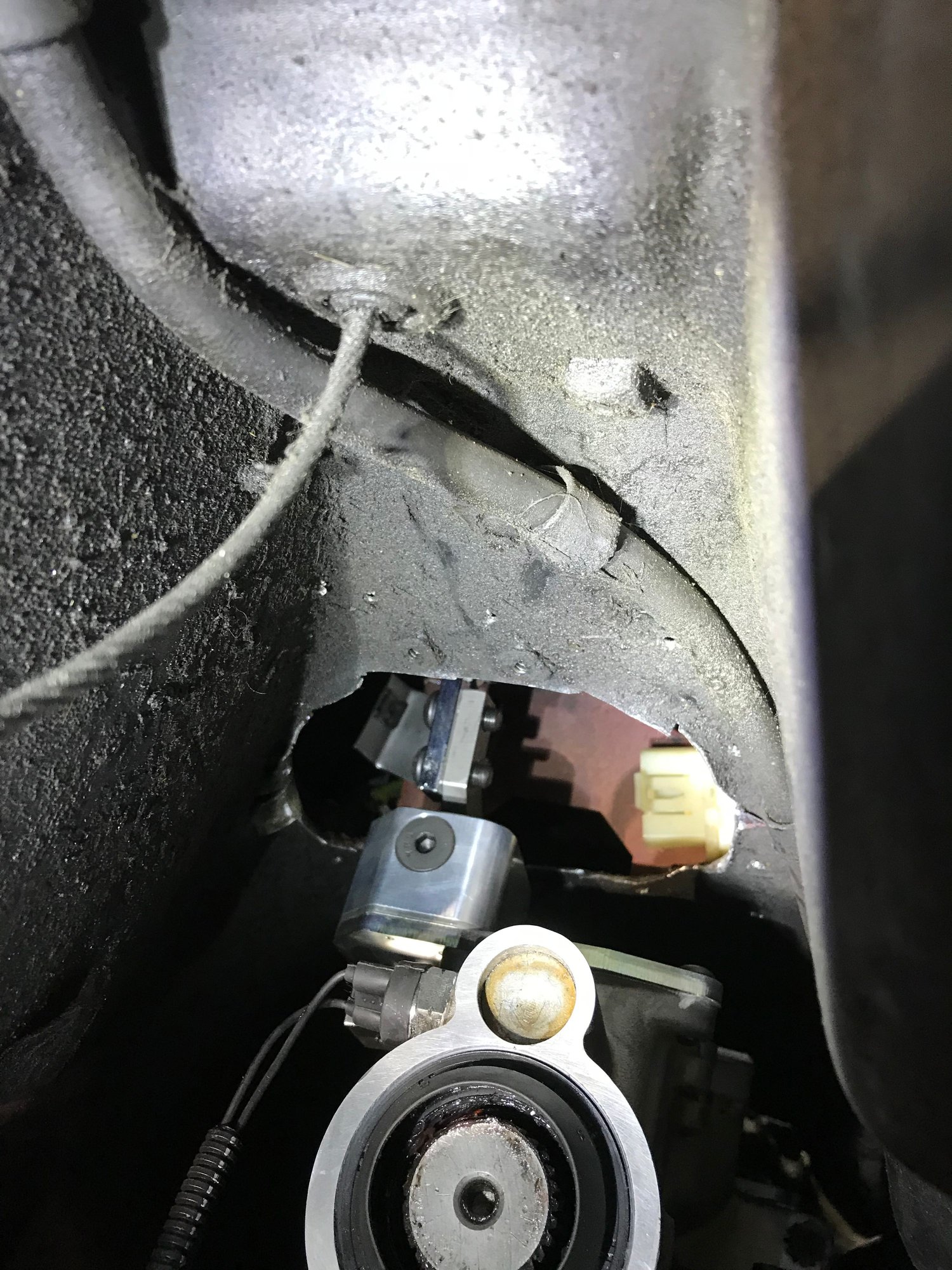

OK another productive session last night. Got the cross member installed. By the way, that thing is super nice - very heavy duty and well made. And I reinstalled the shift tower mostly from above through the hole. I was a little concerned about the shift tower, whether I was going to be able to reattach it after removing it. The directions say to remove it which I did, but I wasn't sure if there would be enough room to reattach it after the trans was installed. But there was plenty of room. So I got that all back together. Then I installed the drive shaft, which was included - again a very nice piece. Uses Spicer solid U joints.
So the trans is in and all major things are connected. I just have to hook up the reverse lights, and speedo cable. The neutral safety switch won't be able to be hooked up because I never hooked it up at the clutch way up in there, so that's OK.
pics:
shift tower from below
shift tower from above
trans jack from HF lol
cross member attachment
my metal plates
drive shaft at trans end
another view of the cross member
