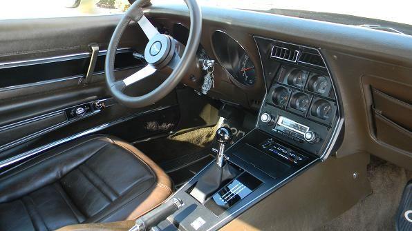

Old Dec 8, 2017 | 11:14 AM
c3_dk's Avatar
c3_dk
Joined: Jan 2008
Posts: 3,795
Likes: 435
From: Aarhus, Denmark

Heres my modification to the rear mount. You can see where the rubber pad bolts to is now tilted, so the trans is straight up and down in the tunnel.
Quote: I do not abuse the drivetrain now and roll into the throttle always...no clutch drops ever!
Then you should get many years service from a WC T5.

UTSo you made an offset mounting pad for the shifter stick so that it moved it to the left a bit? And that is a side view of the shifter not a straight from the back or the front? I knew I needed to buy another welder. Man it sucks to have to buy tools.
