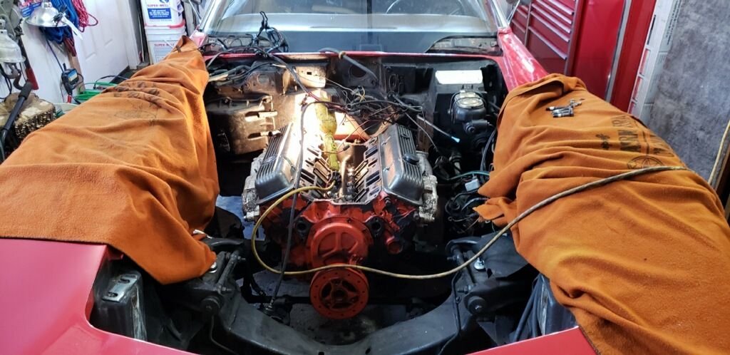

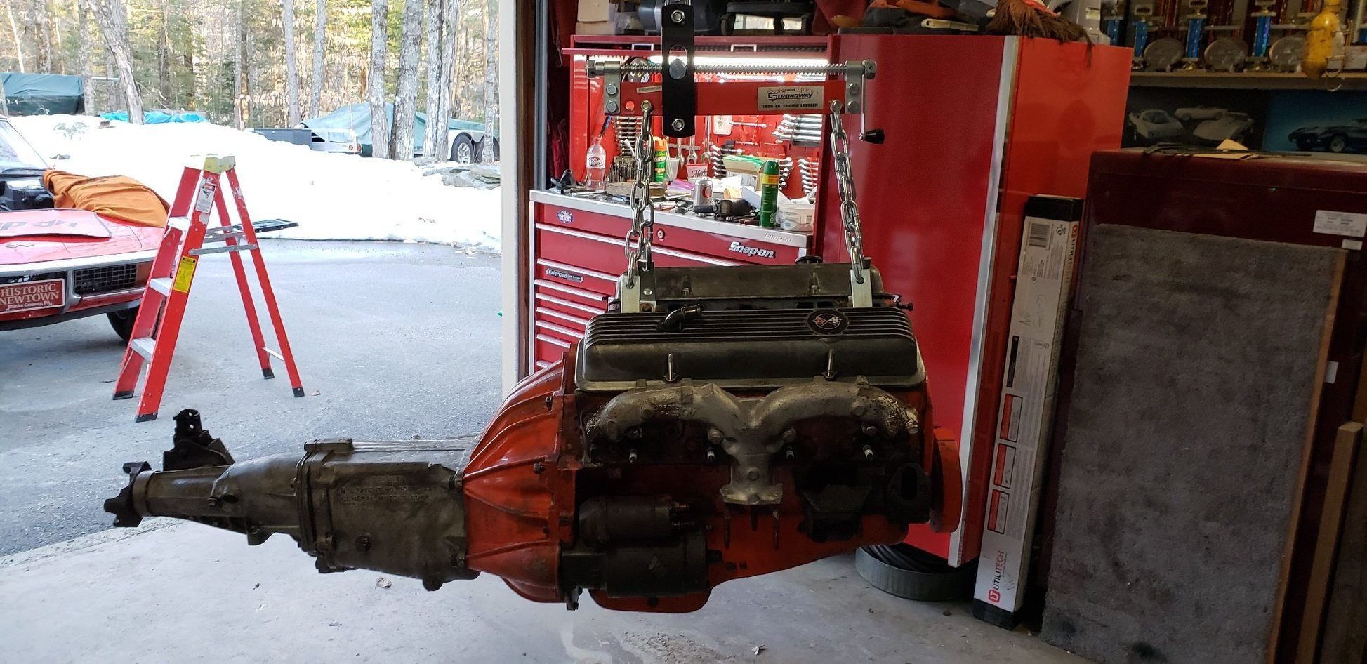

Pull it as a unit. We pulled Scott's 454/M20 as a unit and dropped in the 496/TKO-600 as a unit. No problems wrt the whole process. Make sure to have a friend or two to help.

Is it a small block? You can pull the motor and tranny without removing the core support. Pull the hood and the radiator, plus fan. They can be pulled as one unit.
