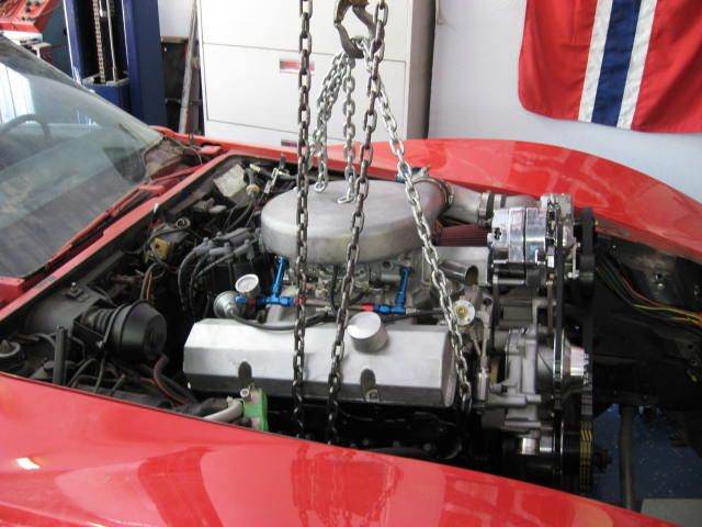

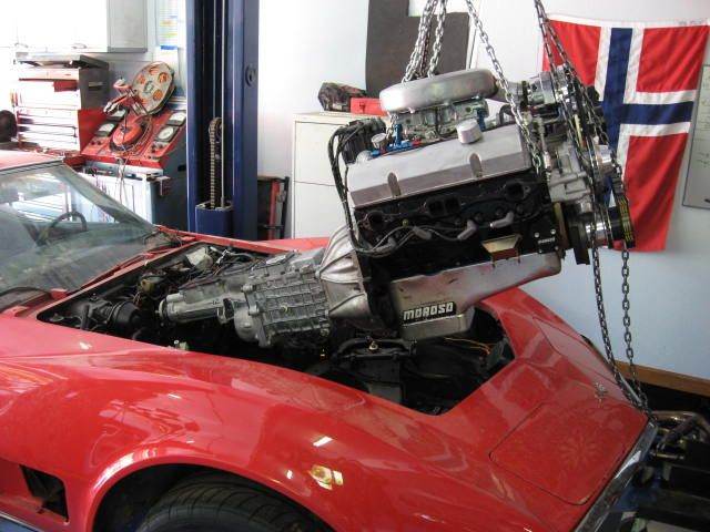

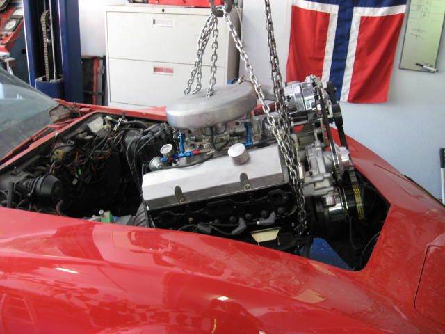

You can install a small block with all accessories and the stock tranny without removing the core support. You can also install a big block with the tranny, but with the accessories removed, without removing the core support.
However, the core support is very easy to remove, and with the support removed, you can stuff anything you want into the engine compartment... Here is a 383 with a Tremec 5-speed (which is longer than the Muncie) and all accessories, including supercharger, being easily installed into a C3 in my workshop. I would never want to try to stuff that tranny up from the bottom after the engine was installed:
