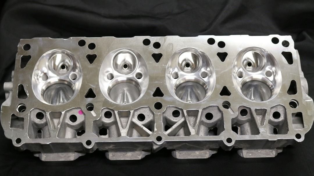

Here is a Dodge Hemi head. It does not have a hemispherical chamber, it is a bathtub, one of the most efficient chambers because it has quench areas on both side of the chamber.
I've done a lot of work with bathtub chambers. They always make more power with tighter quench or squish as some of us call it. In race engines I would tighten the squish until the piston and heads would just start to get leave traces of touching each other and then back off a couple thousandths. Set a lot of records with tight squish.

i dunno what hemi head that is, but this is the one NTO is talking about. and...you are both right. quench is necessary for good even combustion and improves power. but there is an exception to every rule. no big block chevy can beat a true chrysler hemi in top fuel. they stopped trying a long time ago. maybe the big domes form a quench area, but there is no shelf on top of the head next to the combustion chamber.
Old Dec 14, 2017 | 02:04 PM

ok, the flats facing the valves may serve as quench pads. i have no idea how close to the valves they are at TDC.
That is a late model Mopar Performance Hemi head. Nitro is a different animal. On the blown engines the large hemispherical chamber lends itself to the low compression needed to run high boost with massive volumes of nitromethane injected.

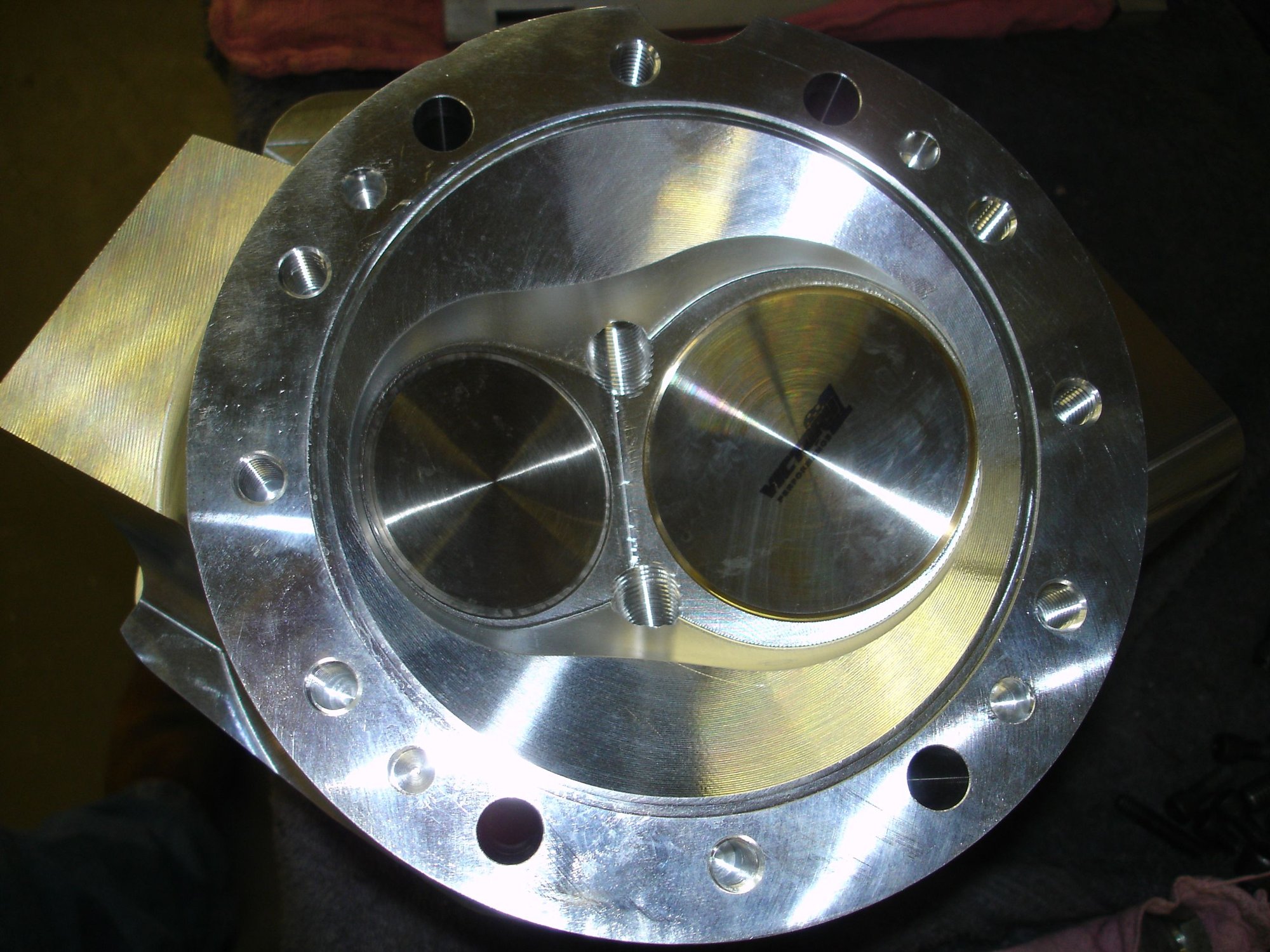

I ran naturally aspirated nitromethane in my Top Fuel Harley. I had bathtub chambers with a 30 degree squish. I ran the squish very tight. Because of this and other things I did to make my engine more efficient, I was able to run less percentage of nitro and less ignition timing. I had no problems with detonation and had very few engine failures, unlike a some of the other fast guys. I also usually ran much higher miles per hour than my competition.
The Billet Top Fuel heads I designed in 1994 are still in use today. They have been on record setting machines and won 5 national championships at IHRA in a row with two differents teams when the Harley's were at IHRA. Doug Vancil ran 6.26 @ 225 about 18 years ago with these heads. These heads had a bathtub chamber with a 30 degree squish and a domed piston to match.
My current Top Fuel heads also are bathtubbed. We ran them at Bonneville in the streamliner and the engine was a beast. We ran 222 MPH in first gear at part throttle testing, but unfortunately, my partner Leo Hess crashed and got hurt on a later pass. A couple of guys are building new bikes with them on them, but haven't made it to the track yet.
Mike
PS: A photo of the chamber. This is for a 5" bore. The valves are 2.500" and 1.980".
