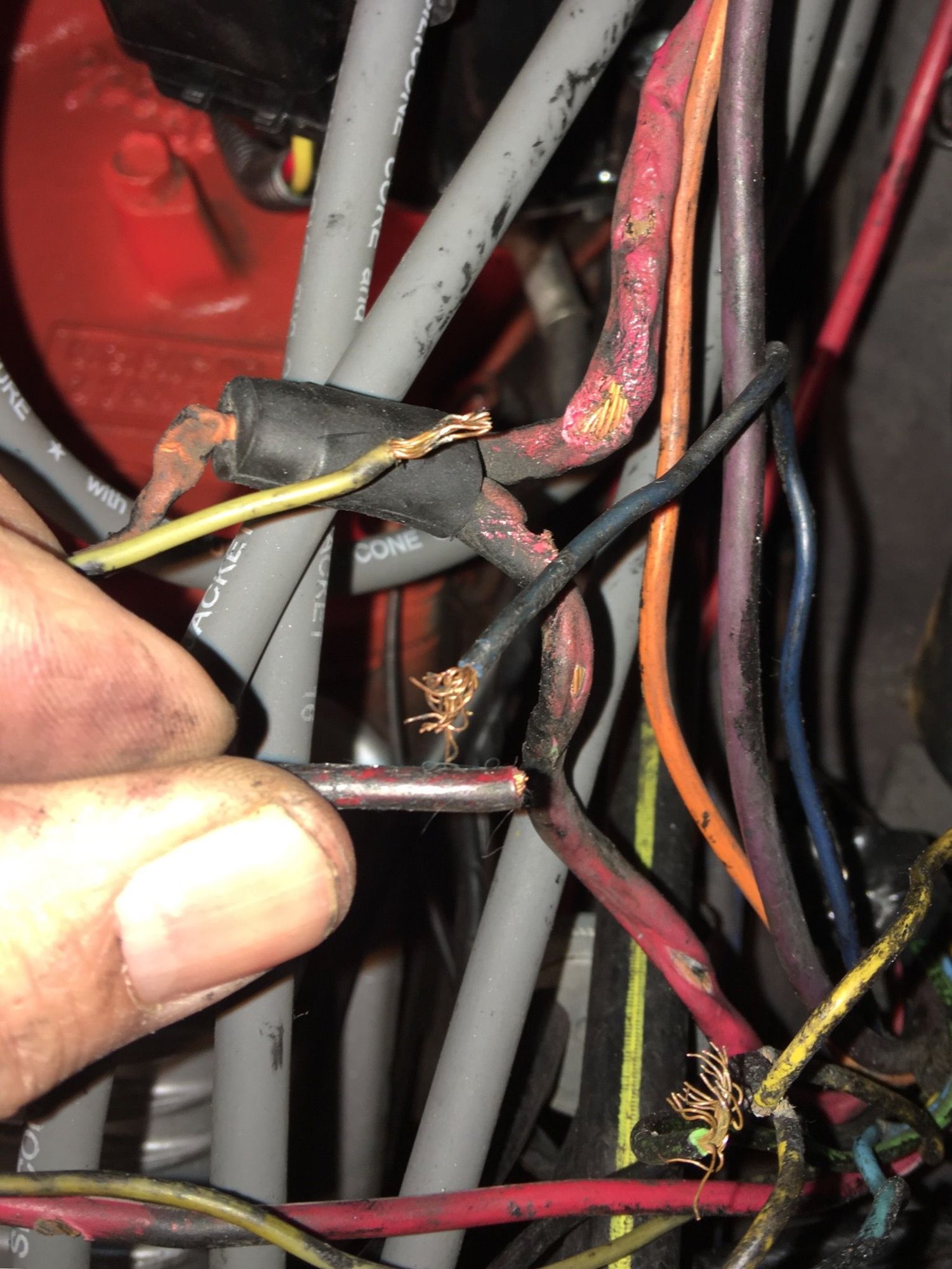

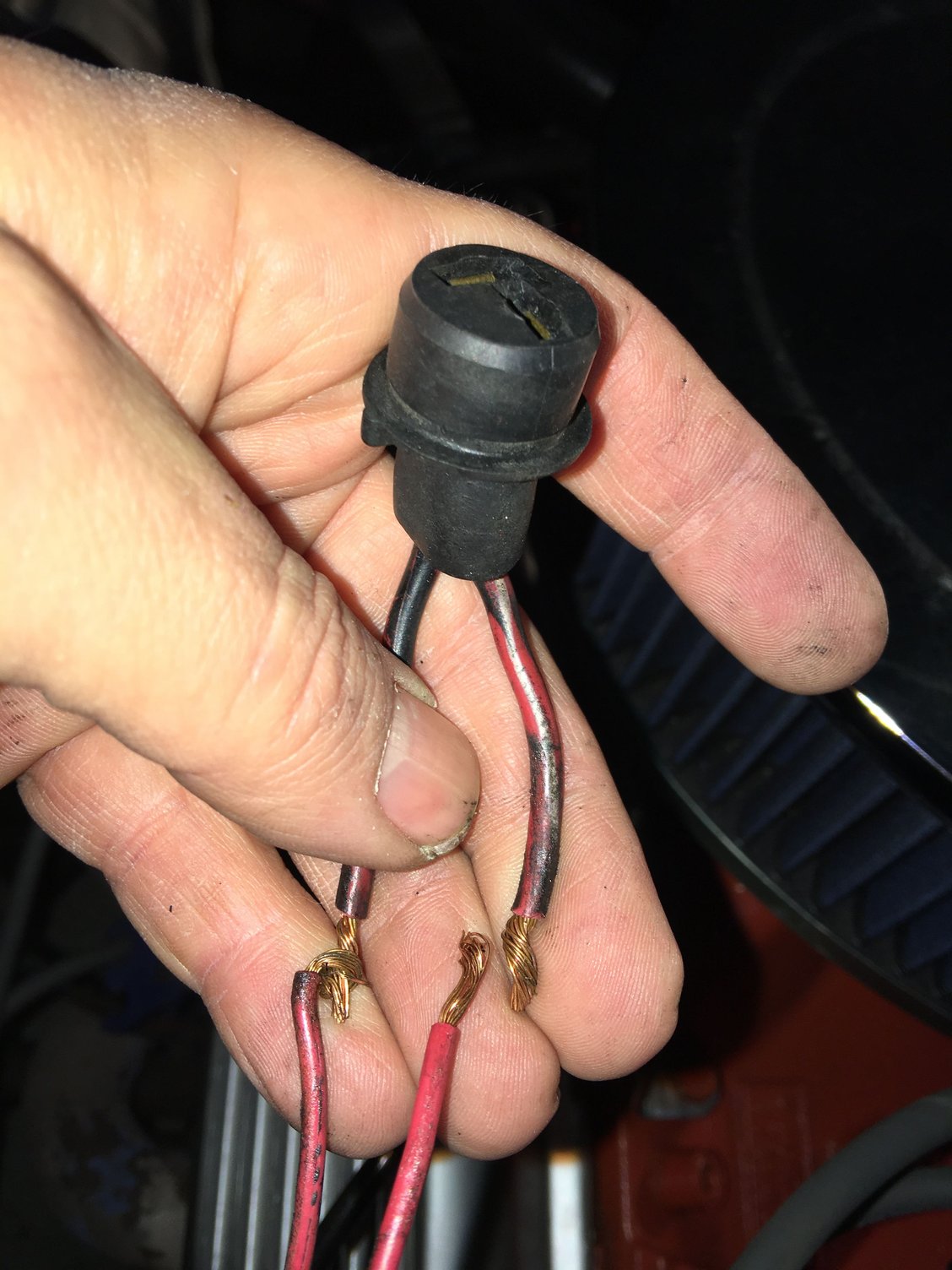

I guess the best thing to do is rip it out and install a new engine harness.

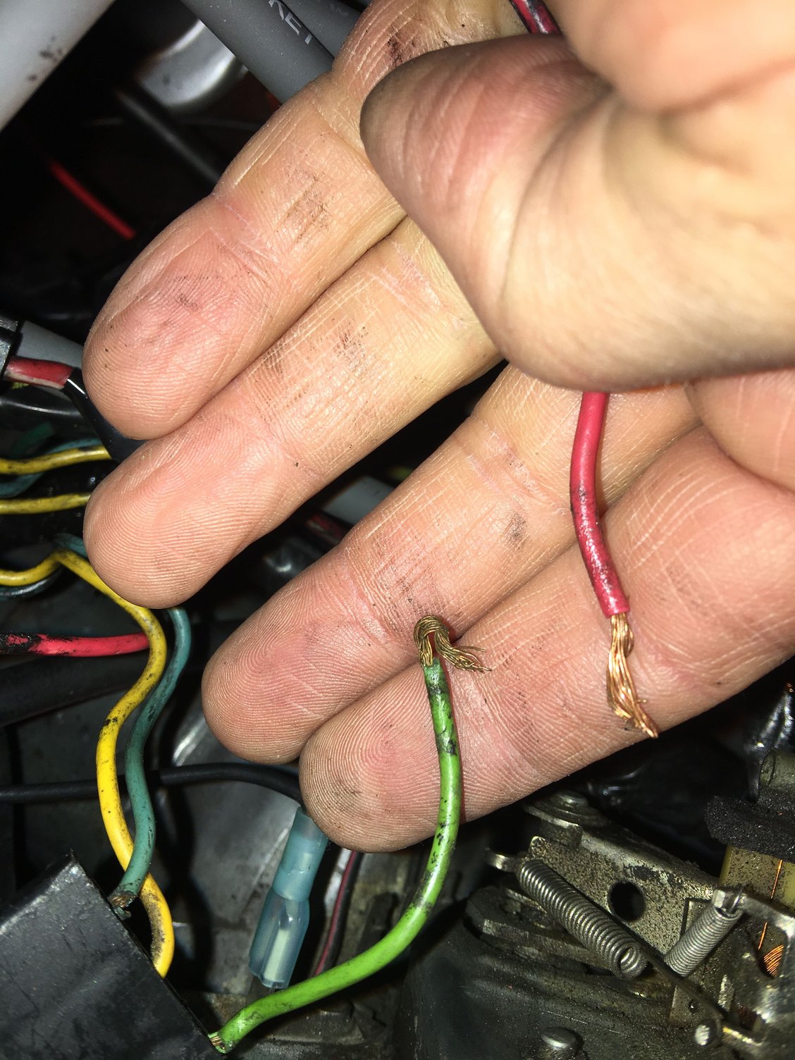

It’s a wonder it drove. The ignition (red) wire was twisted and wrap-taped to the light green from the wiper. The wiper door safety switch works... but it also was twisted on.
never quite seen seen this level of half-@ssery.
It’s a wonder it ran. It’s a miracle it didn’t catch fire.

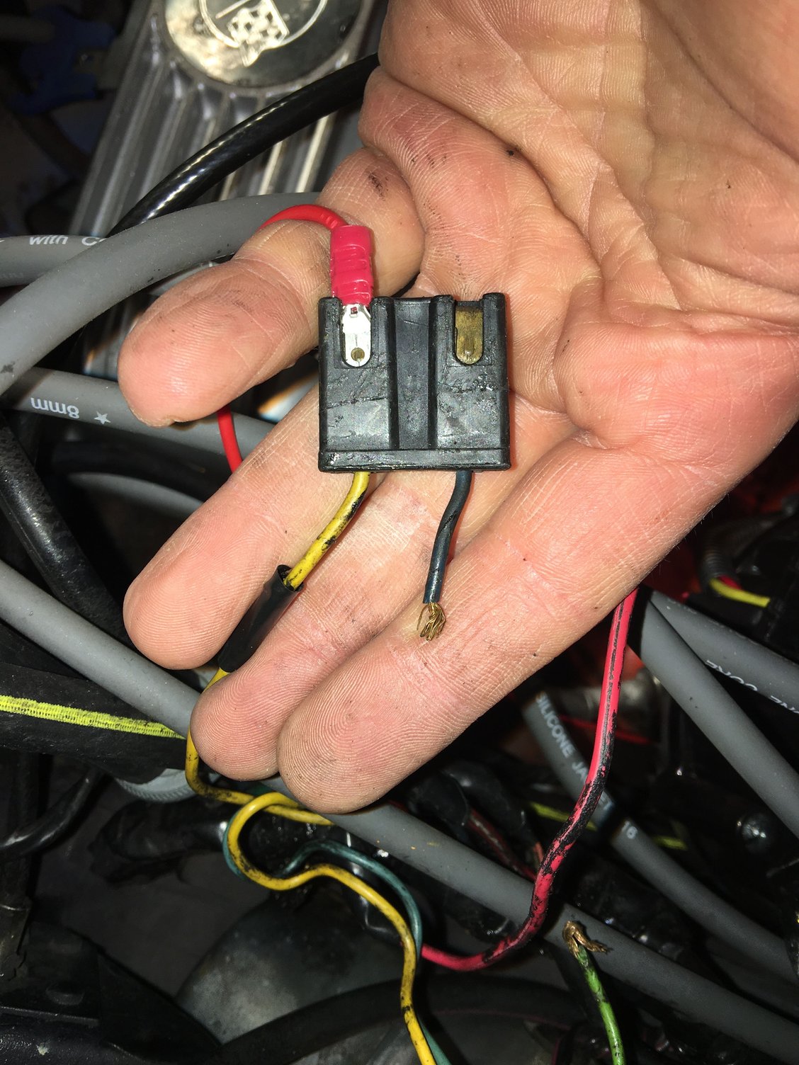

The fusible link looks... like it fused a bit.

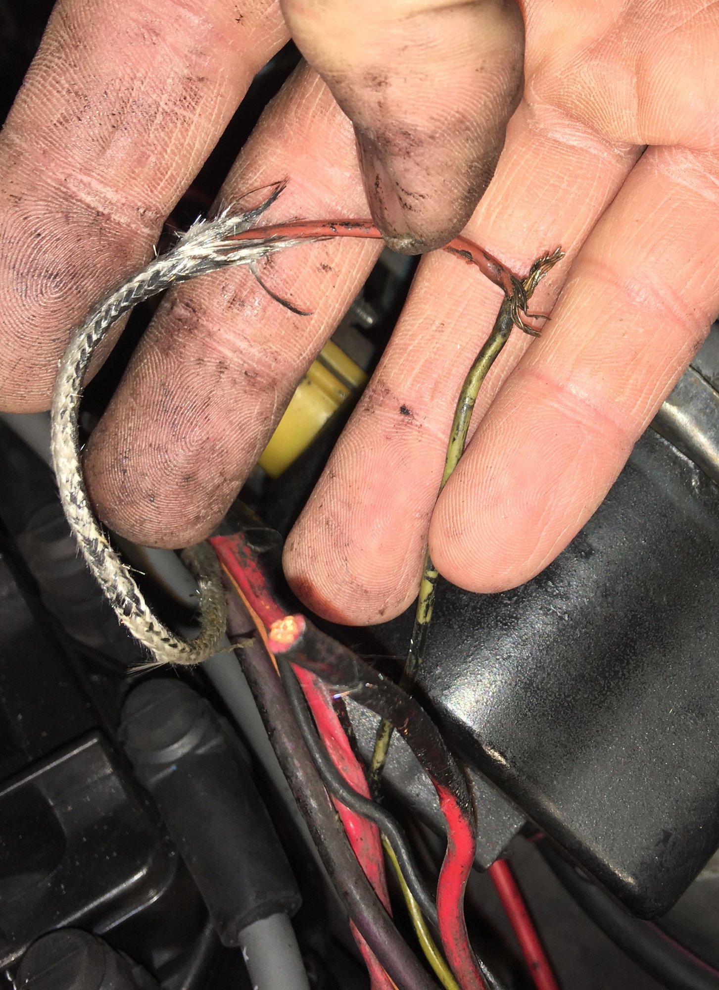

is that braided wire you're holding your resistance wire? If it is check to see how many volts your getting to the coil.Too many volts and you'll burn your points.If you're running an aftermarket dizzy with electronics you should run full volts.
I have no idea what that is. This came with a coil-in-cap style HEI. And yes. I think it’s best to yank it all...
Voltage is irrelevant. The resistor wire limits the current.
This misconception just won't die.
