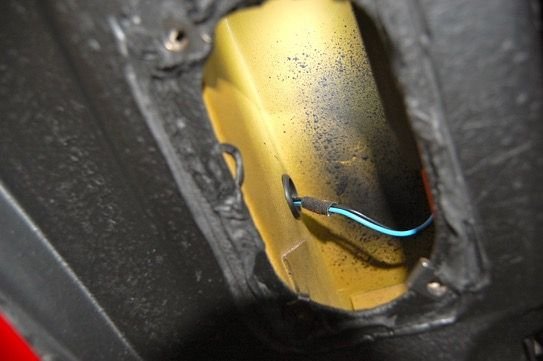

Can someone tell me what the rectangular inspection ports outboard of the trailing arms are for? Do they come off easily or after removing the 4 small bolts do they have adhesive sealant holding them in place.

Those holes are for access to the rear door jamb switches and their wiring.

Also the body mounts...They do have adhesive on them.

Hi,
This is what you see with the little panel is removed.
The #3 body mount is at the bottom as Brian described.
The sealer is similar to black 3M Strip Caulk.
