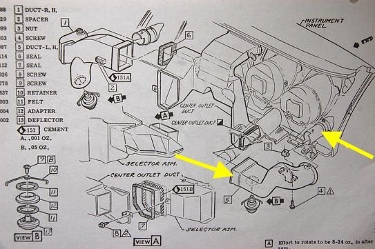

If so, it appears part of the duct work is missing (or at least not installed properly. Part #5 in the drawing.
If missing the duct looks somewhat like this.

It directs air to the round vent in the corner of the dash pad.
This drawing is from the Assembly Instruction Manual. It's referred to as the AIM... do you know about it?
