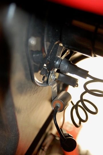

Going through the wiring I found four things that I either could not certainly identify or just did not know what they are.
The first was under the hood. I suppose it was connected to the blower (that looks like orange wire). It looks like a capacitor ? Or designed to inhibit noise for radio ?

The first and last pictures look like noise capacitors.

The parts in the first photo are the electrical connections (cut up) for the heater/defroster blower motor.
One of the parts is a capacitor that only radio equipped cars had.

Awesomeness. Thanks! Super helpful pic. (

The first photo is looking in through the opening in the fender for the side grill.
