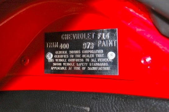

Here's an example of a VIN tag found on the driver's side windshield pillar.
You look through the gas to read it.
A Trim Tag.
F14 indicates January 14th.
