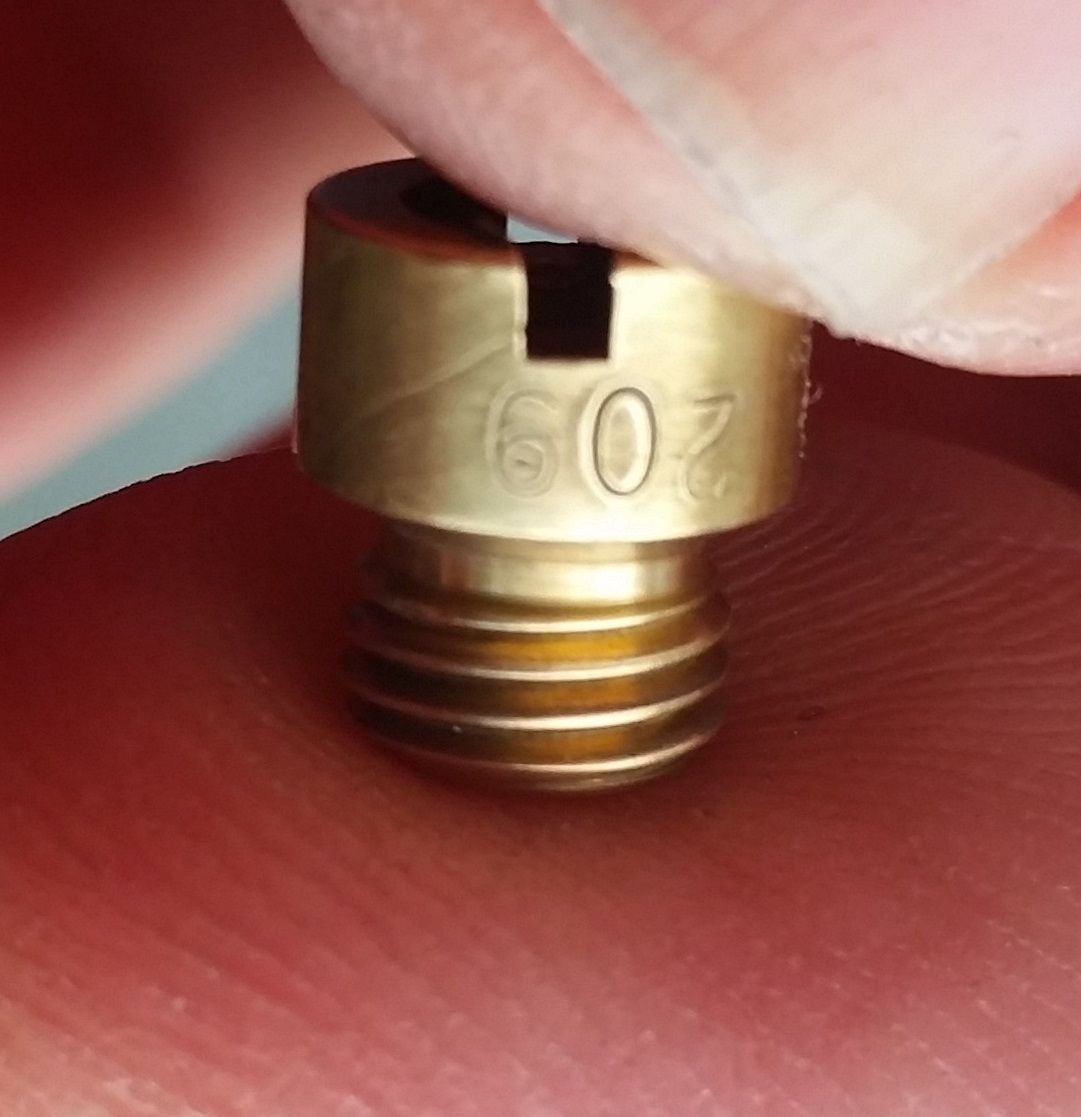

Originally Posted by HeadsU.P.
You are hanging out with the wrong crowd. First you have the incorrect mix-match metering gaskets, and now odd size idle mix screws. You need to start all fresh with a reliable company that sells the correct rebuild kit. I would question the needle valve & seat, floats and jet correctness too.
Indeed I am.
Power Valve was a 6.5
Primary Squirter ... 37
Secondary " ......... 25
Primary Jets ....... 209
Secondary " ......... 86
Steve

Originally Posted by Cavu2u
Indeed I am.
Steve
Never heard of a 209 jet. Check again.
Old Dec 29, 2017 | 11:11 AM
TimAT's Avatar
TimAT
Joined: Oct 2006
Posts: 7,123
Likes: 433
From: Gladstone MO
209 = Alcohol jet maybe?
I know! Sounds weird. I ran 0000 steel wool to clean em off, and they're a dark color, or really stained bad. 209 is what they say.
This Carb is a trip.
Steve
Maybe Tim. Who knows for sure?
Steve
You are reading it upside down. That is a "602" jet, actually a 60-2 jet, which is a precision #60 jet at the middle #2 flow rate (#1 least, #3 most). Those usually came on the spreadbore carbs sold as emissions certified replacements.
I've got several 60-2's from spreadbore carbs I have rebuilt.

Old Jan 6, 2018 | 01:10 PM
Cavu2u's Avatar
Cavu2u
Joined: Oct 2013
Posts: 2,569
Likes: 126
From: San Diego California
I ain't sh*##n' ya folks.
Old Jan 6, 2018 | 01:24 PM
Dynra Rockets's Avatar
Dynra Rockets
Joined: Oct 2012
Posts: 1,152
Likes: 252
Fixed it for you. It's a 60-2. Google "Holley jet Close Limit 60"
Makes perfect sense. Perhaps the die stamper was hungover that day, or there's some ingenious reason to stamp it UPSIDE DOWN!
Thanks much Dynra.
Steve
