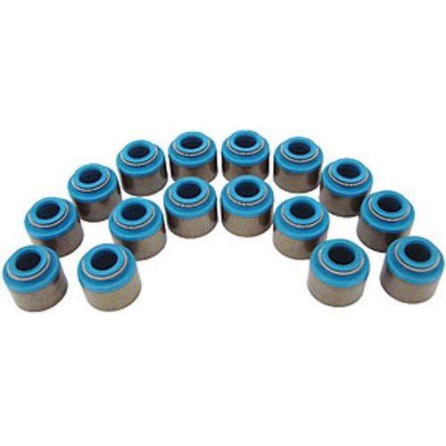

In order to switch to Beehive or Conical springs I need different spring locators (I guess because the inside diameter of the spring is a different diameter), this means removing the blue rubber-ish looking valve seals (Viton?) they look like this picture: http://www.jegs.com/images/photos/20...249-518-16.jpg
I've been told that it MIGHT be possible to remove the valve seals carefully with vice grips and put them on again without messing them up but it's probably not worth the risk. I have no idea what spec valve seals to order nor how to actually remove / replace the valve seals.
-Is it simply a matter of grabbing the old ones with vice grips and pulling them straight up and out and pushing new ones on in their place? (after removing the locators (there were locators installed on one head; just not the other))
When I measure my spring installed height I should be measuring it with the locators already installed, right?

Vice grips? No. Use two flat blade screw drivers and carefully pry up from under the seal.
To install use a socket that spans the center seal section and rest on the perimeter of the seal then tap them on with something not too heavy. Ie NOT a 16oz hammer.
The seals can be cut when removing the valves. If you want to pull the valves and reuse the seals then use a split straw or some such device to put around the end of the valve stem where the locks engage so as to not cut the seal while removing.
This is not a concern while putting the valves in through the seals.

<$15 on Amazon for the correct tool.
Amazon Amazon
Do you really want to risk burning oil and having to take the entire top of your head apart to save ~$25? Get new valve seals.
The process is very easy if you have the head off of the block.

Update: PainfullySlow, thanks for this recommendation. I didn't know this tool existed, and $15 is super cheap. I removed all of the valve seals yesterday and the seats / ID locators and 0.015" shims that were under them. I'm 95% certain I'll be able to reuse the valve seals and reinstall them with no issues.
I then took the opportunity to double-check my spring install height using my new Proform spring micrometer: if I'm reading it right: 1.807" (I assume I'm supposed to crank the thing as hard as I can.)
