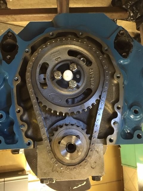

Crank dot at 12 oclock and cam dot at 6 oclock is #6 tdc compression. Crank dot at 12 oclock and cam dot at 12 oclock is #1 tdc compression. Install the distributor accordingly.

With the marks lined up like this picture, the distributor would be installed with the rotor pointing at #6. If the crankshaft is rotated 1 full turn, the cam gear dot will then be at 12 oclock and the rotor would then point at #1.

Thank you. I think I aligned the "O" to be at #6 at TDC. Because I did have the crack "O" at 12 o clock and the cam "O" at 6. o clock. So now the question, can I start the firing order at the #6 position or re position everything.
