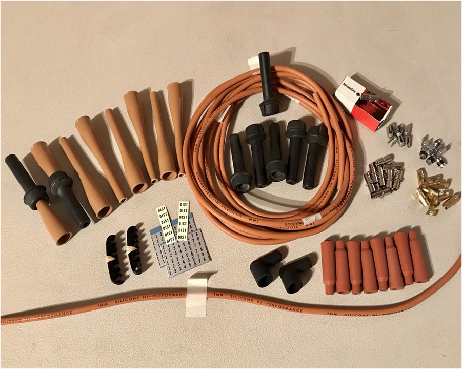

I remember running the old solid core wires back in the day, and once I got caught at a light side by side with the police, he pulled me over and wrote me for everything, as my header mufflers were pretty blown out, and he got instant static from my ignition system on his radio, especially when I tried to pull away gently from the light. He waited so he could drop in behind me and light me up! Those were the old L88 Orange wires.
I seem to recall buying the orange, solid core, Autolite wire back then on a 25 foot spool along with all the components and building a complete set for just about any engine. These were some of the first silicone wires widely available that addressed the issue with normal wires getting baked and then cracking when they were too close to or touched headers.
GUSTO
