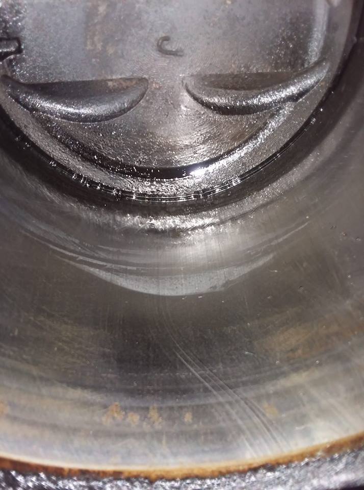

I pulled the heads off my 77 L48 as part of a Vortec head/cam swap. Initially, everything looked OK, no sludge and nice cylinder walls, no scratches, then I noticed this scuff. I can't feel it with my fingertip, and barely notice it with my fingernail. Is this a problem? I really didn't want to pull the block unless I have to...

Looks to me like it's a spot where the piston sat for a period of time, and collected abit of water and lightly rusted. The scuff area is where the rings have rubbed the rust off.
Put your vortecs on and enjoy your car....nothing to worry about

That makes sense, it's been sitting since at least September. Thanks for the advice!
