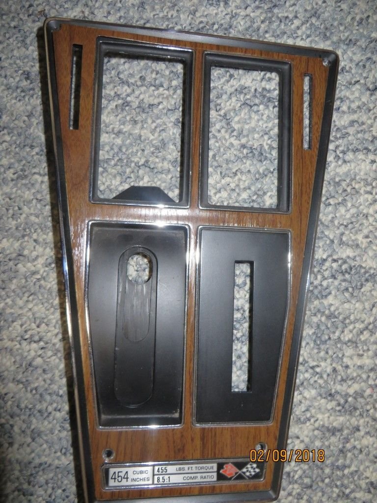

That plastic has quite a curve on it and should be aimed to slip under the controller.
Sometimes people try to install the two sliders in the wrong order, the wider one goes on top while the narrow one goes underneath.
A picture of what you've got happening might help
I don't recall the heater control hitting any wires, if it's holding the front up though that would drop the rear down and possibly explain why your sliders are touching....

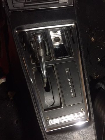

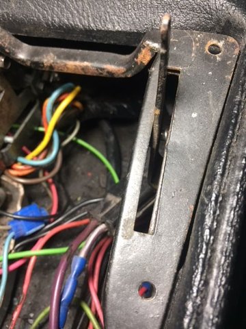

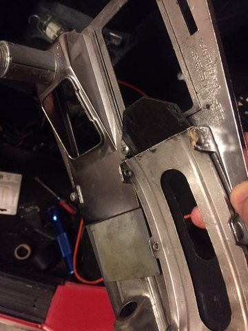

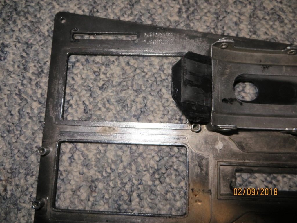

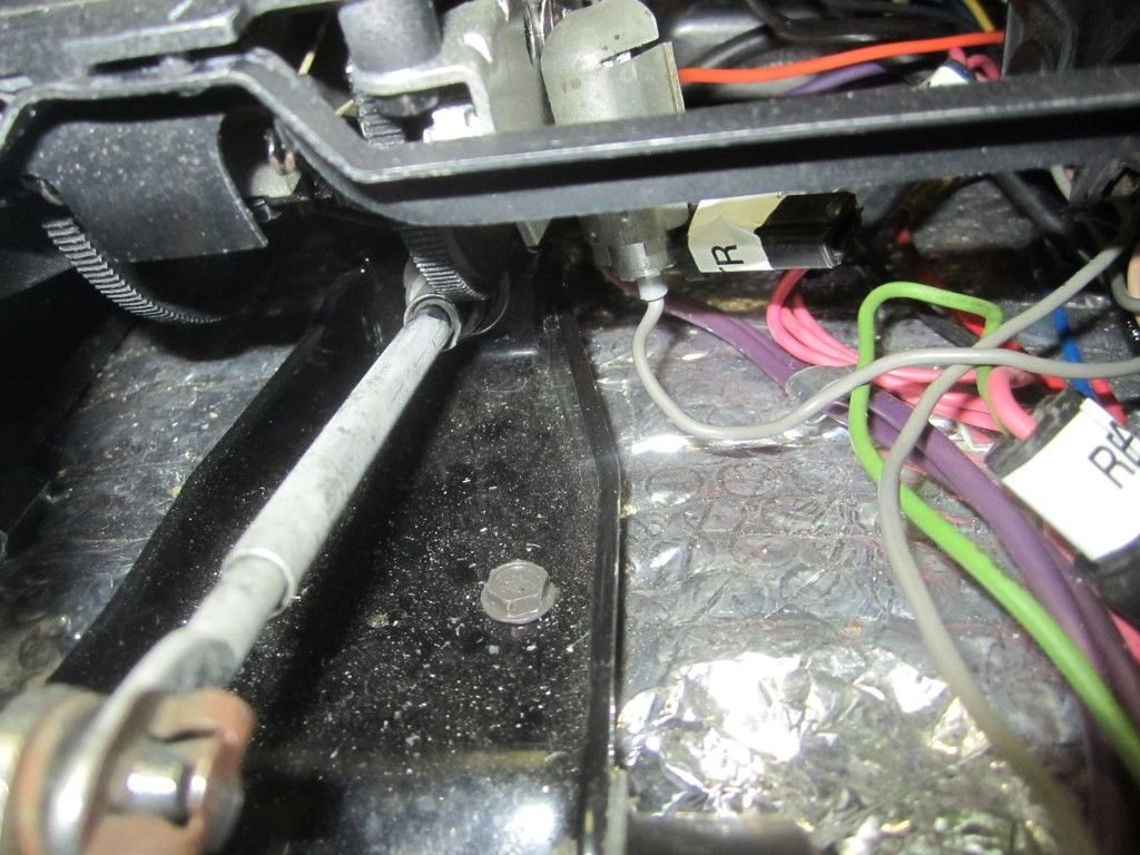

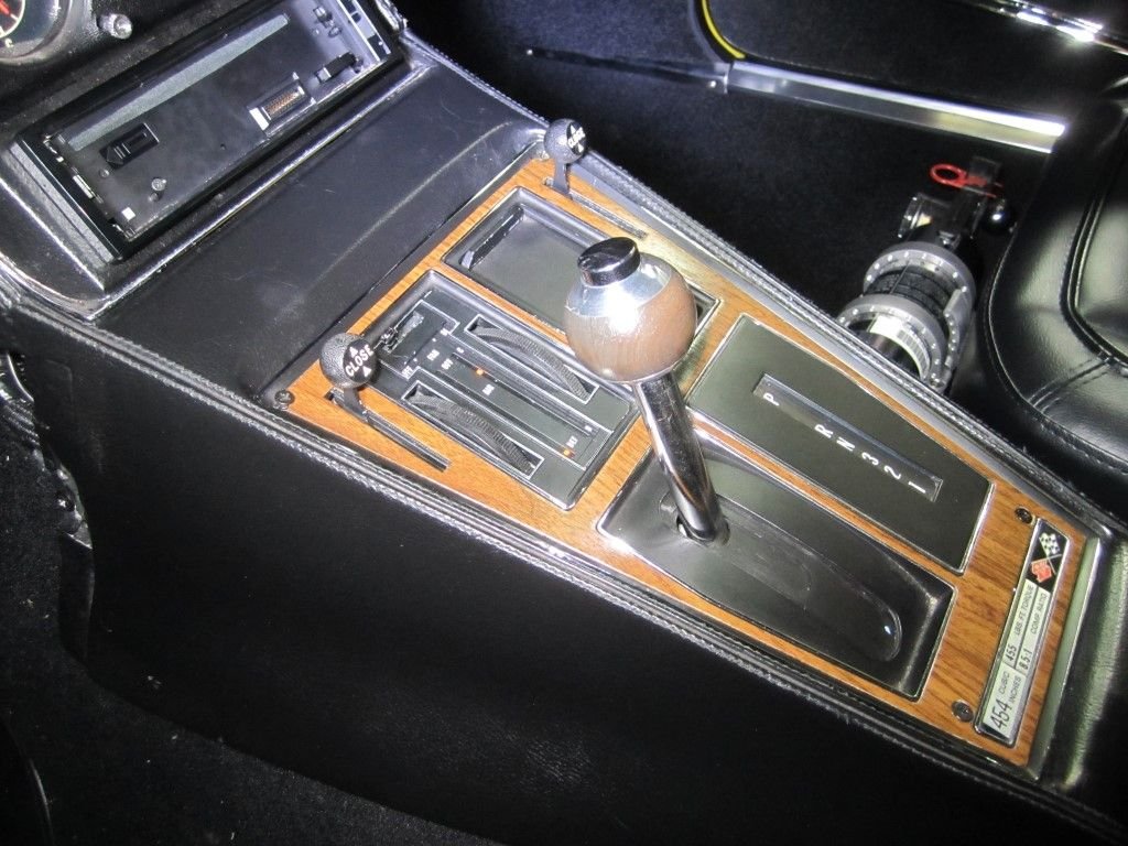

Not sure these will help, but here are some pics of what I'm talking about.
Old Feb 9, 2018 | 10:04 PM
Mooser's Avatar
Mooser
Joined: Apr 2011
Posts: 11,183
Likes: 3,335
Looks pretty close to normal. Do you have the smaller slider strip? If it's not there it may let the larger strip droop down (even though it's in it's own slots) a little.
The thing barely clears the heater so every little bit matters
M

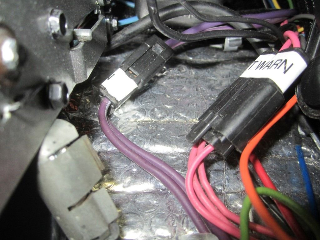

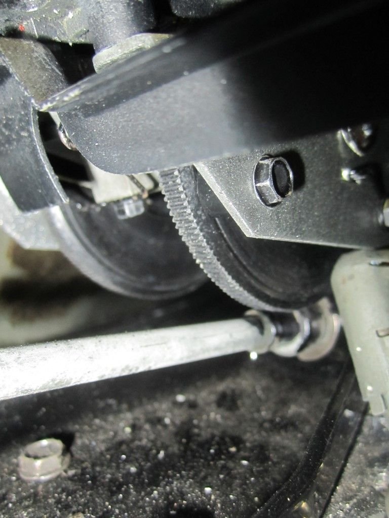

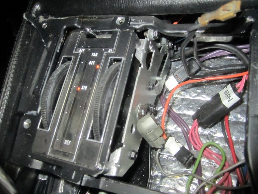

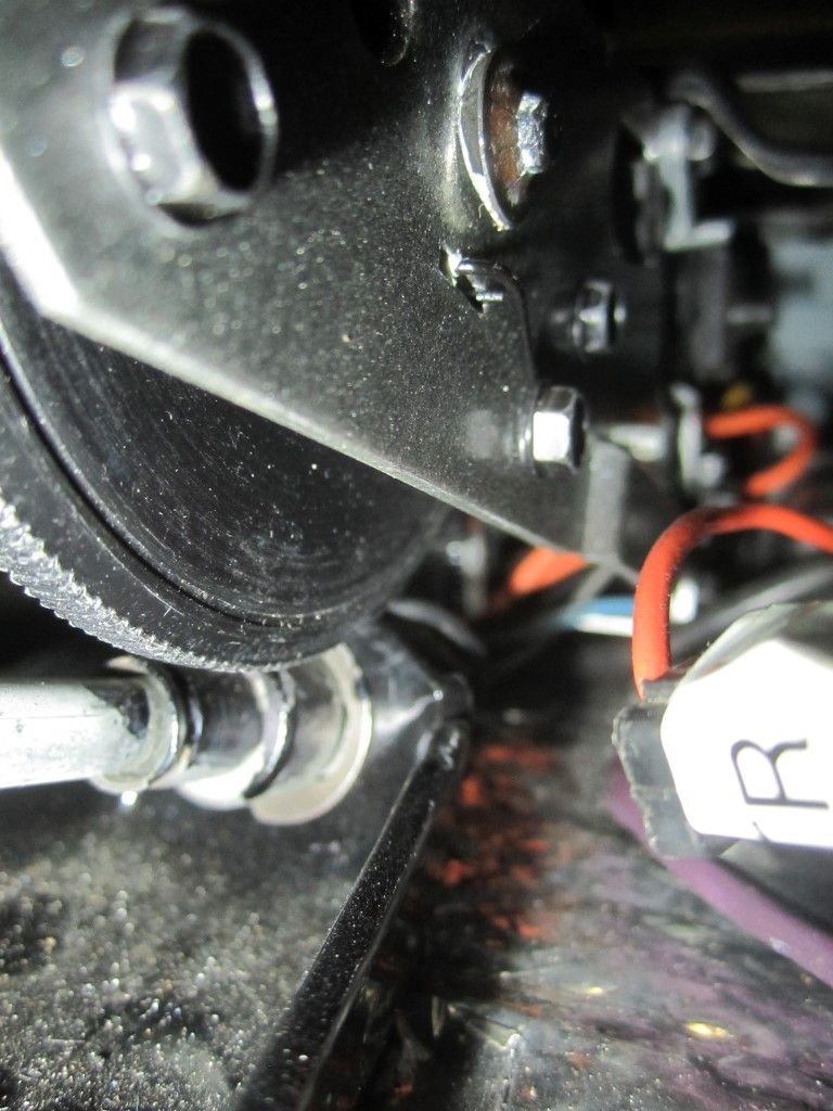

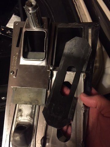

Not sure if it'll help your issue but you'll be wanting that other piece or crap will be falling into that slot forever.
The other thing is that the sliders don't go right up to the end of the slot in the metal plate, they stop about 1/4" or so short
(sorry, best picture I have at this time)
M

Definitely something not sitting right and it's a cluster-f$#k in that area if anything isn't quite right.
I've got mine off so I can see if I can get some better pictures of how everything in there should sit for you tomorrow
M
Old Feb 10, 2018 | 02:00 PM
Mooser's Avatar
Mooser
Joined: Apr 2011
Posts: 11,183
Likes: 3,335

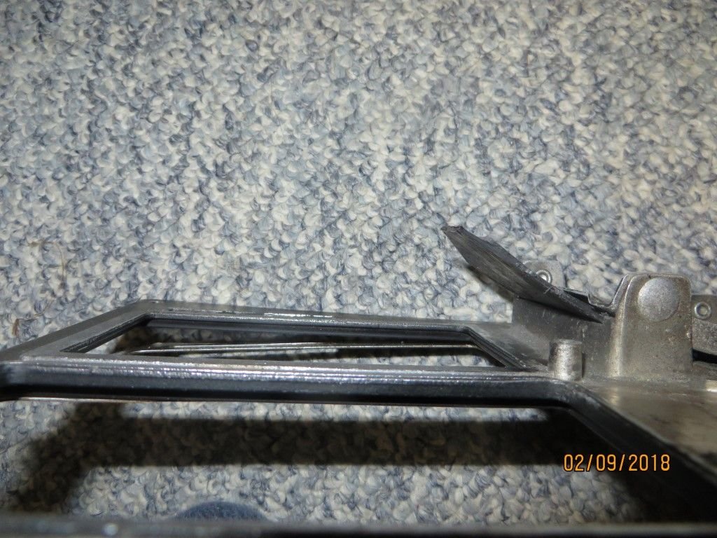

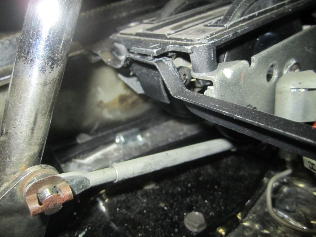

Not sure if any of these help but maybe you can see something from them
M

Frequently the center gauge cluster/dash pad has sagged down and that will push the shifter console back.
Check the fit of your parking brake console and that will help gauge where the shift console is sitting fore/aft
M

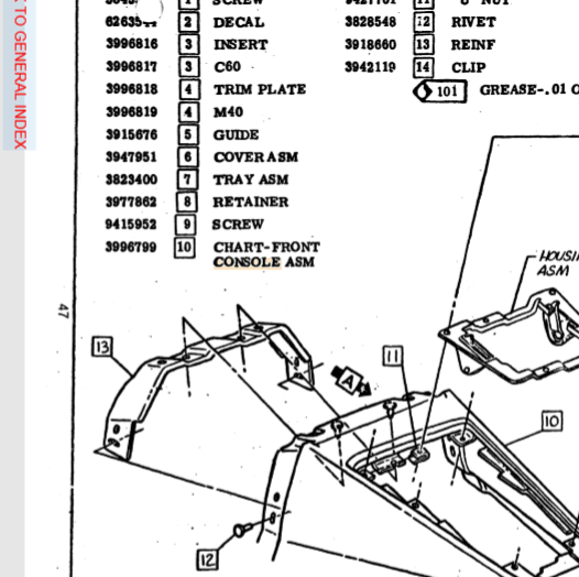

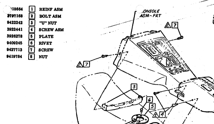

Possibly my last question...

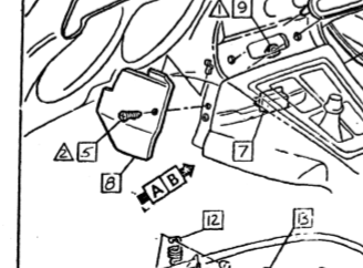

The center console has 2 holes in the front, the trim panel screws into the top hole I believe, does the bottom hole screw into the bracket in the support on the tunnel? I have the assembly manual and it's not terribly clear. It shows a rivet holding the support bracket inside the center console, but doesn't look like the screw holding the trim piece on would go through both into the bracket on the tunnel.
Old Feb 11, 2018 | 06:53 PM
Mooser's Avatar
Mooser
Joined: Apr 2011
Posts: 11,183
Likes: 3,335
Yes, I believe you are reading it correctly
The screw in the lower hole of the tin bracket / console holds the main console to the bracket on the tunnel and then the side filler panel screw goes through the upper hole in the console and into the tin bracket and has nothing to do with the part on the tunnel
The console should be solid without the filler panels installed
Remember that some of these holes were drilled on assembly so they might be on weird angles or not perfectly centered etc.
