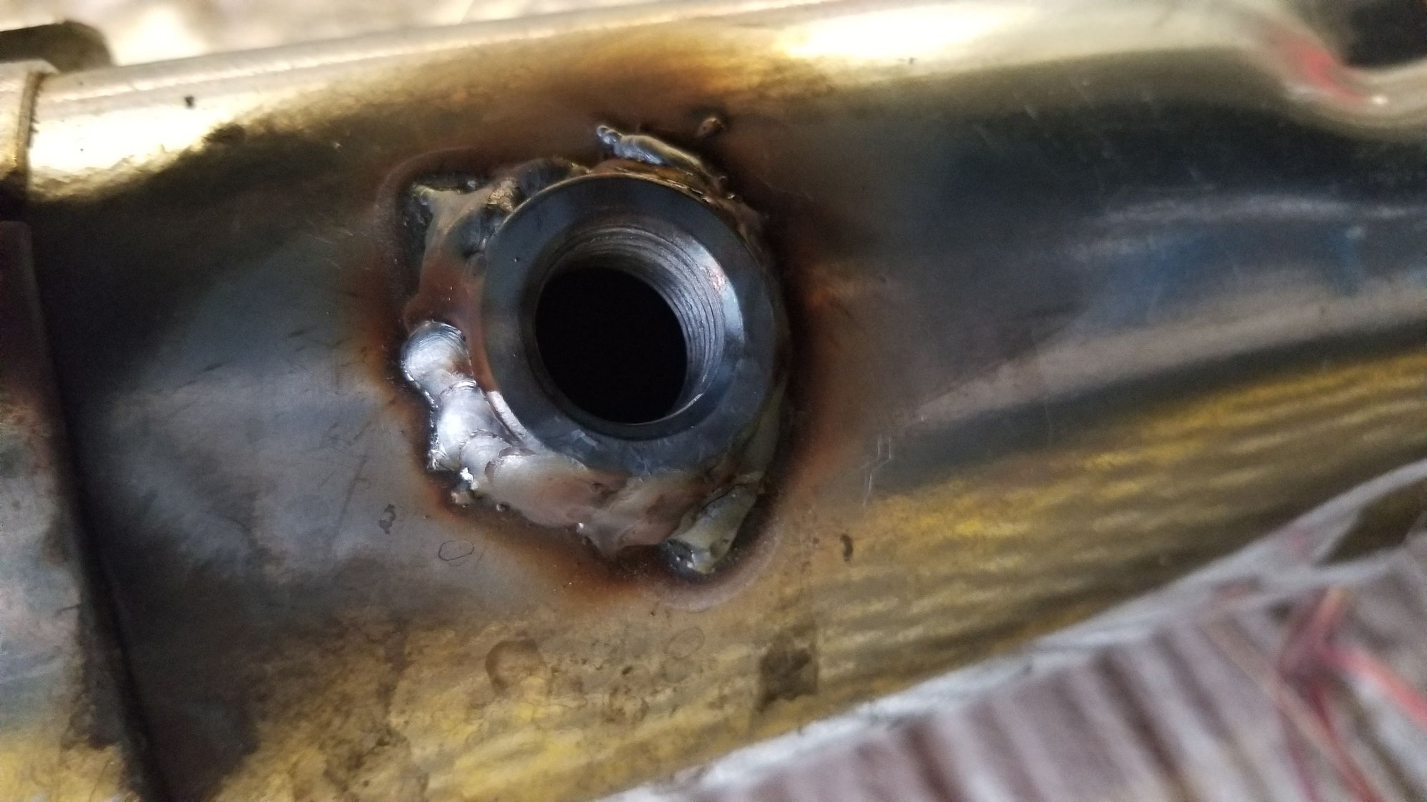

I got my sensor on the collector. you can see where the pipe slid into collector. It's about 4 O'clock since my frame wouldnt allow it to go closer to 3 o'clock . so far it's running great!! but I've had my sniper running for about a week only.

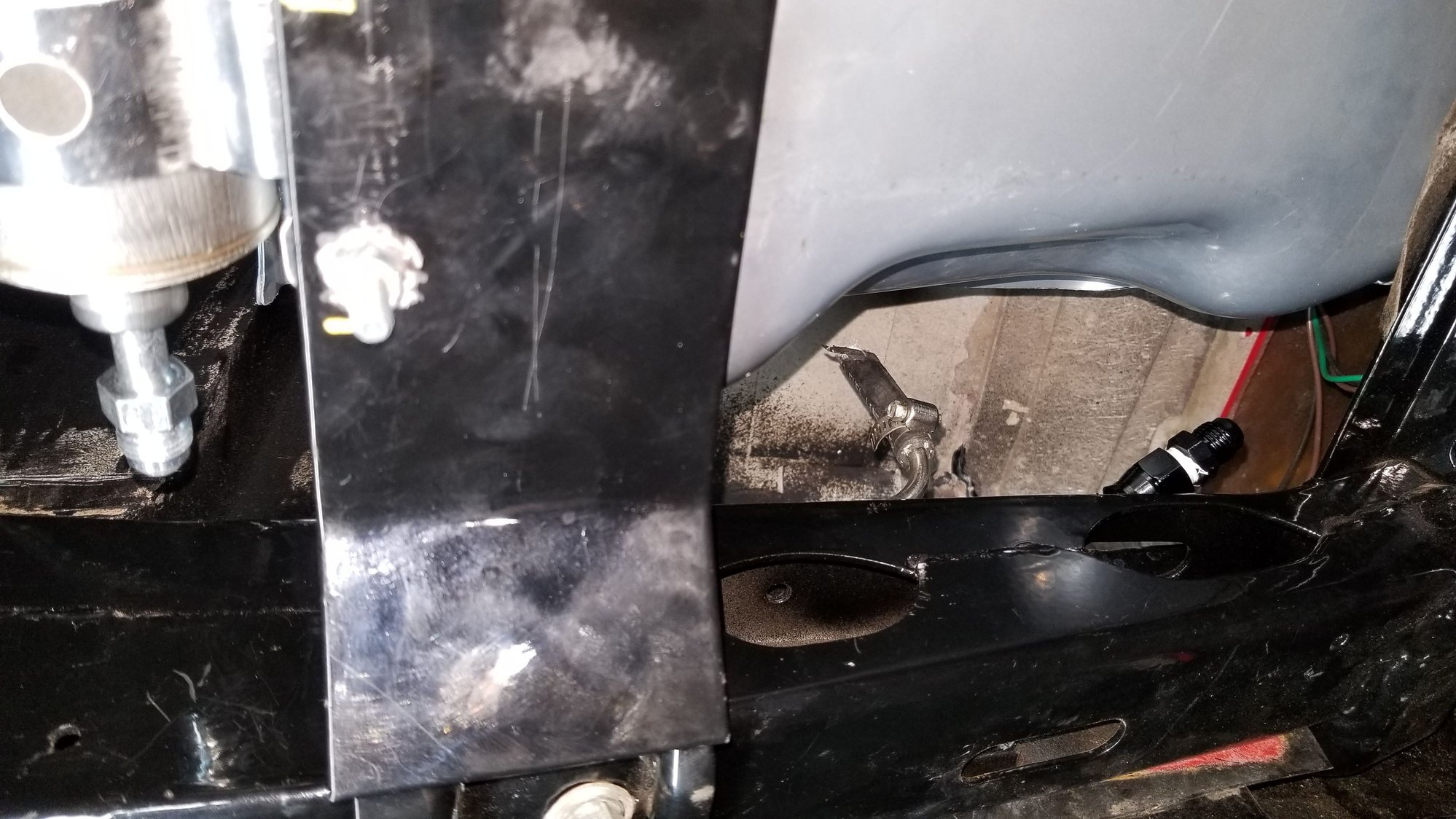

I went with a LS filter regulator at the rear by the tank . That ways I wont need a return line all the way from front. I just capped off regulator at sniper unit.. The tank ,sending unit for gauge and pump came from tanks inc. It's a tank ready for fuel injection
