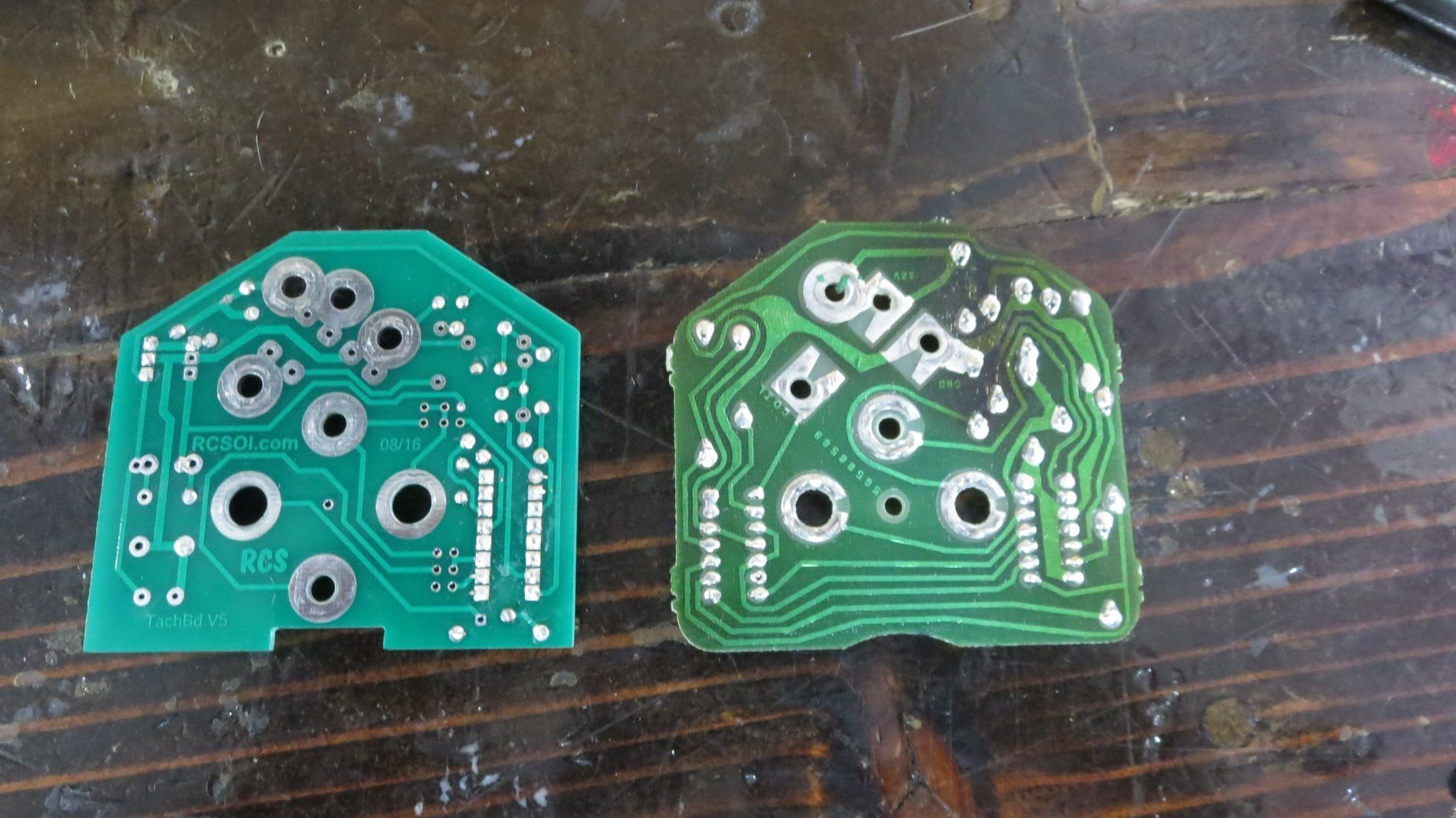

I bought a tachboard from Willcox sometime back for my '79 and finally I had time to day to install it. After zeroing it out I attempted to test it but it was DOA. I put back the old board, and it worked fine. .The reason I am replacing the original board it is because it is running about 25% higher than the actual RPM (when compared to an inductive meter). Hopefully it's just a bad board - but then again I know Willcox takes pride in what he sells. Weird.
Willcox and original boards shown below for reference

Don't look like the same circuits. Components different. Are you sure it is the correct one?
YES...due to improvements in current electrical circuit technology...they are visibly different but that has nothing to do with it. I know it is not working like he wrote...but how it looks is not causing that.
