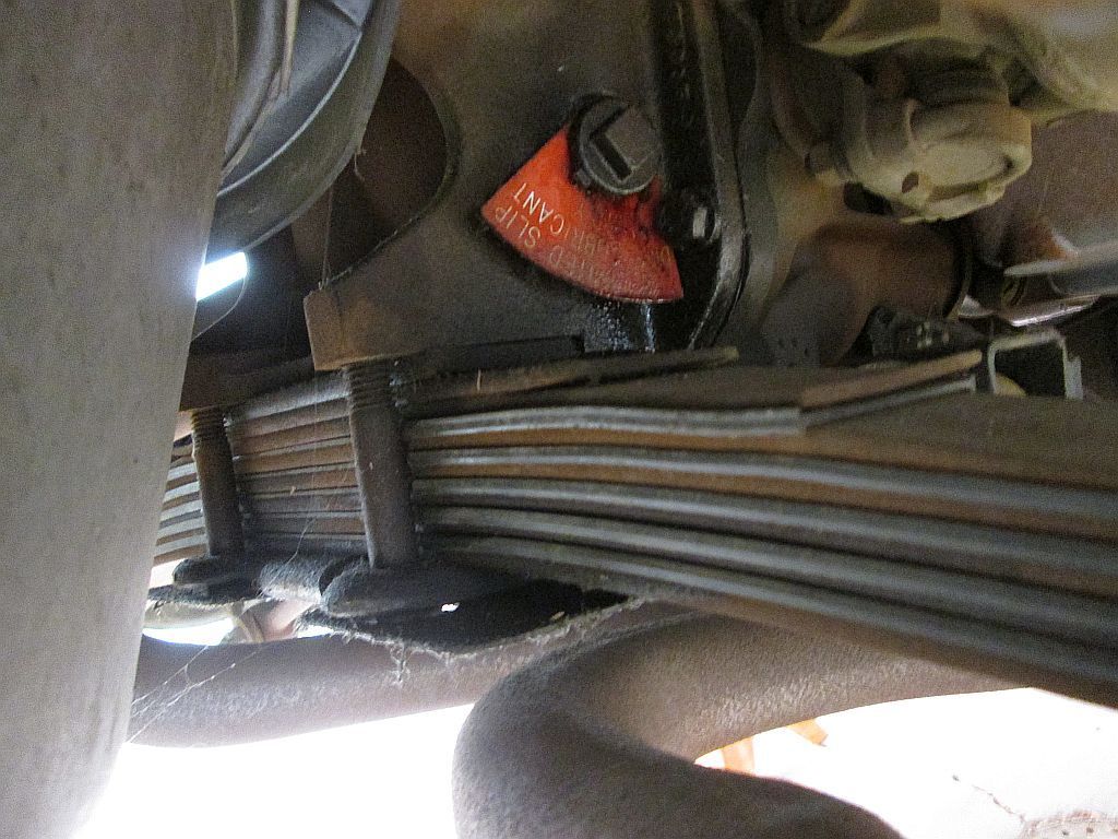

Hi guys!
it's question time again!
Found out I have a 7 leaf spring, wich I believe should be gymkhana, right? ( rustkhana, I know. Car has lived in canada..poor thing. They haven't invented waxoil over there apperantly ( no offence))
Anyway. It looks like it has like a small spacer kinda thing on top of the springs. Could that be removed to lower the car a tad? I'm all for standard ride height, but with the weight I've removed of the car it sits a tad too high for me.
I could google for a few days, or I could try asking directly here : The front springs a have had a green tag, 346939 was the number. Wich seems to be standard SBC springs.
Also gt the smallest of the front sway bars, measuring around 22mm. What coil spring rate should I use? I'd like the front to sit a tad lower, it's only a weekend car ( once its restored) so ride stiffness isn't too important for me, I'd like it to be a bit sporty.
I also removed quite a bit of weight from the front, the AC and power steering are removed. Wich makes the front sit a bit higher too. Could cut springs, but something readymade is always fun
I plan to upgrade to the KYB G GAS shocks too, unless someone absolutely HATES them?
Slowly rebuilding the car. Gas tank changed a bit. recieved some shiny shorty headers as well

I'll try to help where I can: Yes, the FE7 Gymkhana leaf spring was a 7 leaf unit. This is the original spring on my 17K mile 1976 equipped with FE7 Suspension.
As for lowering the ride height in the rear, you can use longer bolts between the springs and control arms. There are bolts specially designed for just this purpose.

You can remove the spacer on top of the spring stack. It's only purpose was to make the 7 leaf spring stack thickness equal the standard 9 leaf spring thickness thus more or less equalizing the ride heights. You won't get much lowering of the ride height though and you'll probably have to change to shorter bolt lengths, at least 2 of the 4.

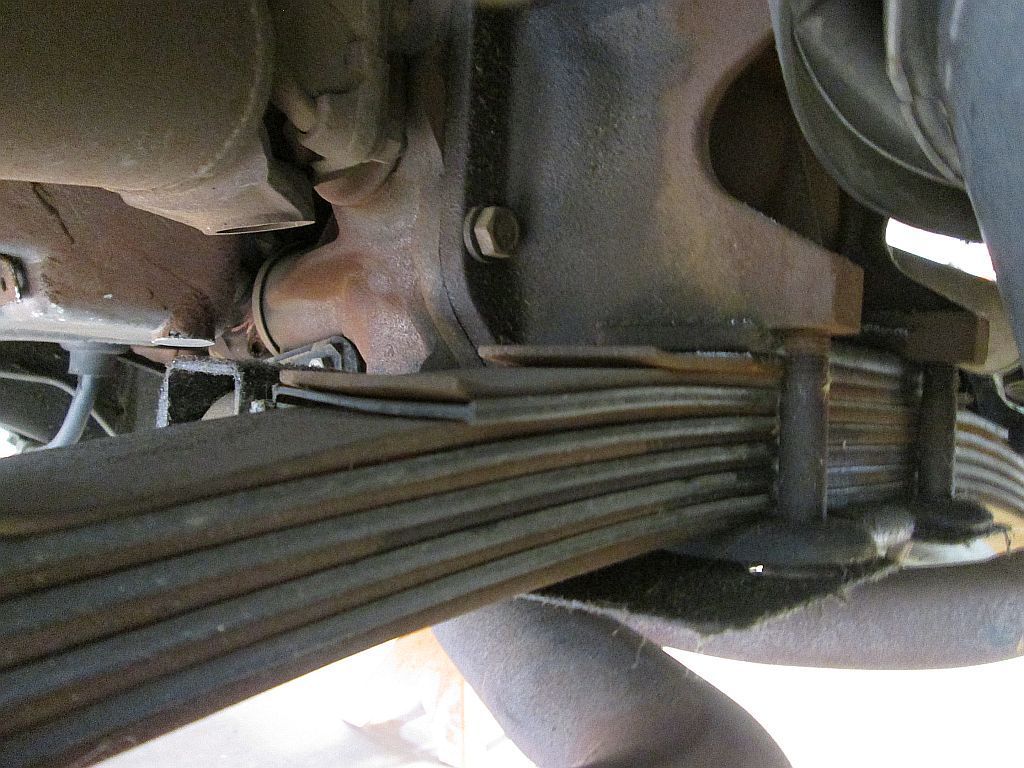

Do you have 8 plates on the leaf, small top plate ? Like this ?

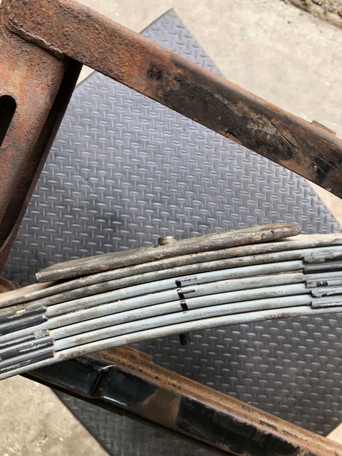

Sorry to bump this up again, is it possible to identify it as a Gymkhana spring? Just want to rule out the possibility of it being a 9 leaf spring with 2 springs removed
It's on the bench now, didn't see any markings orso.

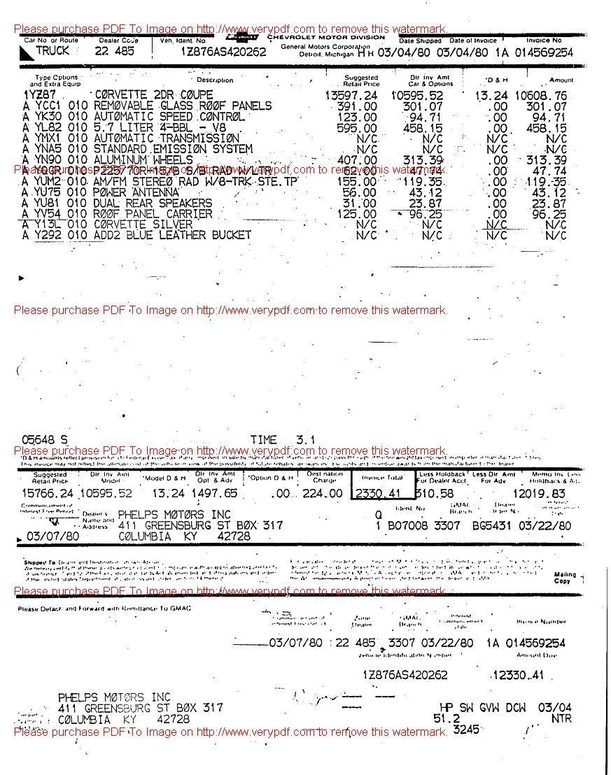

Go here: http://www.gmmediaarchive.com/?page=ordform and request a copy of the original dealer invoice for your 79. The invoice will show all the options installed on the car and the name of the original dealer.
Here's a sample of the invoice for my 80:
It's really one of those 'nice' things to have when you go to a show Then put it in the car in a frame ( atleast thats what I plan to do )
I've contacted them about a week ago, but being Belgian it'll take a while to arrive

Do you have a rear stabilizer bar?
Only gymkhana equipped had the rear bar from the factory.

Nope. Front bar is the small dia as well, and soft springs. So the 7 Leaf is probably a later addition, or someone took 2 leafs out..

Been thinking about it today, if it was a 9 leaf with 2 leafs ( leaves?) removed, it would probably be wayyyyyyyy too soft too?
