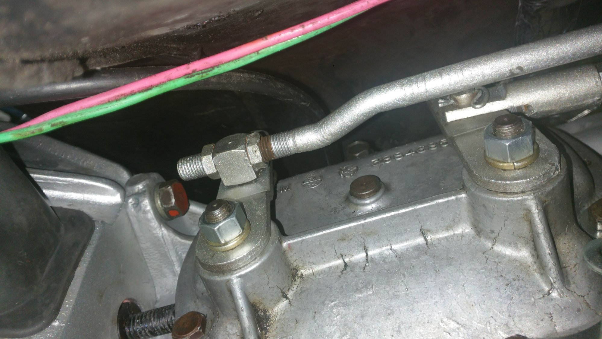

I finally had a chance to get the shifter assembly "How to" together
https://www.corvetteforum.com/forums...d-shifter.html
Heres a pic of the shifter rods installed in the lower holes. The rods were painted before adjusting from the upper hole to the lower close ratio holes
