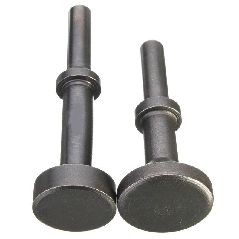

Dub, that sounds like a good idea. I weld up something to hold the socket but what kind of bit do you use in the air hammer?
Old Feb 26, 2018 | 06:10 PM
DUB's Avatar
DUB
Joined: Apr 2009
Posts: 19,294
Likes: 2,754
From: Charlotte NC
Similar to these.
DUB

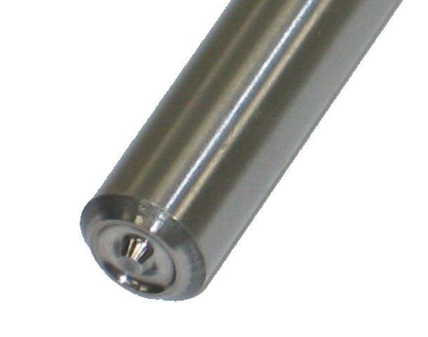

IF the shaft of the roller you are using is a tubular design . Then this is the type of set tool or cinching tool you will need to peen the rivet correctly
