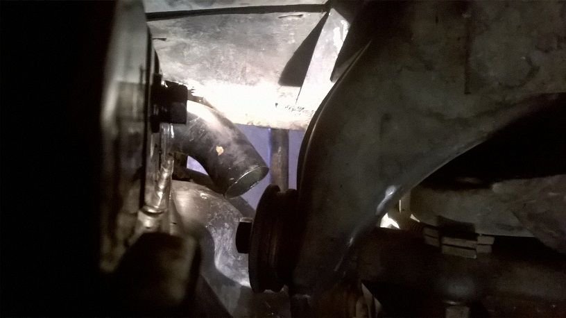

I do not know the manufacturer of the radiator. It is for an automatic transmission. The problem is the lower outlet curves sharp towards the center of the radiator more so than any other photos I can find. There is not much room for the hose to begin with, adding to the problem. I am thinking the AC three pieces will give me some wiggle room. the 1968 427 hose looks more correct, but from what I can tell the 68 core is 22.5 inches and my core is 27.5.

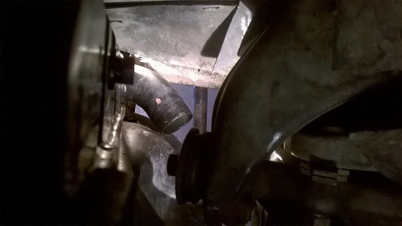

Originally Posted by JPinAZ
Not the best photos but maybe you can get the idea. Lower outlet crosses inward past the header.

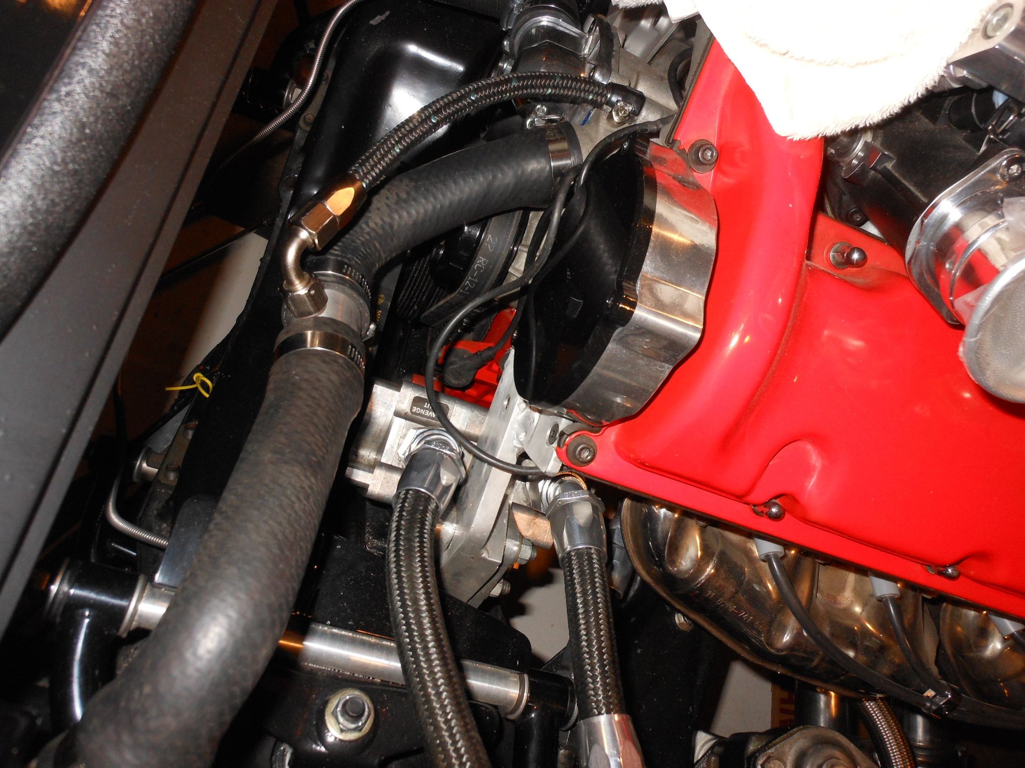

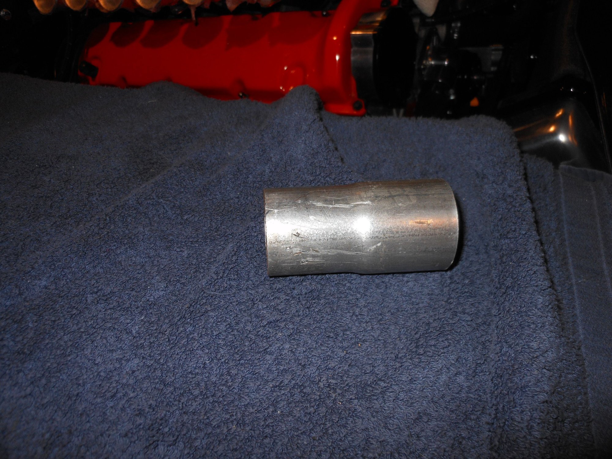

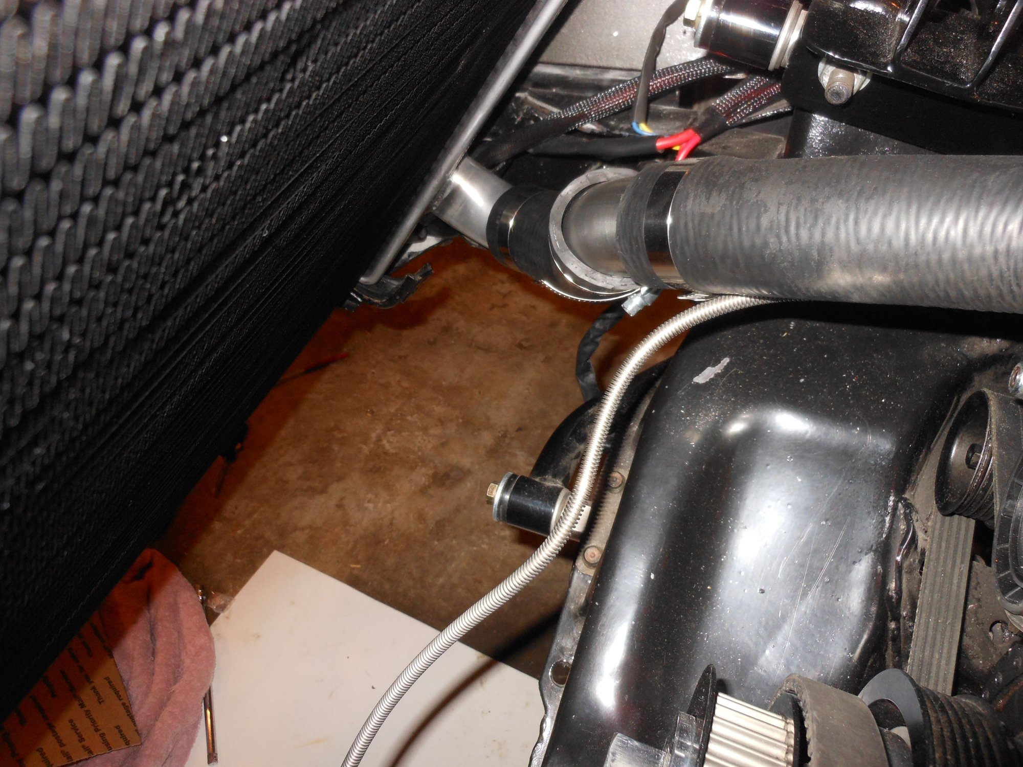

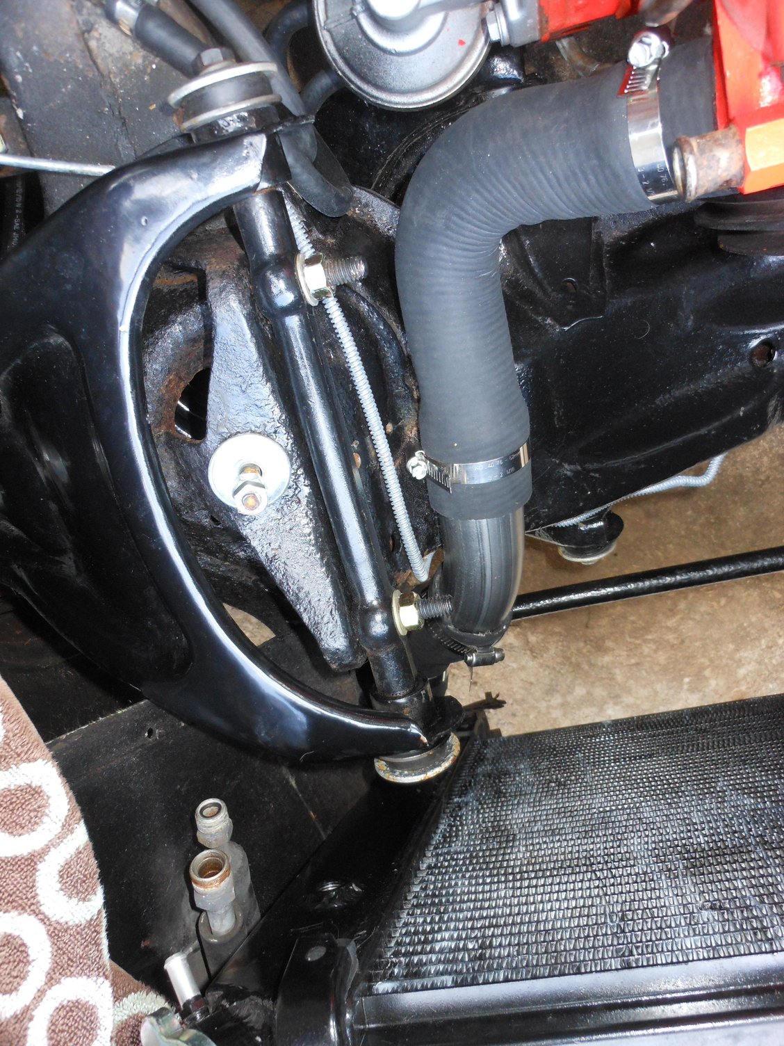

Thanks-
Here's my engine swap- using SS exhaust pipe. It also helps keep the hose from collapsing-
On the top hose - I used aluminum- so I could thread for a steam port hose.
Bottom hose I used 2" SS 45º exhaust pipe bend-
These come in handy to adapt different size hoses- at your local autoparts store for a few bucks.
