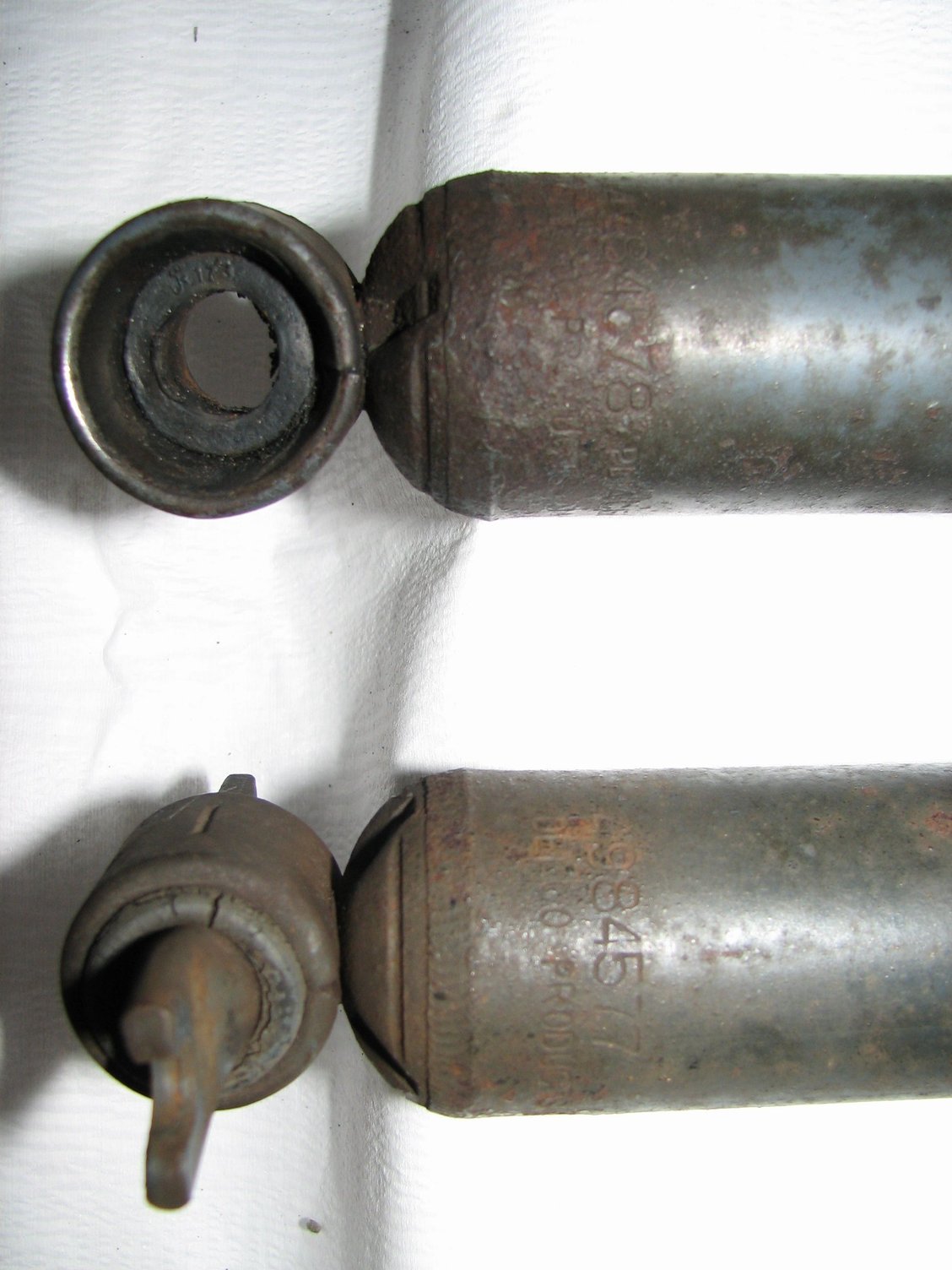

Hi Guys!
I was wondering what the factory front shocks are on the 74 stingray coupe... (what brand, what part number)
I pulled out a pair of Monroe 5906ST, but I'm not they are OEM shocks...
Does anyone know which I should get to keep it original. thanks

Probably the same as were in my '77, or equally unavailable. Delco Products Pliacell PN 4984577, at least the HD ones. Maybe somebody's rebuilding them but you should just install a nice set of Bilsteins and call it good. Paint them blue/grey if you don't like the color.

To answer your question AC Delco front shocks with part number with GM# 4975167. The 4984577s were first used with FE7 Gymkhana suspension in 1975.
