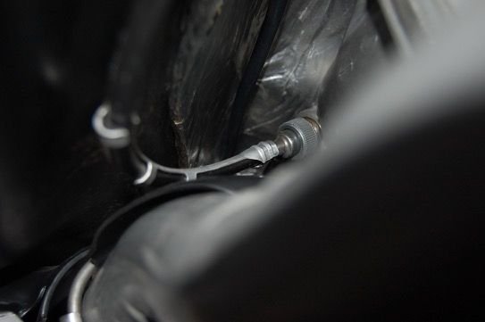

Have you looked to see if the cable is properly connected at the transmission and at the speedometer's case?
Regards,
Alan
Difficult to see and access at the transmission.
